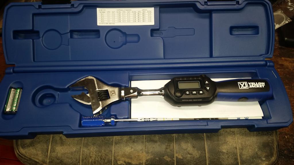

WHX?? 57,047 #8 Posted September 5, 2019 (edited) I've got two older crapman's beam styles and an newer HF click style pos in 1/4 drive that is useless. Only measures up to 200 in lbs and no good for setting head torques or anything else for that matter. Don't know about the accuracy of the Crapman's when they get thrown because you have finally discovered you have the wrong head gasket! If I had Ed's pockets I'd op for the snap offs but till my ship comes in ...I recently got this for that four letter word we all like that starts with a F. Suposed to be for torqueing flare nuts on AC units but will try it out in the horse barn. Ain't figured out how to use it yet as I no read Chinese but we'll see. It's ajustable but ain't quite figured out if it's metric or not! Looks like it has a removable head for putting crows foot wrenches on??? Its got lights and beeper that go off when reaching set values which is kind of handy. Edited September 5, 2019 by WHX24 1 Share this post Link to post Share on other sites

squonk 47,053 #11 Posted September 5, 2019 (edited) I've have had Snap on for 40 years. My 1/2" spin dial clicker can be stored at any setting. Had it checked 10 yrs ago and it's right on. @WHX24 that 1/4 200in lb wrench is mighty handy when setting a timing belt tensioner on a 2.0 Mitsubishi 4 banger at 8 in lb. I bet you didn't have to pay $250 for yours either! Edited September 5, 2019 by squonk 2 Share this post Link to post Share on other sites
