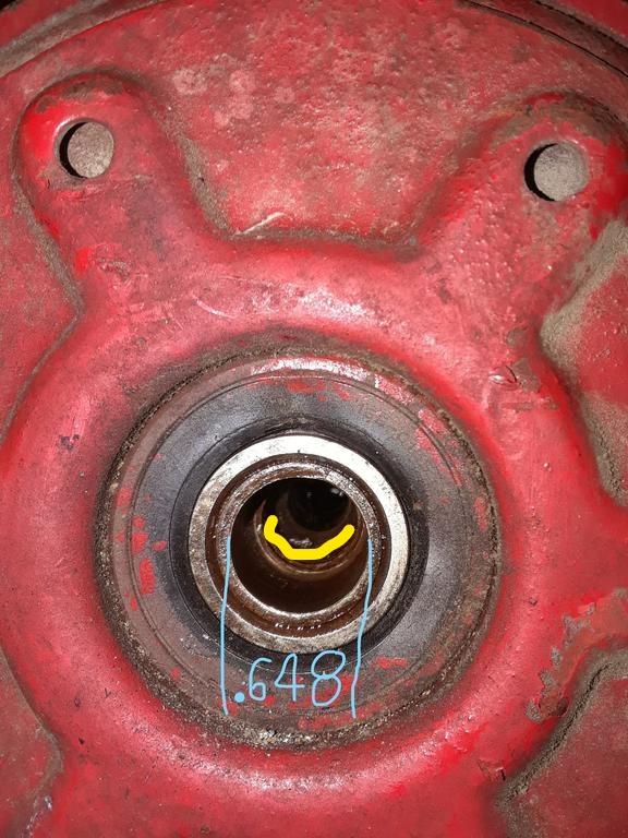

pfrederi 21,095 #7 Posted September 5, 2019 Could you post a picture of the opening in your PTO??? Share this post Link to post Share on other sites

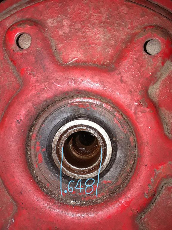

wind77west 14 #8 Posted September 5, 2019 I have attached a picture, as noted the hole is about .648 in dia. and approx .50 deep. Don't know if it could be a threaded sleeve, it is mild steel a file can cut it. Trying to decide what to do next. try to tape it, try an easyout or what. Have you seen this before? Share this post Link to post Share on other sites
pfrederi 21,095 #9 Posted September 5, 2019 (edited) The threads are back there I can see them Get a 5/8" NC bolt 4 inches long should work. it will thread in and pull the PTO off. Under the yellow line. Way back in there Edited September 6, 2019 by pfrederi 1 1 Share this post Link to post Share on other sites
wind77west 14 #10 Posted September 6, 2019 Thank, I will give it a try, it may be a couple of days before i can give you the results. 1 Share this post Link to post Share on other sites
wind77west 14 #11 Posted September 7, 2019 pfrederi Could not wait, tried the bolt although I could not see the threads the bolt found them right away and made the job easy. I now have the both the pto pulley and the drive pulley off. Now I am off searching for a new drive pulley. Thanks again for your help it saved me both time and money. 1 1 Share this post Link to post Share on other sites
