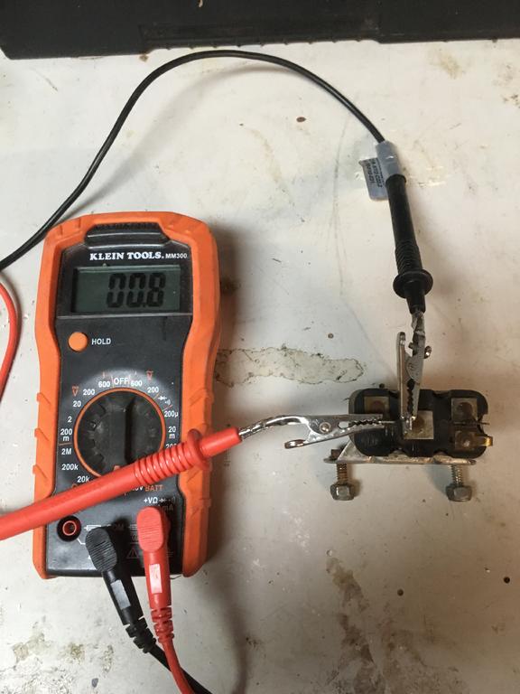

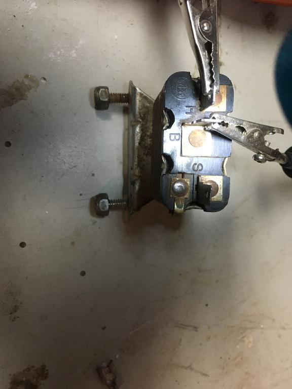

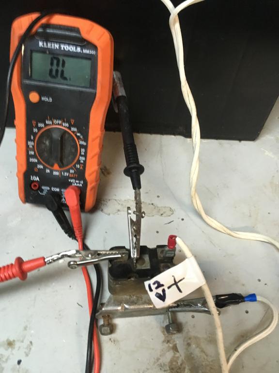

biged77 113 #8 Posted September 4, 2019 Here is some more info that may help. The photos below show oil relay P/N 106833 in the "energized" and "not energized" conditions while measuring resistance between terminals H and B. The relay is open (OL) when energized and closed (0.8 ohms) when not energized. The oil relay has to be closed to allow the start solenoid to actuate. So it looks like the oil level switch has to be NC on top for models that use oil relay 106833 (oil switch open and relay not energized for good oil level). I checked several tractor IPLs and they all use oil relay 106833. I've been wrong before on these electrical issues but if this analysis is correct then several of the detailed wiring diagrams in the Demystification Guide must be wrong. I agree that the oil level switch provides little benefit as long as the oil is checked before each use. Ed 1 Share this post Link to post Share on other sites
