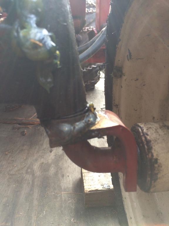

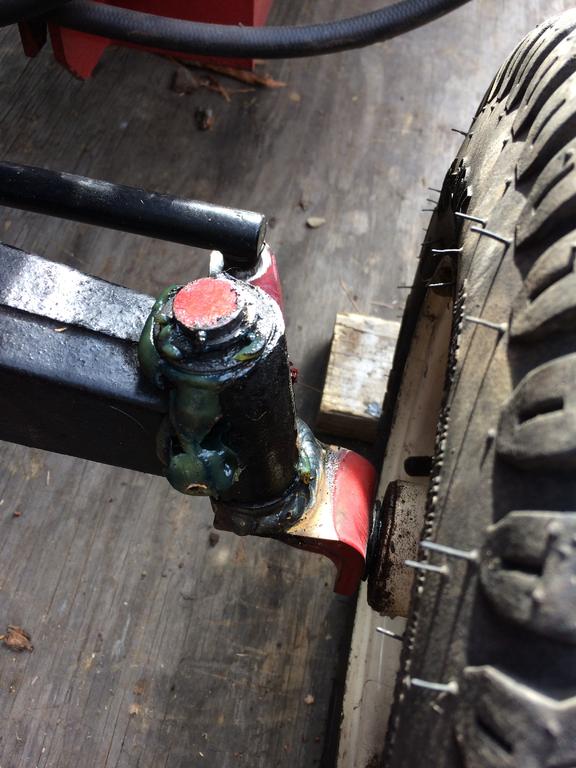

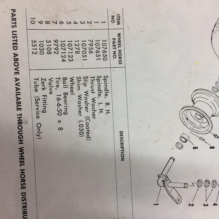

kdropper1322@aol.com 2 #1 Posted September 3, 2019 Hey Guys, Hopefully someone can point me in the right direction. Looking for a specific part for a wheelhorse my uncle owns and can't seem to find anything on it. 97-40fl01-05-004 8335 ark manufacturing company inc sterling, KS. 67579 PO box 327 316-278-3641 C-141 1978 107650 107651 Front spindles for a bucket tractor 1978 C 141 as you can see from the pics tried welding them but they keep bending. Does anyone know of anywhere that makes this specific part? any and all help appreciated. Regards, Nate 1 Share this post Link to post Share on other sites

Pullstart 69,584 #4 Posted September 3, 2019 You’ll have a whole lot better chance with the 1” rod than 3/4” rod... if you happen to bend a 1” axle I’d ask what you’re loading and how much at a time? 1 1 Share this post Link to post Share on other sites

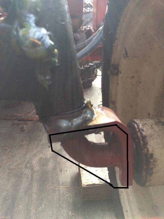

wallfish 19,691 #5 Posted September 3, 2019 A 520 front axle with 1 inch spindles is your best bet. A swept forward 520 axle along with the reduction steering even better. Once those spindles get bent the metal fatigue makes them weaker, You can weld on gussets to both sides of the bend support. Another option is order 1 inch spindles and weld up your own spindles and use 1 inch trailer hubs but you will need new rims as well. 2 1 Share this post Link to post Share on other sites
