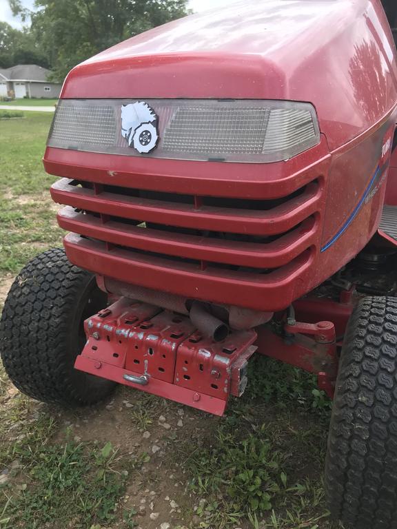

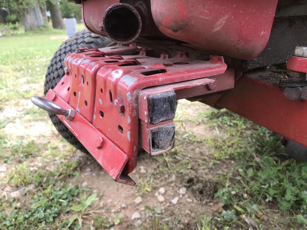

No longer lost 5 #13 Posted September 4, 2019 Thanks for the warm welcome, guys. Glad to see other 'sconnies here. I live in the Appleton area. I know the 79263 snowthrower is the right model for the 268H. I found a guy in IL who has one and will deliver for a good price. I need a few more photos from him, but it looks all there. One question I do have though is, what do you think is going on with the front of my tractor. Is that a home-made bumper of sorts? I'm guessing I need to replace that with an Attach-a-matic reciver, correct? 1 Share this post Link to post Share on other sites
ebinmaine 80,449 #14 Posted September 4, 2019 I'd agree that there's something home made going there but I'm not sure what needs to be changed. A word of unsolicited advice and caution. Your Lawn tractor has more than enough power to run a snowblower but is physically lighter than some of the larger Garden tractors. Weight and traction are HUGE concerns for winter work. If you're going to purchase a snowblower AND pay for it be delivered it may be financially feasible for you to find another tractor nearer to you. The cost of the snowblower will occur either way so that's a moot point. The cost of the freight (and whatever else you need for your 268h) may equal the cost of a second tractor if shopped carefully. Keep the 268h as a mower and (other) as a snowblower. Also, the Garden tractors have many more implements available should you desire other tools. 2 Share this post Link to post Share on other sites
WVHillbilly520H 10,379 #15 Posted September 4, 2019 7 hours ago, No longer lost said: Thanks for the warm welcome, guys. Glad to see other 'sconnies here. I live in the Appleton area. I know the 79263 snowthrower is the right model for the 268H. I found a guy in IL who has one and will deliver for a good price. I need a few more photos from him, but it looks all there. One question I do have though is, what do you think is going on with the front of my tractor. Is that a home-made bumper of sorts? I'm guessing I need to replace that with an Attach-a-matic reciver, correct? Yep homemade and you'll need a front attach-a-matic... 1 Share this post Link to post Share on other sites
WHX?? 57,879 #16 Posted September 4, 2019 (edited) I don't know if those need one or not Jeff... I think the attachments are a whole different animal for the verts. I looked into one once for my 246H but quickly came to my senses and scored a 520 for sno duty... now just to get that deuce finished! EB's got a valid point Lost. By the time you get weights, chains etc. for it you may have bought another tractor. There is a nice C-101 on CL in Greenville for sale I been eyeballing. On the other hand you have a small driveway yours might be ok. One of the reasonings for many of us here to justify our addiction and ammo for our wives is a tractor for every season and attachment! Edit: No you are right Billy he will need a front attach... Here are the manuals for that blower Lost. Yes you will have to lose Grampa's home made front end. Edited September 4, 2019 by WHX24 Share this post Link to post Share on other sites
WVHillbilly520H 10,379 #17 Posted September 4, 2019 6 hours ago, WHX24 said: I don't know if those need one or not Jeff... I think the attachments are a whole different animal for the verts. Edit: No you are right Billy he will need a front attach... Here are the manuals for that blower Lost. Yes you will have to lose Grampa's home made front end. Jim, Are you doubting my knowledge of the newer TORO versions of . . 1 Share this post Link to post Share on other sites
