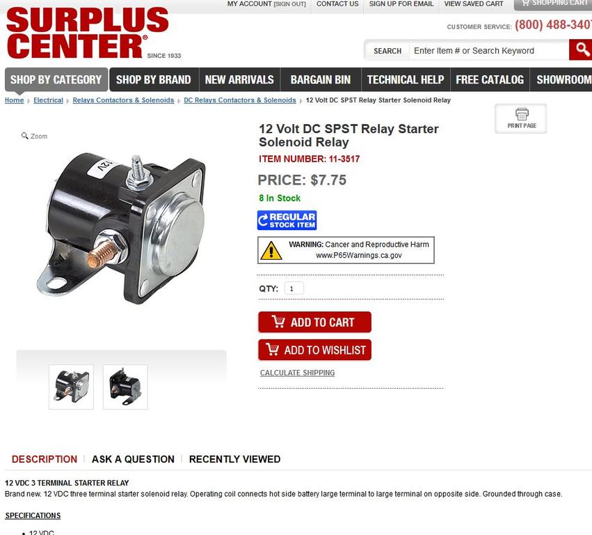

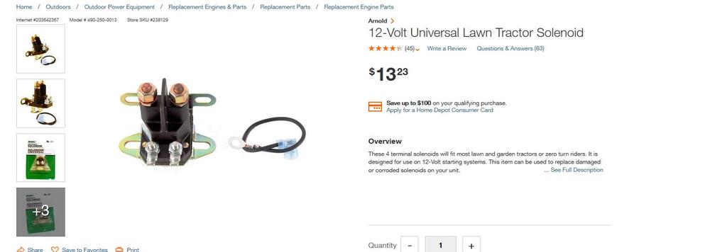

pfrederi 20,066 #5 Posted September 1, 2019 (edited) They also can be purchased at Lowe's Home depot for small $$ or even cheaper Surplus center I have used a couple of these work just fine Edited September 1, 2019 by pfrederi 1 Share this post Link to post Share on other sites
