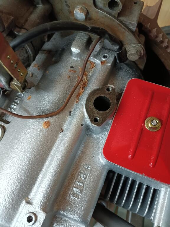

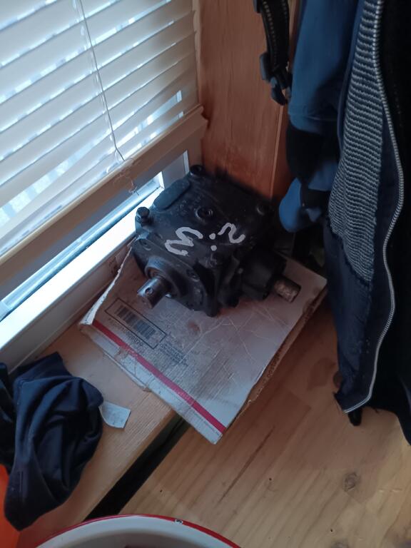

ebinmaine 80,975 #1931 Posted January 10, 2025 @stevasaurus I made it so you could somehow justify your earlier reading of this lengthy excursion into blabberin-osity. As mentioned in other threads I've been carefully moving parts tools accessories etc about the buildings so as to group things together whenever I find group-able things. This here 90⁰ gear box has been patiently setting in the kitchen window for a year or three. I decided to pick and set to a more group friendly place. In other news.......... It looks like I've got some rodent killin' to do..... 🤬🤬🤬🤬🤬 1 3 Share this post Link to post Share on other sites

19richie66 17,937 #1940 Posted January 12, 2025 On 1/10/2025 at 4:35 PM, ebinmaine said: In other news.......... It looks like I've got some rodent killin' to do..... 🤬🤬🤬🤬🤬 Tape over all those holes with some aluminum HVAC duct tape. Keep them out. 1 Share this post Link to post Share on other sites
ebinmaine 80,975 #1941 Posted January 12, 2025 1 minute ago, 19richie66 said: Tape over all those holes with some aluminum HVAC duct tape. Keep them out. Good suggestion. I'll pick some up. Unfortunately I'll have to split the engine again anyway to verify if there's a 🐁 condo down inside the block. 1 Share this post Link to post Share on other sites

Oldskool 6,678 #1943 Posted January 13, 2025 So the 90° gear box that has been sitting on your window sill for a year or three. This box, do you remember what you were going to do with it? 1 Share this post Link to post Share on other sites
ebinmaine 80,975 #1944 Posted January 13, 2025 5 hours ago, Oldskool said: So the 90° gear box that has been sitting on your window sill for a year or three. This box, do you remember what you were going to do with it? That's a valid question. If one was to take a few hours and scroll back through all 78 of these pages there would be a discussion about static and dynamic weights and where I wanted to position the engine. I really wanted to have the engine facing the same way as most of the Wheelhorses so that the drive pulley would be off of the right hand side. This engine is just so big and so heavy that there's no way to do it without having the weight center way off to the left hand side even at level flat hard ground. Any sort of a tilt to the left and that effect would get magnified very quickly. That wouldn't matter to a lot of people but to me. It does. As a trained crane operator, Dynamic loading is something that I understand all too well and I don't want to deal with it on tilted ground with this tractor. Because of all that I'm going to have the engine facing fore and aft instead of sideways. This gearbox will be used to transfer the direction of pulley rotation. 1 Share this post Link to post Share on other sites

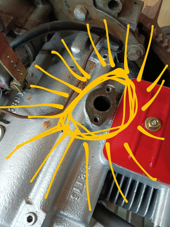

ebinmaine 80,975 #1947 Posted January 13, 2025 Mouse 🐁 & engine question. This here hole: Is definitely large enough to allow mouse 🐁 passage. Would it be worth buying a cheap "camera on a stick" type scope to peer down in there? Or should I just split the engine anyway? Share this post Link to post Share on other sites
Oldskool 6,678 #1948 Posted January 13, 2025 Which hole it that? Share this post Link to post Share on other sites
Oldskool 6,678 #1949 Posted January 13, 2025 That must be Colossus' heart transplant? If it was mine I would pull the plugs. Force compressed air into both cylinders at the sametime thru the plug hole. A couple good shots. Then constantly blow while rotating the engine by hand a few complete revolutions. That should clear it out. Share this post Link to post Share on other sites

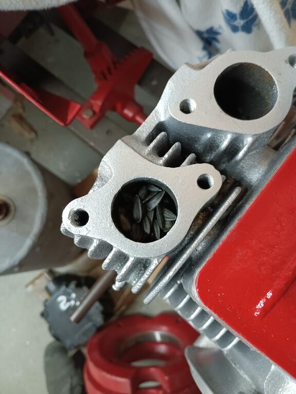

ebinmaine 80,975 #1950 Posted January 13, 2025 9 minutes ago, Oldskool said: Which hole it that? I don't actually remember what goes there. 1 minute ago, Oldskool said: That must be Colossus' heart transplant? If it was mine I would pull the plugs. Force compressed air into both cylinders at the sametime thru the plug hole. A couple good shots. Then constantly blow while rotating the engine by hand a few complete revolutions. That should clear it out. The cylinder heads aren't even on yet. The valve hole being full of seeds isn't a huge concern because I can vacuum that. The smaller hole above..... ?? It goes to the crank case. Breather maybe?? Share this post Link to post Share on other sites
