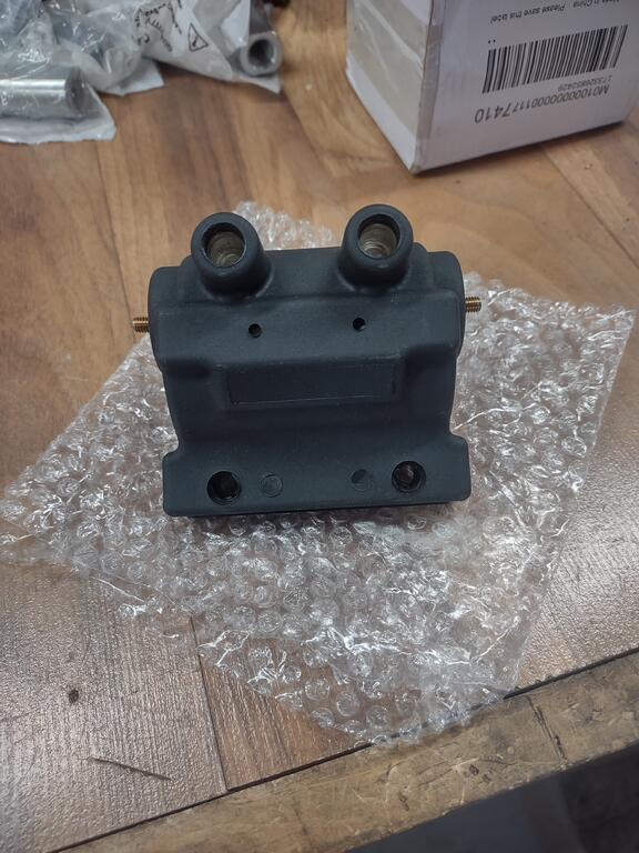

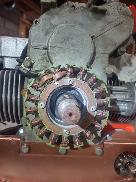

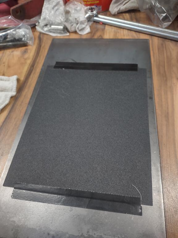

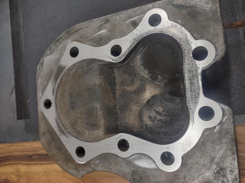

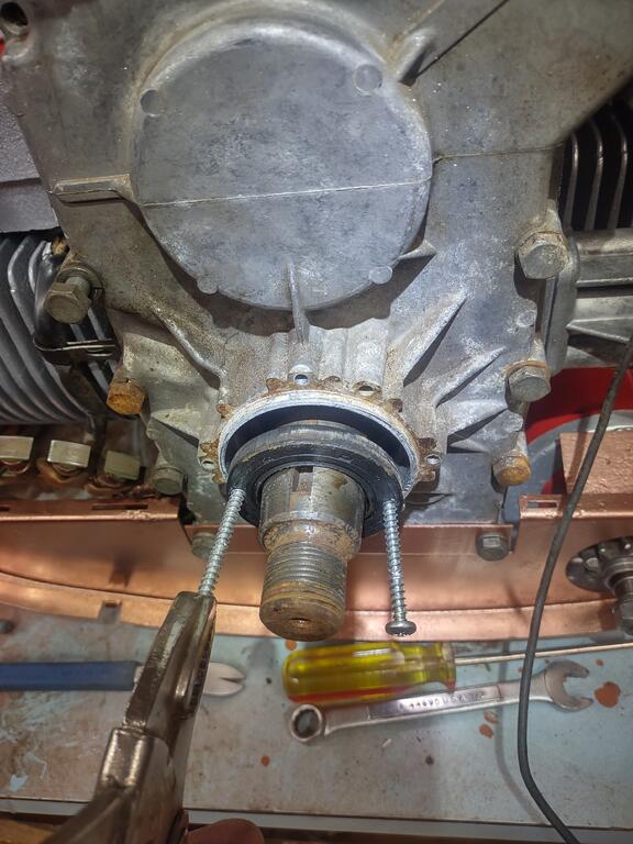

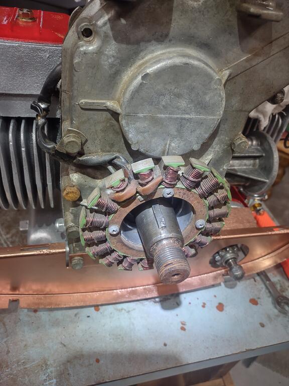

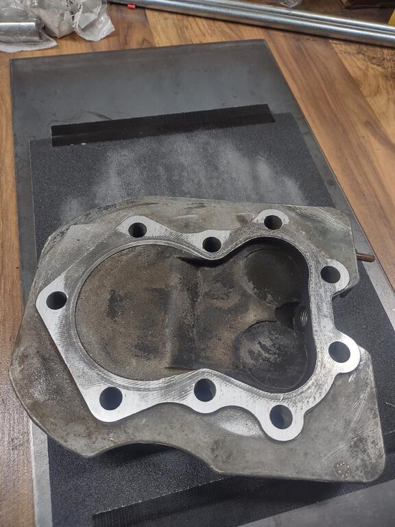

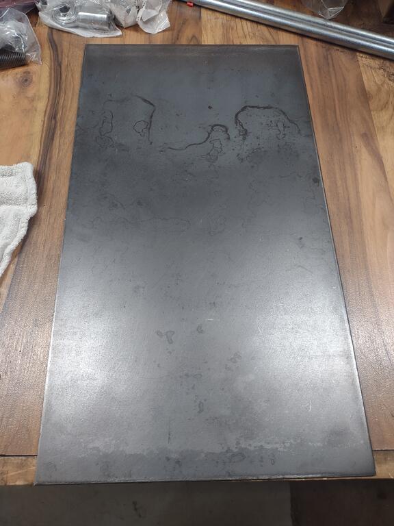

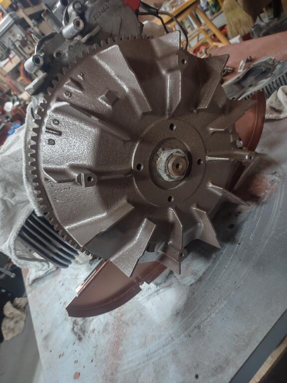

ebinmaine 80,714 #1646 Posted February 21, 2022 Today's progress... Got a couple coils in the mail that can be used on this or other Kohler twins. I popped the alternator off and used 2 sheet metal screws to pry out the old crank seal. New seal in place. Flywheel on and torqued. Time to hand sand/plane the cylinder heads. Found a nice flat piece of steel. Taped 120 grit to it. I go about 60 or 80 strokes in a direction, turn 90⁰. Repeat. This is after a couple or three rounds. You can see the shiny spots where the paper is starting to cut in. This is after going roundy round for a bit. Still a bit to go... I'll run the 120 grit until very near all the old dark metal is gone. Switch to 220. Might do a round or 3 at 400 grit just for kicks. It really is time consuming and tiring but also satisfying knowing it'll be straight on once again. 4 5 Share this post Link to post Share on other sites
Maxwell-8 4,371 #1647 Posted February 21, 2022 What a progress all the sudden Those head were pretty warped, Normally, I have to go up and down just a few times. That beast of an engine is going to be as good as new! 1 Share this post Link to post Share on other sites
ebinmaine 80,714 #1648 Posted February 21, 2022 1 minute ago, Maxwell-8 said: head were pretty warped, Normally, I have to go up and down just a few times. Hoping the other side isn't quite as much. It's a LOT of work to do by hand but it saves a fair amount of money over sending them out. If I was going to mill .030 or .040 for performance I'd have have sent them out but the twin engines don't seen to benefit much from that. 1 Share this post Link to post Share on other sites
Stormin 9,988 #1649 Posted February 21, 2022 (edited) When I sand heads, I use some paraffin/penetrating fluid or similar. Helps wash of the paper and prevents it clogging up to quickly. Also I use a piece mirror glass. Edited February 21, 2022 by Stormin 2 1 Share this post Link to post Share on other sites
ebinmaine 80,714 #1650 Posted February 21, 2022 3 minutes ago, Stormin said: When I sand heads, I use some paraffin/penetrating fluid or similar. Helps wash of the paper. Also I used a piece of plate glass. Plate Glass works quite well. That's what I've used until this occasion. I have an old storm window and it fits nicely over a particular table that we have. Towel down on the table, glass on top of the towel, then go to work. This particular occasion that table has a few things on it that I would have rather not moved so I hunted around and found this nice little flat piece of plate steel. Works perfect. I may have to keep it set aside for this reason. I'll have to try that penetrating oil when I get back to work on this...... 1 Share this post Link to post Share on other sites
