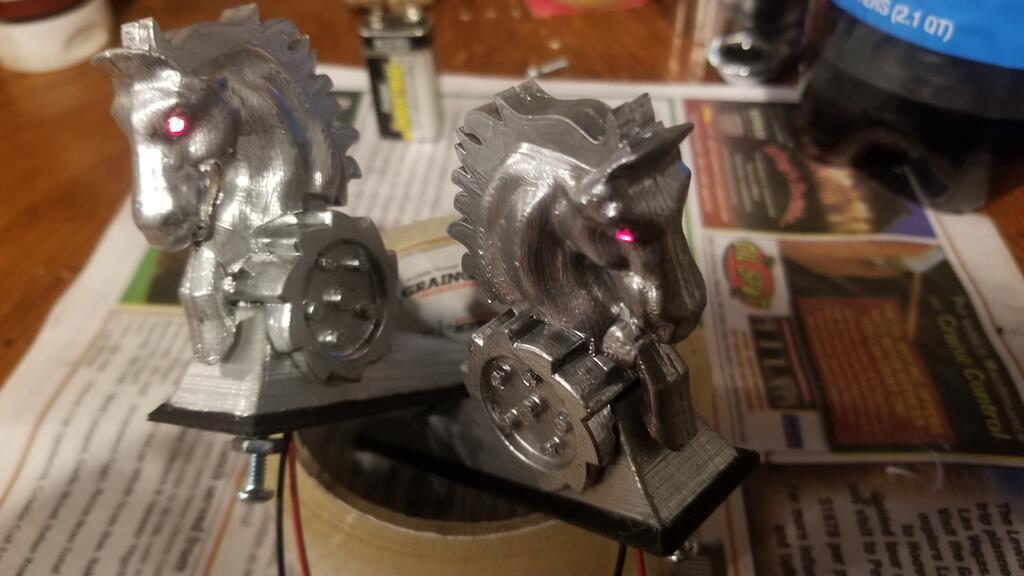

ebinmaine 81,282 #1601 Posted February 13, 2022 54 minutes ago, Oldskool said: Wouldn't that come from a custom set of hood decals? 16 minutes ago, R Scheer said: Glad you took it in the spirit it was intended. How about a 3D WHEELHORSE LOGO, . @Oldskool this is what I was thinking too. @Wheel Horse 3D Grey and I need to have a talk. 3D would add a good depth to the emblem/wording. 19 minutes ago, R Scheer said: having duallies instead Could you 'splain that a tad? What might that look like? 1 Share this post Link to post Share on other sites
Oldskool 6,679 #1602 Posted February 13, 2022 Considering its a "Colossus" Wheel Horse does that mean it's a C-series? 1 Share this post Link to post Share on other sites
wallfish 20,744 #1603 Posted February 13, 2022 On 2/11/2022 at 8:42 AM, ebinmaine said: Does Trina sew too? I'm think'n this should be the same outfit you should wear for the maiden voyage ride! Might distract from the whole wheel horse theme thing though 1 7 Share this post Link to post Share on other sites
ebinmaine 81,282 #1604 Posted February 13, 2022 1 minute ago, wallfish said: Does Trina sew too? I'm think'n this should be the same outfit you should wear for the maiden voyage ride! Might distract from the whole wheel horse theme thing though HAHAHAHAHAHAHAHAHAHAHAHAHAHAHAHAHAHAHAHAHAHAHAHAHAHAHAHAHAHAHAHA. I'm. Uhhhh. Yeah I'm not sure that's gonna happen. 3 Share this post Link to post Share on other sites
ebinmaine 81,282 #1605 Posted February 13, 2022 20 minutes ago, Oldskool said: Considering its a "Colossus" Wheel Horse does that mean it's a C-series? Absolutely. 1 Share this post Link to post Share on other sites
peter lena 10,125 #1606 Posted February 13, 2022 @ebinmaine, thanks for the picture over load , noticed a number of times a spot to , add a vertical fuel check valve , easy to have a straight drop vertical section of fuel line , that would hold your fuel in wait for a start , typically " hard pipe " or tube the majority of a run , use steel brake tubing for most of it , use metal braided swage lock hoses at finish . like your views on the build , pete 1 Share this post Link to post Share on other sites
Stormin 9,988 #1607 Posted February 13, 2022 17 minutes ago, wallfish said: Does Trina sew too? I'm think'n this should be the same outfit you should wear for the maiden voyage ride! YE GODS! 3 Share this post Link to post Share on other sites
R Scheer 525 #1608 Posted February 13, 2022 What I was thinking is the Hellhorse, but in an emblem format, that could be put on the hood near the steering wheel. Kind of like they do on pickups. Instead of the single wheel though use a duallie, just to live up to the Colossus name. Hopefully this makes sense, I need coffee. 2 1 Share this post Link to post Share on other sites
SylvanLakeWH 32,921 #1609 Posted February 13, 2022 39 minutes ago, wallfish said: Does Trina sew too? I'm think'n this should be the same outfit you should wear for the maiden voyage ride! Might distract from the whole wheel horse theme thing though Visuals… Visuals… again with the visuals… My eyes… My eyes… I can’t feel my eyes… 5 Share this post Link to post Share on other sites
ranger 1,872 #1610 Posted February 13, 2022 Thoughts comments questions suggestions opinions? Beautiful, How about, “POWERED by”, in raised letters above the “KOHLER” name. With maybe “WHEELHORSE” lettering down each side of the grill shell? Doug. 2 Share this post Link to post Share on other sites
Handy Don 17,735 #1611 Posted February 13, 2022 13 hours ago, ebinmaine said: The Head of Tractor and Machinery Design has mentioned using the radiator shell as the grille for Colossus. Extremely cool idea, but then what'll that poor generator do for a radiator cover? 1 Share this post Link to post Share on other sites
ebinmaine 81,282 #1612 Posted February 13, 2022 16 minutes ago, Handy Don said: Extremely cool idea, but then what'll that poor generator do for a radiator cover? It'll enjoy the freedom of not being constrained.....? 1 Share this post Link to post Share on other sites
ebinmaine 81,282 #1613 Posted February 13, 2022 3 hours ago, R Scheer said: What I was thinking is the Hellhorse, but in an emblem format, that could be put on the hood near the steering wheel. Kind of like they do on pickups. Instead of the single wheel though use a duallie, just to live up to the Colossus name. Hopefully this makes sense, I need coffee. I do kinda like the idea of a direct half split down the middle pasted to each side... 1 Share this post Link to post Share on other sites

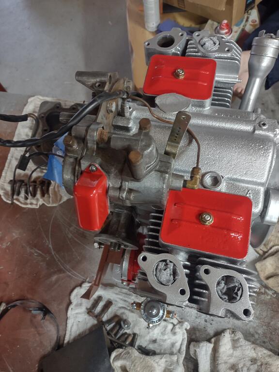

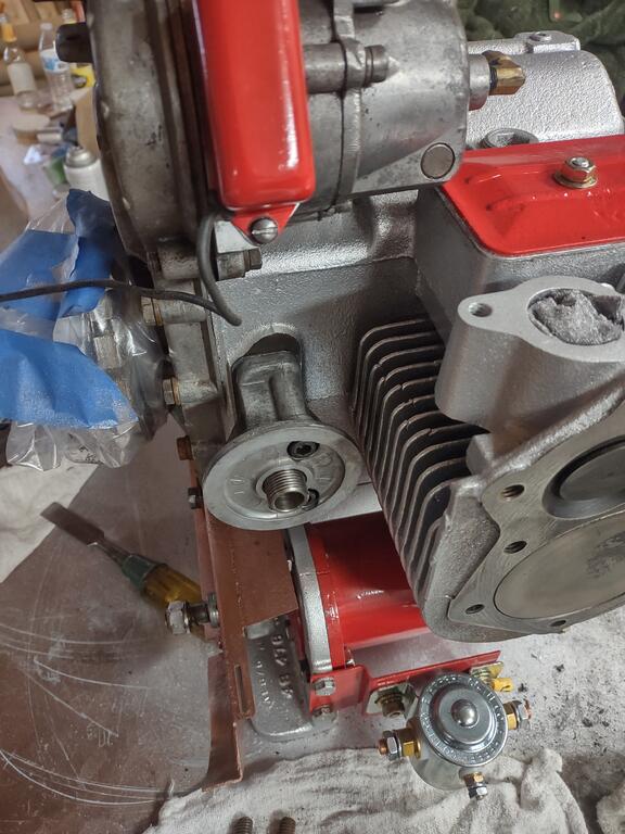

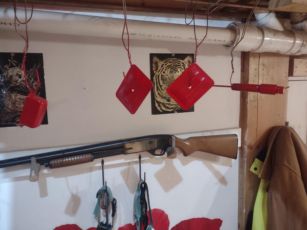

ebinmaine 81,282 #1615 Posted February 13, 2022 Got the majority of the old head gaskets scraped off. Next will be to set up the flat tempered glass table top with some sandpaper and hand plane both heads. Paint Department got a few things coated as well. Valve covers, points cover, and a bracket for the coil. Also this dipstick and tube. This one came off the 1970 Charger Hydro. I'll fill the 2 qts, install the indicator, and see where it lays on the stick. Might change the short pipe section if needed. 3 2 Share this post Link to post Share on other sites

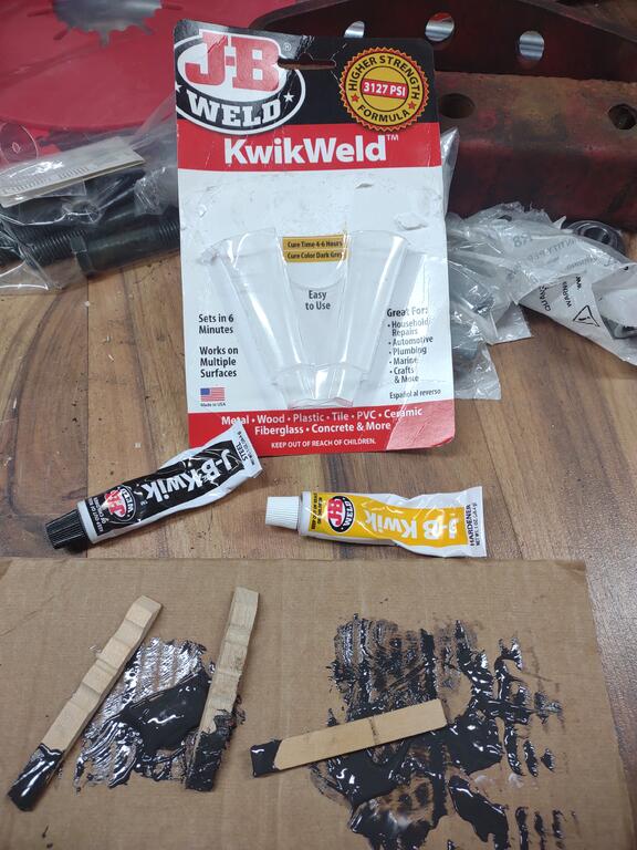

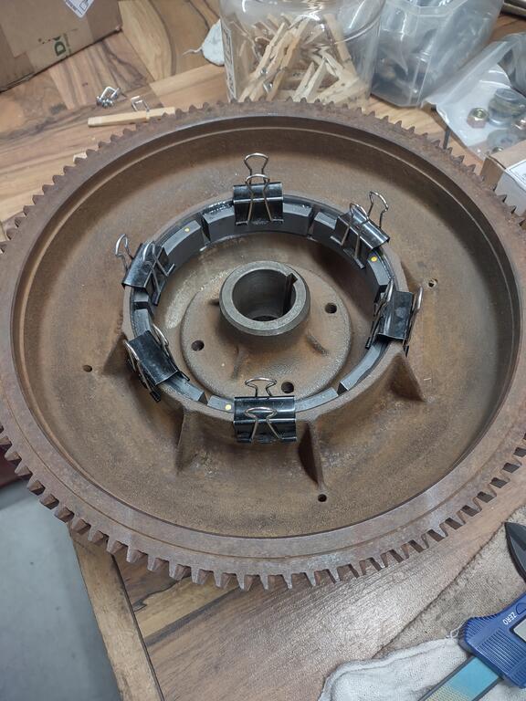

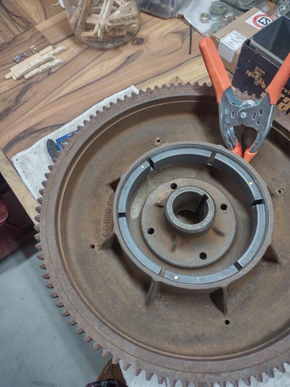

ebinmaine 81,282 #1616 Posted February 16, 2022 Today's entertainment was cleaning up the flywheel and magnets. Got that done and glued them in with good ole J. B. Weld. 5 8 Share this post Link to post Share on other sites

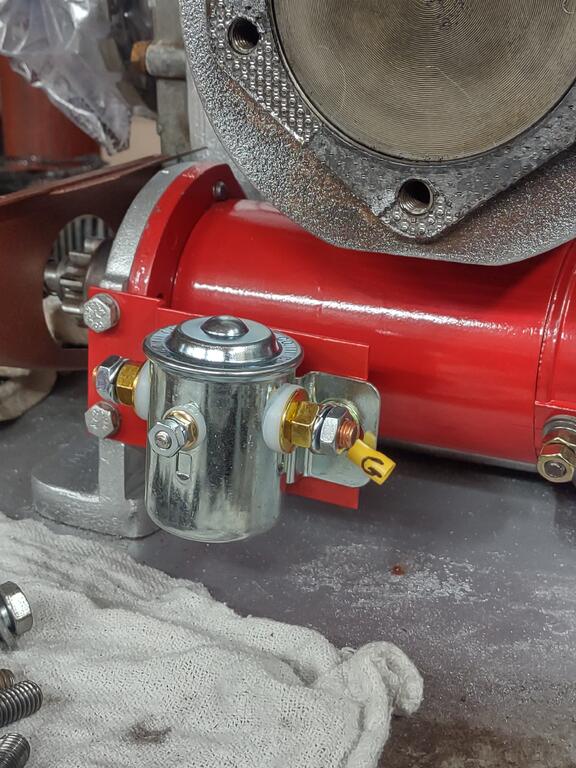

ebinmaine 81,282 #1617 Posted February 16, 2022 A little more done. Valve covers are on. Cleaned the points and checked the Gap again and installed the cover. Cleaned the oil filter adapter up and put that on. 8 5 Share this post Link to post Share on other sites

Lee1977 7,813 #1621 Posted February 17, 2022 3 hours ago, ebinmaine said: Today's entertainment was cleaning up the flywheel and magnets. Got that done and glued them in with good ole J. B. Weld. What were you using JB KwiK for? If this build stays on the usual schedule it's not going to move for another two years. 1 8 Share this post Link to post Share on other sites
WHX?? 58,388 #1622 Posted February 17, 2022 (edited) 1 hour ago, 19richie66 said: No snide comments here. Mind if I Richie?!? Starter assembly does look good tho EB.... Edited February 17, 2022 by WHX?? 1 1 Share this post Link to post Share on other sites
ebinmaine 81,282 #1623 Posted February 17, 2022 9 minutes ago, Lee1977 said: What were you using JB KwiK for? If this build stays on the usual schedule it's not going to move for another two years. I like to do the "hurry up and wait" method. 2 1 5 Share this post Link to post Share on other sites
Lee1977 7,813 #1624 Posted February 17, 2022 1 minute ago, ebinmaine said: I like to do the "hurry up and wait" method. If you used the regular JB weld you get to wait longer. 3 Share this post Link to post Share on other sites
