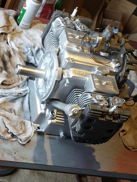

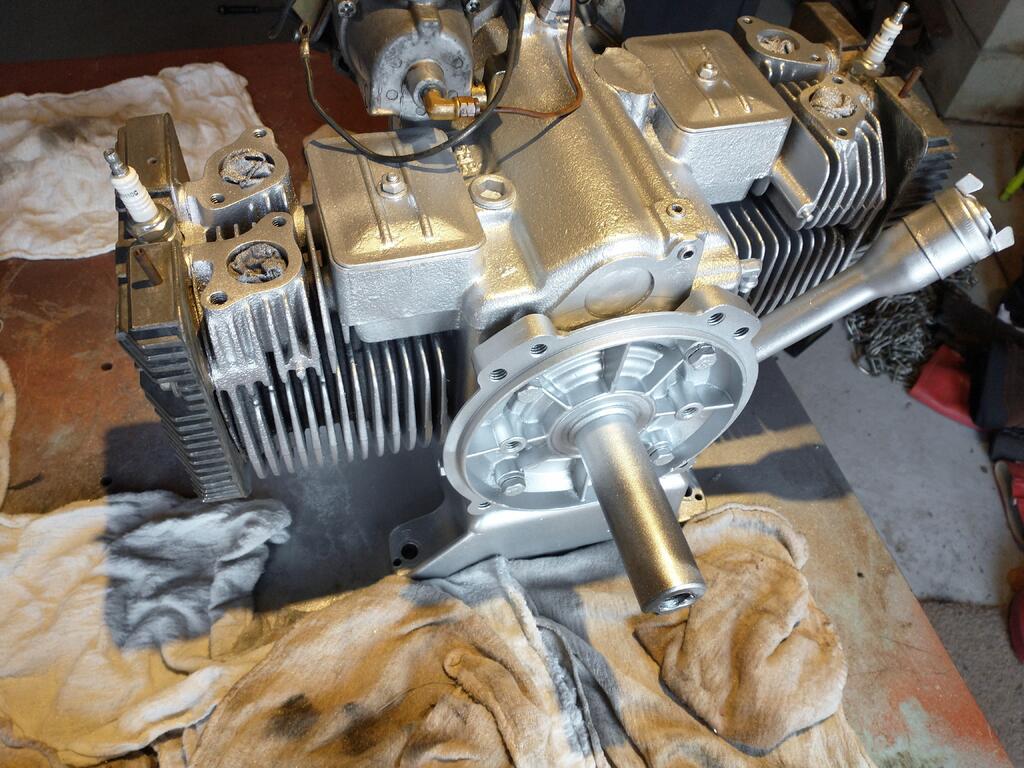

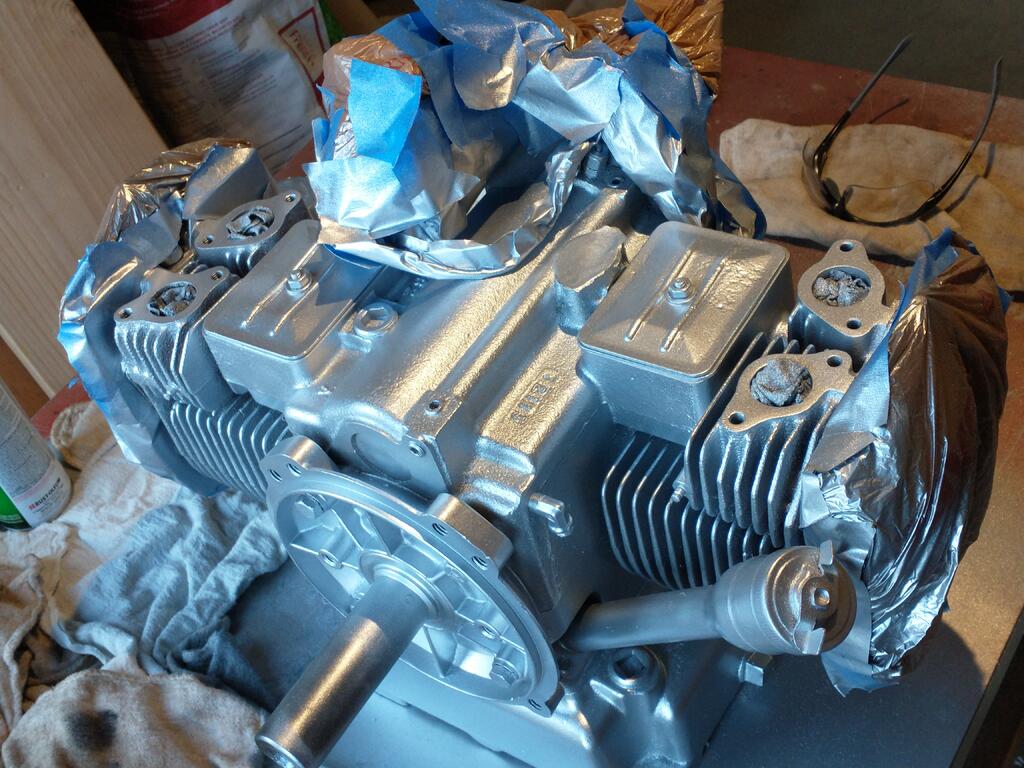

ebinmaine 80,714 #1538 Posted February 5, 2022 We got the final coat(s) of silver paint on the engine block. 3 7 Share this post Link to post Share on other sites
Stormin 9,988 #1539 Posted February 5, 2022 Trina's made a really nice job of that. 1 1 Share this post Link to post Share on other sites
ebinmaine 80,714 #1540 Posted February 5, 2022 6 minutes ago, Stormin said: Trina's made a really nice job of that. Thanks Norm. We're pretty happy with the particular shade and sparkle of this silver. 1 Share this post Link to post Share on other sites
Wheelhorse#1 1,997 #1541 Posted February 5, 2022 Looks good.What a beast 1 1 Share this post Link to post Share on other sites

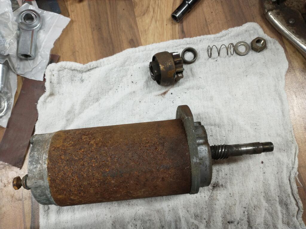

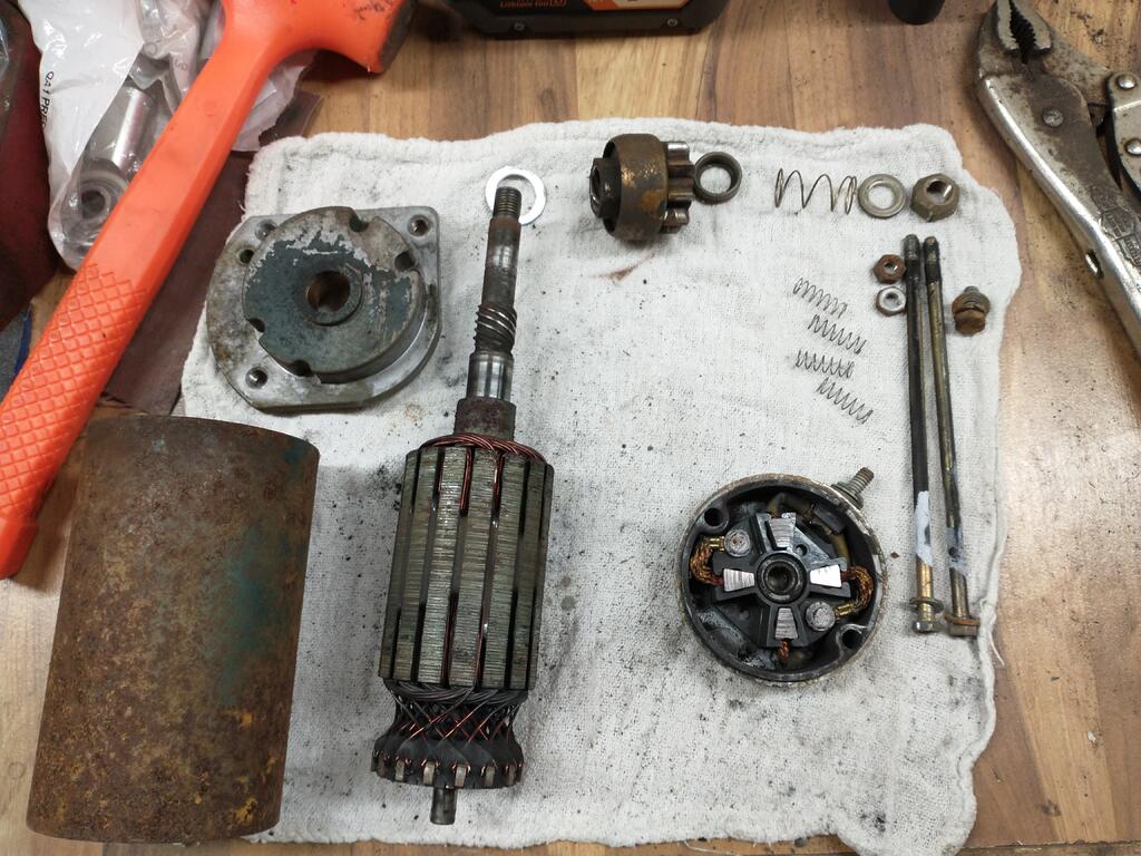

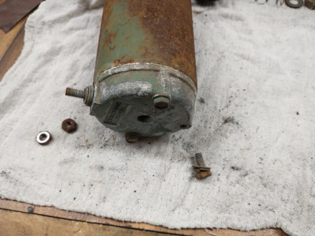

ebinmaine 80,714 #1542 Posted February 6, 2022 Got the starter taken apart this evening. Bushings and brushes look excellent so this'll be a simple clean up and reassemble after painting. 4 4 Share this post Link to post Share on other sites
Jeff-C175 7,211 #1543 Posted February 6, 2022 9 minutes ago, ebinmaine said: brushes How are the springs behind the brushes? It sorta looks like they aren't pushing some of the brushes out? (probably just the camera angle) 3 Share this post Link to post Share on other sites
ebinmaine 80,714 #1544 Posted February 6, 2022 1 minute ago, Jeff-C175 said: How are the springs behind the brushes? It sorta looks like they aren't pushing some of the brushes out? (probably just the camera angle) Good eye! Not the camera angle. I'd taken the springs out so I could look at the brushes in a flat plane. Ain't any in there! They're fine though. All in good shape and equal size etc. 2 Share this post Link to post Share on other sites
Jeff-C175 7,211 #1545 Posted February 6, 2022 1 hour ago, ebinmaine said: Ain't any in there! I thought that might be them also in the pic... ! 2 Share this post Link to post Share on other sites
ebinmaine 80,714 #1546 Posted February 6, 2022 3 hours ago, Jeff-C175 said: I thought that might be them also in the pic... ! Oh yeah yeah. 1 Share this post Link to post Share on other sites

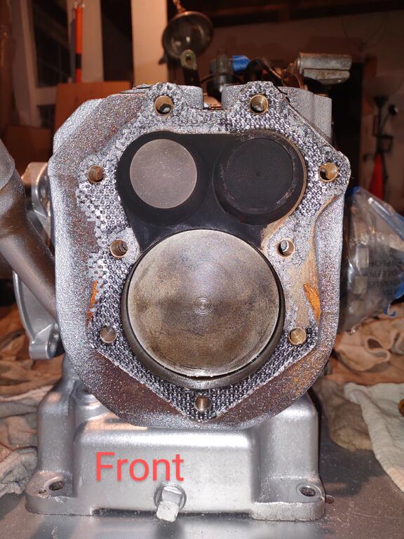

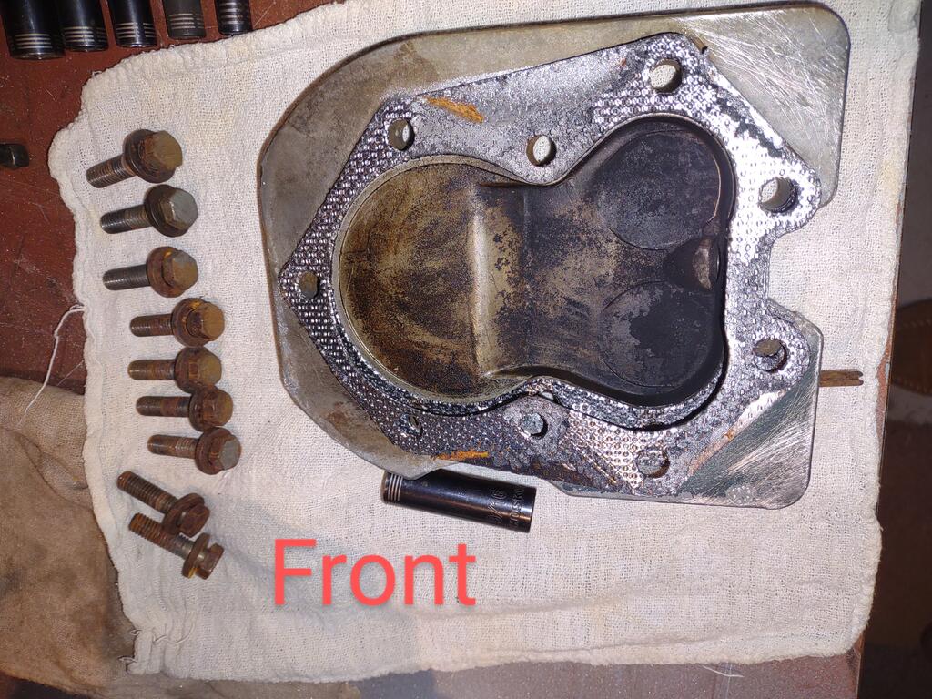

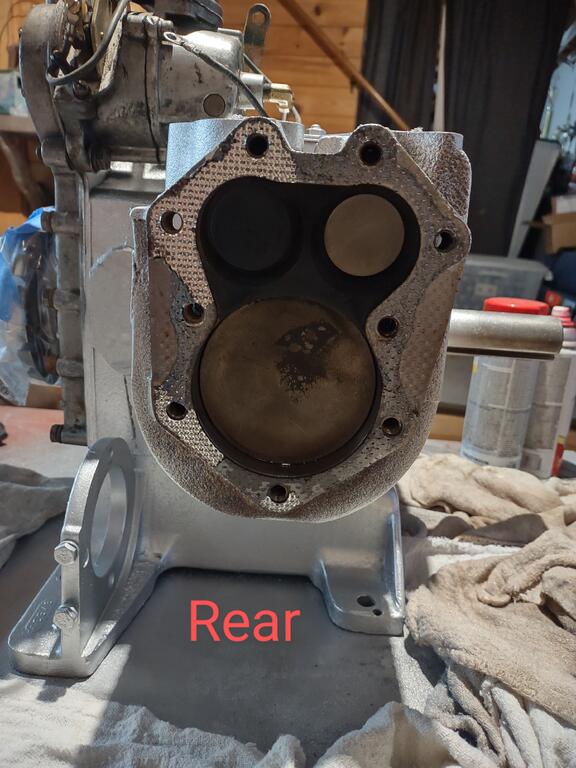

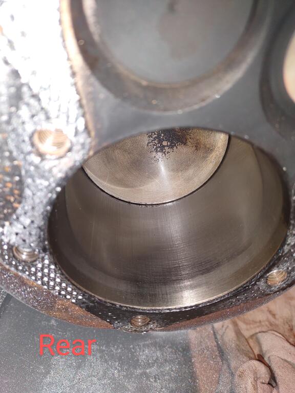

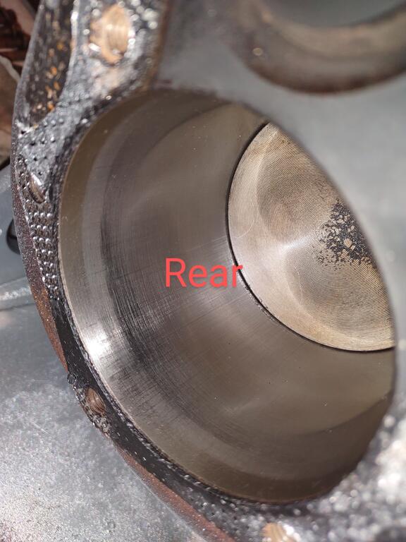

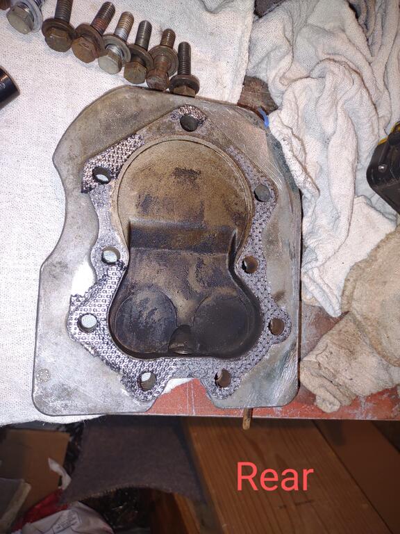

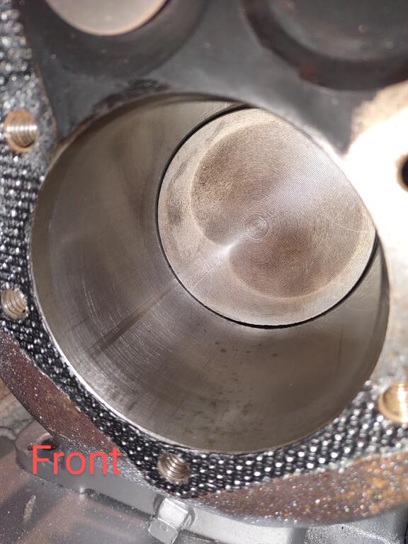

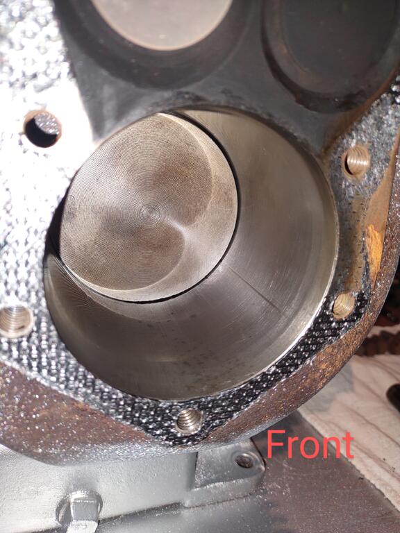

ebinmaine 80,714 #1548 Posted February 6, 2022 We got the starter cleaned up and painted. It's awaiting reassembly. I took the heads off, wiped out the bores and took a few pics. This engine has been rebuilt .010 and appears to have been used some since. Cross hatching is still evident. The front bore has 2 lines to the eye that can't be felt by my or Trina's touch. 3 2 Share this post Link to post Share on other sites
Jeff-C175 7,211 #1549 Posted February 6, 2022 27 minutes ago, ebinmaine said: heads off Looks like the head gaskets were the type with no 'fire ring' ? I don't like those, but for no particular reason really. I just feel like the fire ring type are probably more durable. 2 Share this post Link to post Share on other sites
ebinmaine 80,714 #1550 Posted February 7, 2022 14 minutes ago, Jeff-C175 said: Looks like the head gaskets were the type with no 'fire ring' ? I don't like those, but for no particular reason really. I just feel like the fire ring type are probably more durable. I noticed that right away as well. And I agree. Old school knowledge always indicated a compression ring was a good sign of a better quality gasket and the ability to seal more for longer. First hint was on one side 2 head bolts were new. There was a tiny bit of (fog/mist/film?) Around 2 or 3 bolts on each head. THAT was the reason I decided to replace the gaskets. The rear cylinder head gasket came off very easily. Almost as if it was already cracked but I see no evidence of that. 1 Share this post Link to post Share on other sites
