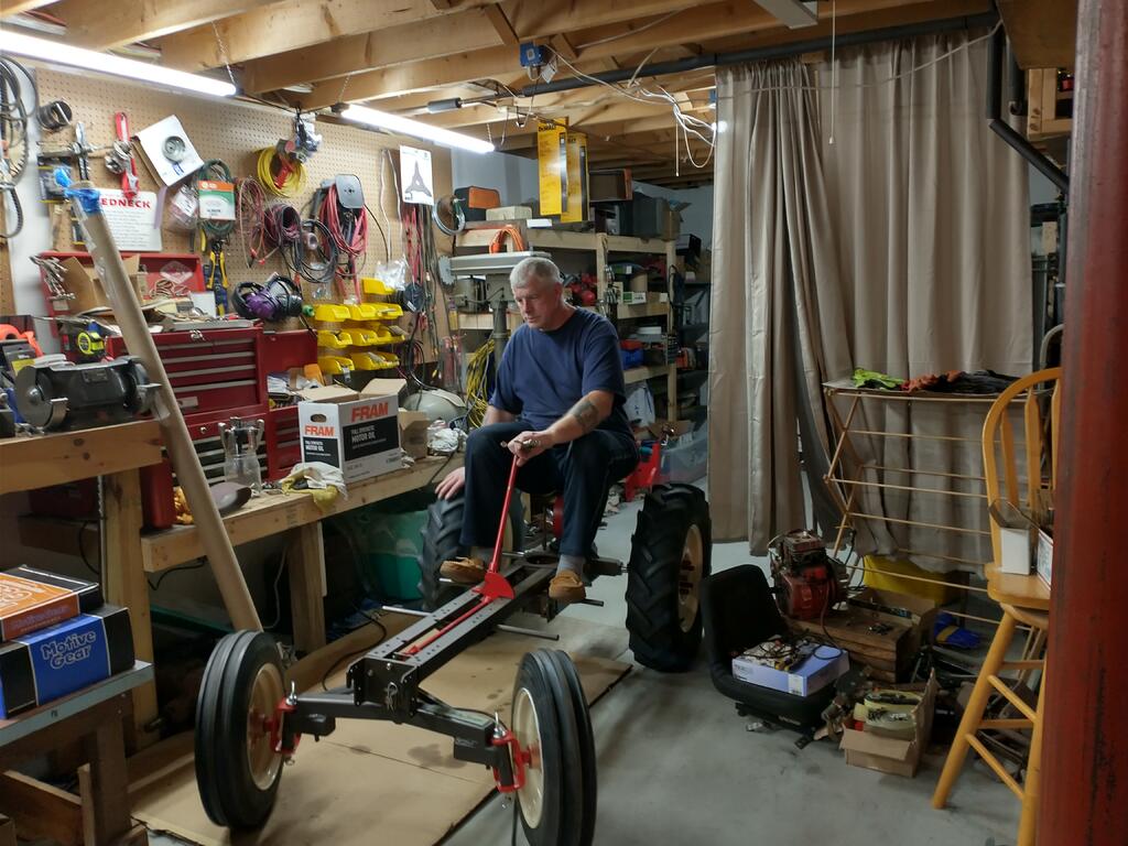

Oldskool 6,679 #1303 Posted November 13, 2021 @ebinmaine Eric now that the steering is together how do you think the turning will be compared to a stock tractor? 2 Share this post Link to post Share on other sites
ebinmaine 81,282 #1304 Posted November 13, 2021 15 minutes ago, Oldskool said: @ebinmaine Eric now that the steering is together how do you think the turning will be compared to a stock tractor? We moved it from it's build position to get closer to the door last night. The wheels do turn a healthy degree from straight. The entire fan gear is well used lock to lock. It's looonngg compared to a stock tractor. I had to "double back" twice to clear the couch and I can do that in one swing with a short frame. I don't know what the actual full turning circle is yet. It'll be fine for the forest paths but there are some corners that will need trimming of the surrounding trees. 2 1 Share this post Link to post Share on other sites

Lee1977 7,813 #1310 Posted November 13, 2021 10 hours ago, ebinmaine said: Bonus pic by The Photography Department. Now you need to get a 3/4" sleeve and extend the steering column about 6".. That would put it up about elbow height. 2 1 Share this post Link to post Share on other sites
ebinmaine 81,282 #1311 Posted November 13, 2021 27 minutes ago, Lee1977 said: Now you need to get a 3/4" sleeve and extend the steering column about 6".. That would put it up about elbow height. That's just about what I'm thinking too. 1 Share this post Link to post Share on other sites

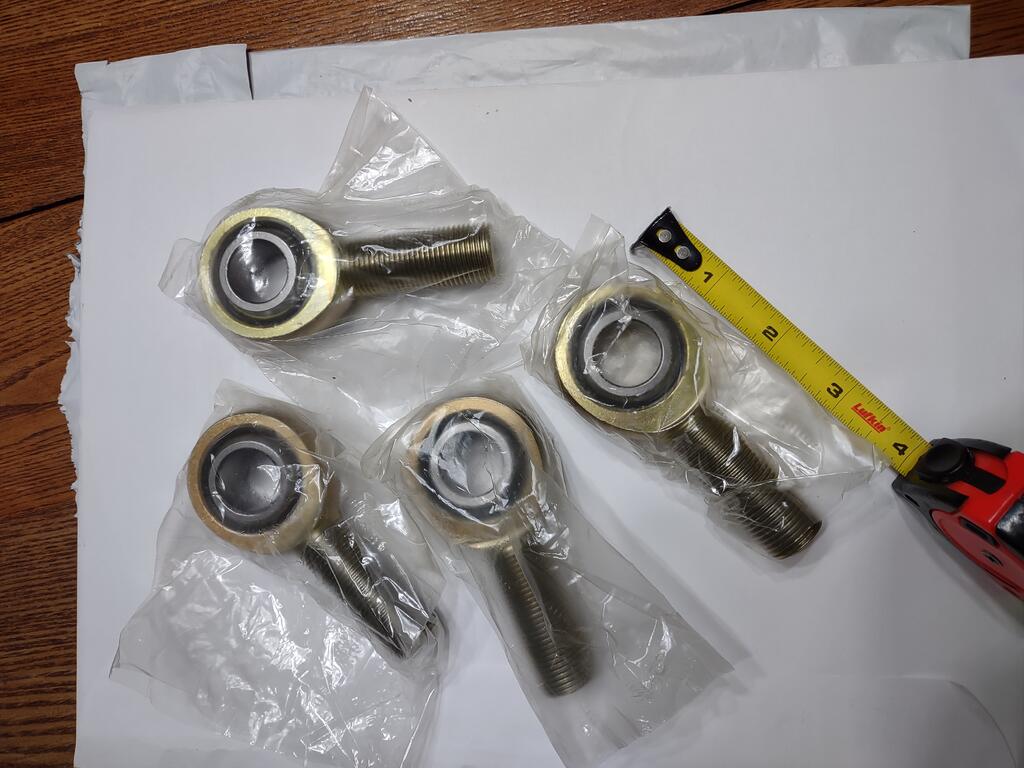

ebinmaine 81,282 #1316 Posted November 23, 2021 Got these today. 3/4" bore. 3/4" fine threads. I'm figuring on using them as steering shaft supports. 1 3 Share this post Link to post Share on other sites

Maxwell-8 4,371 #1318 Posted November 23, 2021 8 hours ago, ebinmaine said: Got these today. 3/4" bore. 3/4" fine threads. I'm figuring on using them as steering shaft supports. Good thing you are enforcing the front-end to accommodate for the 187lbs beast of a Kohler K582. 2 Share this post Link to post Share on other sites
bds1984 1,519 #1319 Posted November 23, 2021 Perhaps this has been asked before, Eric, but have you thought about using the gear reduction setup from a 520H? I think it would aid in reducing steering effort and decreasing your Titanic turning radius. 2 1 Share this post Link to post Share on other sites
ebinmaine 81,282 #1320 Posted November 23, 2021 3 minutes ago, bds1984 said: Perhaps this has been asked before, Eric, but have you thought about using the gear reduction setup from a 520H? I think it would aid in reducing steering effort and decreasing your Titanic turning radius. Can't remember if it's been brought up in this thread or not either but I've certainly processed the thought more than once. The reason I didn't go that direction is simply because of cost. I haven't been able to find the steering setup for less than $250 to $350. I will have a 30% advantage in leverage because the "steering wheel" I'm using is substantially larger. It's still going to give me a heck of a workout without any sort of gear reduction. 1 Share this post Link to post Share on other sites
Maxwell-8 4,371 #1321 Posted November 23, 2021 27 minutes ago, ebinmaine said: Can't remember if it's been brought up in this thread or not either but I've certainly processed the thought more than once. The reason I didn't go that direction is simply because of cost. I haven't been able to find the steering setup for less than $250 to $350. I will have a 30% advantage in leverage because the "steering wheel" I'm using is substantially larger. It's still going to give me a heck of a workout without any sort of gear reduction. And the weight will be noticeable. When I put that Lombardini engine (about same weight) on the chassis, steering got a lot worse... I see you have 3 ribs tires on the front, they will help out for sure. maybe a bit higher pressure in them and add in the bigger steering wheel. You will be golden. 2 Share this post Link to post Share on other sites
ebinmaine 81,282 #1322 Posted November 23, 2021 39 minutes ago, Maxwell-8 said: weight will be noticeable Absolutely agree with that. I've had the Mckissick chipper on and off my C160 several times. Quite a huge difference. The size and weight of that is probably comparable to what I'll be doing with this tractor. 41 minutes ago, Maxwell-8 said: 3 ribs tires on the front, they will help out for sure. maybe a bit higher pressure in them and add in the bigger steering wheel. You will be golden That will certainly be a positive in my favor. Not sure if it will be enough though.... 1 1 Share this post Link to post Share on other sites
Maxwell-8 4,371 #1323 Posted November 23, 2021 8 minutes ago, ebinmaine said: Absolutely agree with that. I've had the Mckissick chipper on and off my C160 several times. Quite a huge difference. The size and weight of that is probably comparable to what I'll be doing with this tractor. That will certainly be a positive in my favor. Not sure if it will be enough though.... I will be able to tell you a soon as I installed my lombardini. probably in the upcoming week or two! 2 Share this post Link to post Share on other sites
bds1984 1,519 #1324 Posted November 23, 2021 3 hours ago, ebinmaine said: Can't remember if it's been brought up in this thread or not either but I've certainly processed the thought more than once. The reason I didn't go that direction is simply because of cost. I haven't been able to find the steering setup for less than $250 to $350. I will have a 30% advantage in leverage because the "steering wheel" I'm using is substantially larger. It's still going to give me a heck of a workout without any sort of gear reduction. I think I bought mine for $300 back in early 2015. Yes it was pricey, but worth the investment. Every time I found a 520 for sale cheap, it was either a straight axle model or missing the hub or wheel; never complete. I'm kinda on the hunt for one right now so I can convert my straight axle 520 over to the gear reduction setup but it is cost prohibitive at the moment. It is difficult to go back to a regular system after spoiling yourself with it as it really is close to a power steering feel. 3 Share this post Link to post Share on other sites
ebinmaine 81,282 #1325 Posted November 23, 2021 4 minutes ago, bds1984 said: power steering Absolutely understandable. I've always had a great preference towards a firm feel steering system, so to speak. Even with a 21 or 22 inch steering wheel I think a 1:1 ratio from the upper to lower steering shafts might be just a tad past, firm. 😂 1 Share this post Link to post Share on other sites
