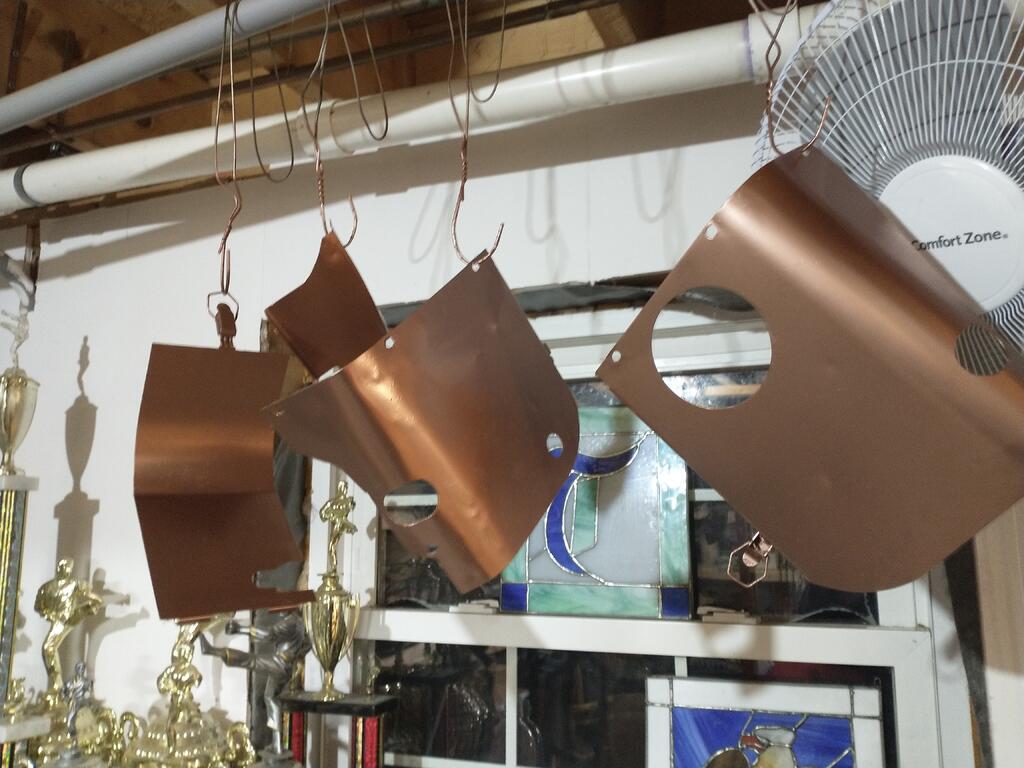

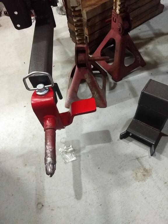

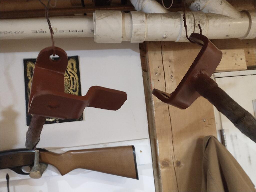

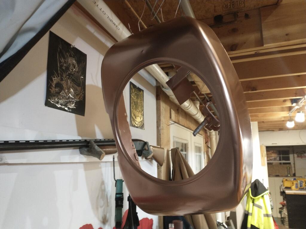

ebinmaine 80,426 #1101 Posted April 1, 2021 The Paint Department was at it again this evening... New spindles in primer. Retouch the axle. First coat of copper on the engine tins. 1 9 Share this post Link to post Share on other sites
AMC RULES 37,259 #1102 Posted April 1, 2021 Nice to see somebunny getting work accomplished there. 1 2 Share this post Link to post Share on other sites
WheelhorseBob 1,550 #1103 Posted April 1, 2021 Very nice! 1 Share this post Link to post Share on other sites
Tractorhead 9,217 #1104 Posted April 1, 2021 4 hours ago, ebinmaine said: The Paint Department was at it again this evening... New spindles in primer. Whow !!! even a pretty cool shifter stick on the Wallhanger to cure Bro 👍 2 Share this post Link to post Share on other sites
Stormin 9,988 #1105 Posted April 1, 2021 That copper is the dogs whatsits. 1 1 Share this post Link to post Share on other sites

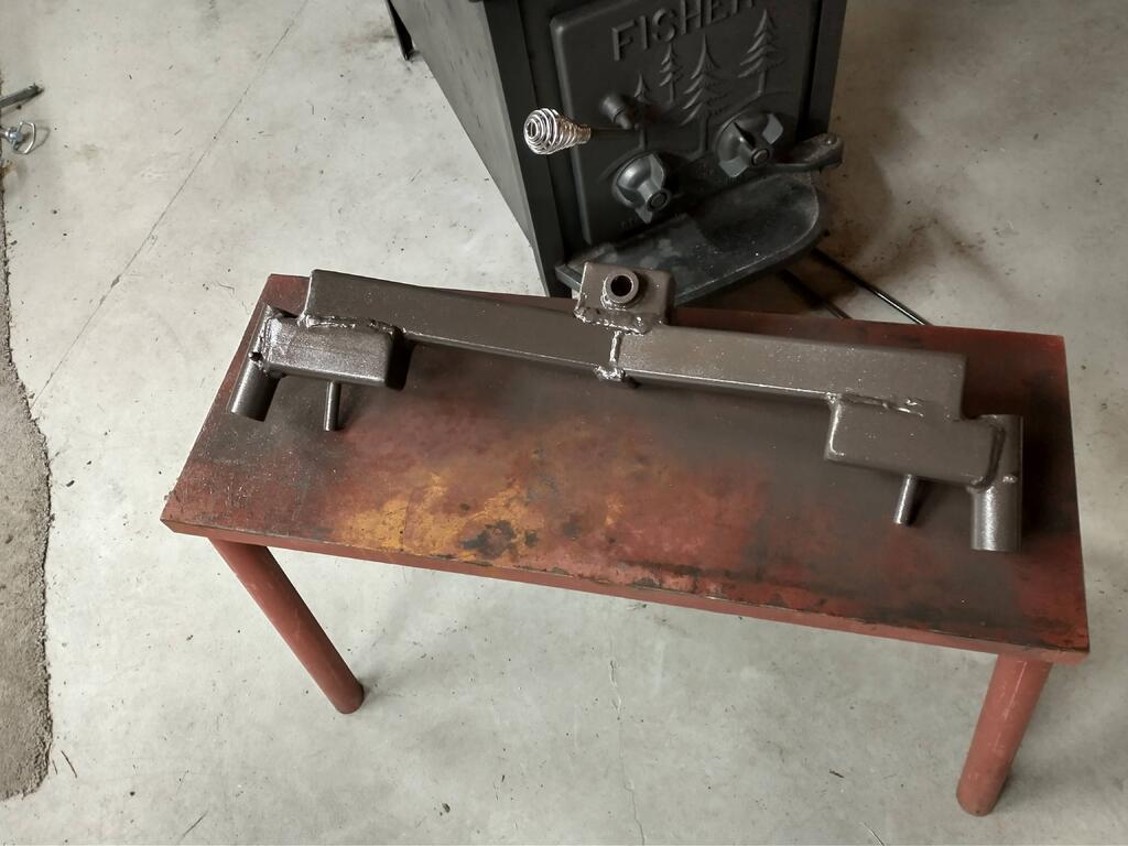

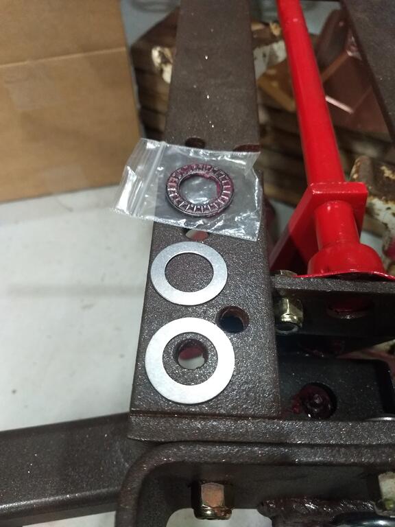

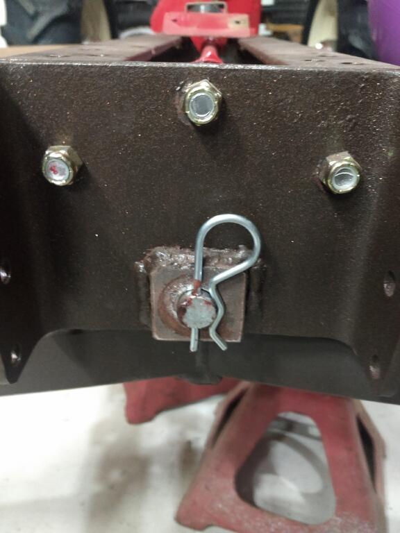

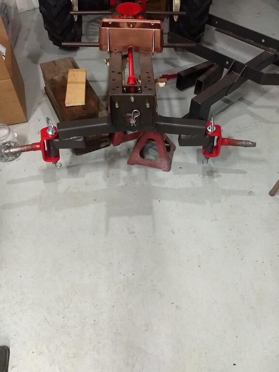

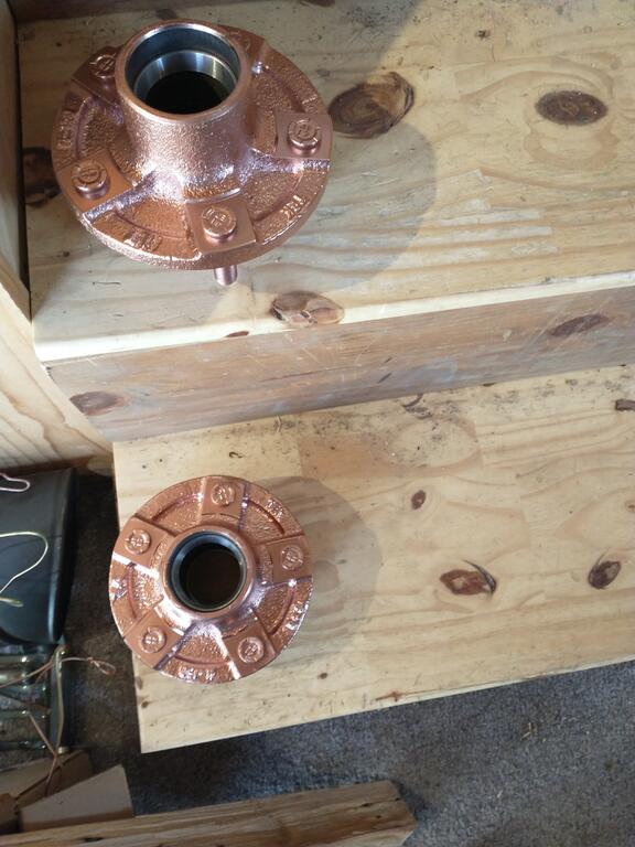

ebinmaine 80,426 #1123 Posted April 4, 2021 Trina did some more painting and I got the front axle in place. I put roller bearings in with the spindles. I can already feel that those will make for a nice steering rig. 4 5 Share this post Link to post Share on other sites
Tractorhead 9,217 #1124 Posted April 4, 2021 Good idea with the roller bearings, like it. Curious about when the whole machine is completed. 4 Share this post Link to post Share on other sites
19richie66 17,932 #1125 Posted April 4, 2021 I have those thrust bearings and washers on skittles. Makes it nice! 7 Share this post Link to post Share on other sites
