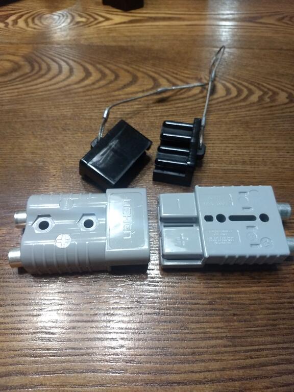

ebinmaine 80,708 #801 Posted December 3, 2020 29 minutes ago, Tractorhead said: I would take care, that you get the sealed ip54 version of this connectors for Tractor use, the others won‘t last long on outside or offroad use. I don't know what the numbers were that I ordered but it is a sealed type such as you talk about. 1 Share this post Link to post Share on other sites

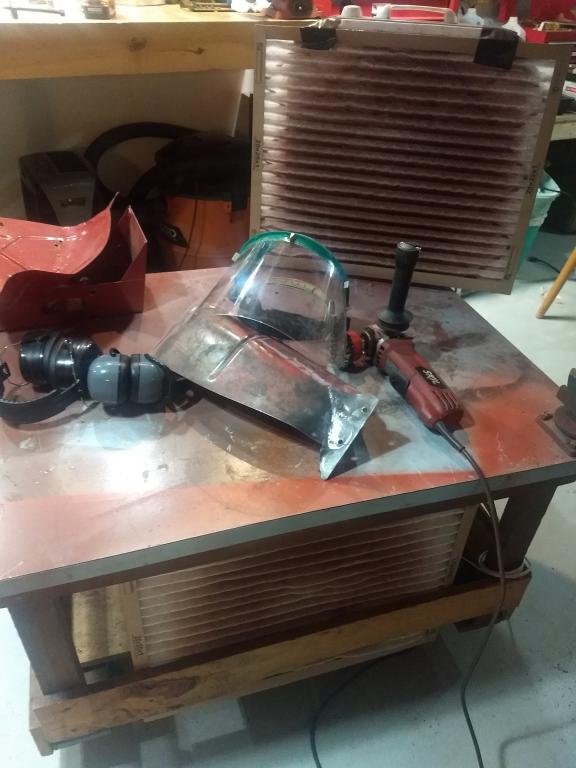

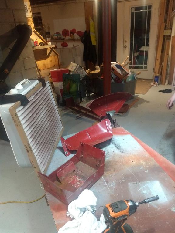

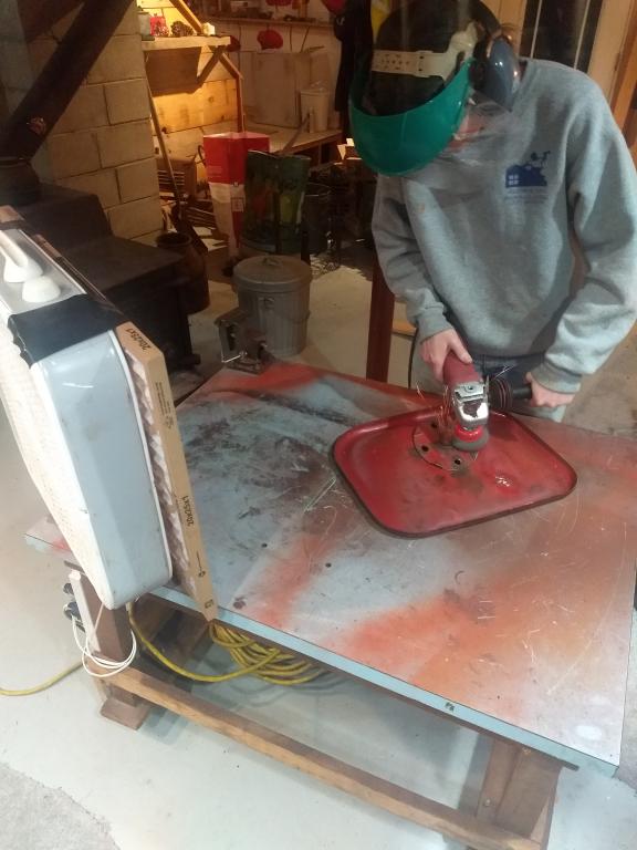

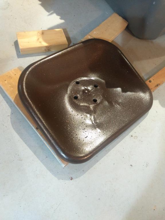

Horse Newbie 7,405 #802 Posted December 5, 2020 On 12/29/2019 at 6:50 AM, ebinmaine said: Trina got after the seat and rear fenders this evening. We had some fun removing the bolts to disassemble the seat and fenders. PO solutions.... She removed the paint from the seat and one fender. I straightened out the seat pan just a little with a hammer on the vise anvil. 2 coats primer, 2 coats paint. It'll need at least 1 more coat of paint but I like this textured metallic brown ALOT. One VERY nice advantage to this textured paint is that the seat surface will be slightly more resistant to "butt slide" movement. She also put a good coat of primer on the frame. @ebinmaine Is that fan sucking or blowing through the filter ? And is it for collecting paint over spray, grinding/sanding dust, or both ? 1 Share this post Link to post Share on other sites
ebinmaine 80,708 #803 Posted December 5, 2020 Just now, Horse Newbie said: @ebinmaine Is that fan sucking or blowing through the filter ? And is it for collecting paint over spray, grinding/sanding dust, or both ? It sucks through the filter. Built to collect dust and worked very well with fine disposable filters. Later we added another fan and filter. We tried using washable filters and they were .....ok. The disposable filter was a lot better at catching the dust. 2 1 Share this post Link to post Share on other sites
Horse Newbie 7,405 #804 Posted December 5, 2020 @ebinmaine I just read this whole thread...now I'm eligible for medicare...lol But seriously, I learn so much on the Square ! That box fan and filter is a good idea. Now that we are going into colder weather I will be doing more wire brushing and spray painting inside. I'll try it out ! 2 2 Share this post Link to post Share on other sites
ebinmaine 80,708 #805 Posted December 5, 2020 3 hours ago, Horse Newbie said: @ebinmaine I just read this whole thread...now I'm eligible for medicare...lol But seriously, I learn so much on the Square ! That box fan and filter is a good idea. Now that we are going into colder weather I will be doing more wire brushing and spray painting inside. I'll try it out ! I'd add a little to that table/fan info. Choose a table height that's very comfortable. After you've done a few minutes of grinding note where your dust pile is. If it's in the fan filter, great! We all have different habits and the direction of travel of the removed material will vary. 2 Share this post Link to post Share on other sites
ebinmaine 80,708 #806 Posted December 10, 2020 Folks. Here's the connector set-up. They range in price from $14 to 19. 5 Share this post Link to post Share on other sites
Oldskool 6,678 #807 Posted December 10, 2020 Those look really nice 1 Share this post Link to post Share on other sites
ebinmaine 80,708 #808 Posted December 10, 2020 Just now, Oldskool said: Those look really nice Seem decent. Well made. Solid. 1 Share this post Link to post Share on other sites

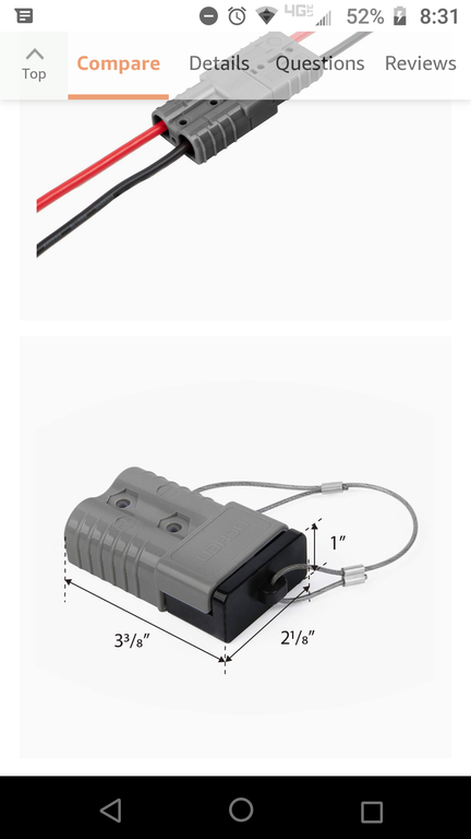

Oldskool 6,678 #809 Posted December 10, 2020 Dimensions? Share this post Link to post Share on other sites

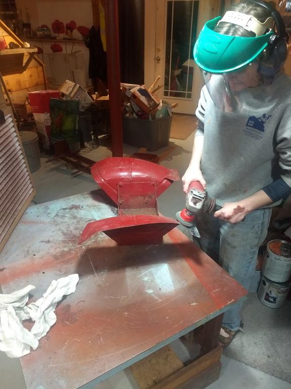

8ntruck 9,301 #810 Posted December 10, 2020 Is Trina using a knot brush or a pad sander? I can't quite see for sure in the pictures. 1 Share this post Link to post Share on other sites
ebinmaine 80,708 #811 Posted December 10, 2020 6 minutes ago, 8ntruck said: Is Trina using a knot brush or a pad sander? I can't quite see for sure in the pictures. It's a wire brush for sure. Not sure if it's knots... Or not. (plain strands) We have both. Share this post Link to post Share on other sites
ebinmaine 80,708 #812 Posted December 10, 2020 26 minutes ago, Oldskool said: Dimensions? 1 Share this post Link to post Share on other sites
Oldskool 6,678 #813 Posted December 10, 2020 6 minutes ago, ebinmaine said: Oh they are bigger than I thought. Nice. They should work well 1 Share this post Link to post Share on other sites
Tractorhead 9,217 #814 Posted December 10, 2020 But don’t forget to protect them regular with batterygrease or Vaseline or whatever comes handy. They have a protector if not connected, but they not primary built for outdoor use. Water can drain reverse from the Wires to contact surfaces and they can quickly rotten. We had a bad example here, if i have the time, i will do a Picture of the result after 2 Years outdoor. Another Company have reworked that RV with such connections with an extreme Bad result. 1 Share this post Link to post Share on other sites
ebinmaine 80,708 #815 Posted December 10, 2020 6 hours ago, Oldskool said: Oh they are bigger than I thought. Nice. They should work well These are made for 2 to 4 gauge wire. There are smaller ones available for (6 to 10?) gauge. I opted for the larger size knowing I may use them as a battery cutoff or jumper cable connection. 3 minutes ago, Tractorhead said: But don’t forget to protect them regular with batterygrease Good reminder. Thank you. 1 1 Share this post Link to post Share on other sites
