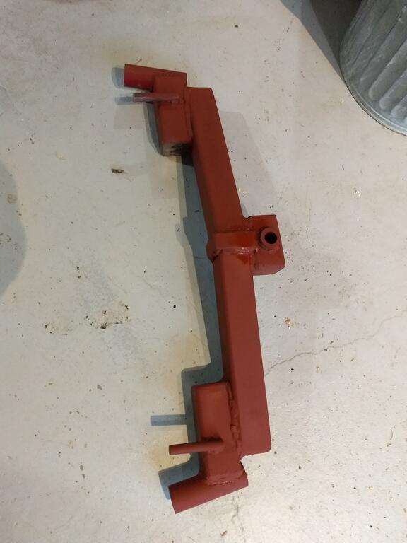

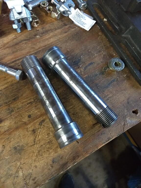

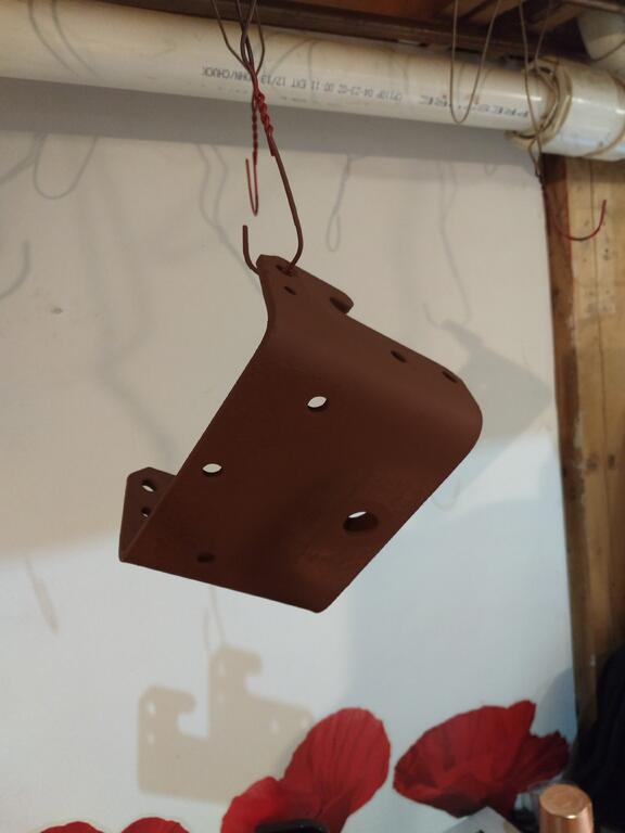

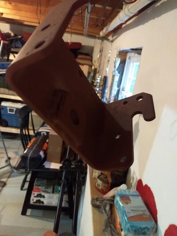

ebinmaine 80,326 #609 Posted May 7, 2020 I got the axle stubs trimmed down to length and The Paint Department did a bit of spraying. 7 1 Share this post Link to post Share on other sites

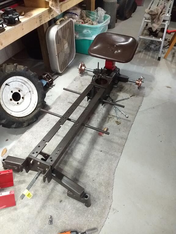

ebinmaine 80,326 #610 Posted May 9, 2020 Trina got the front axle bracket and the axle painted up. We installed the frame and its rear supports onto the adapter this morning. Also bolted the front bracket on with axle in place to verify position after I had welded in braces on both the frame and front support. Lines up nicely. I'll use the piece of 3/4 rod in the photo to make up an extended length axle pivot pin. Look looooong?? The wheel base is 9" longer than a standard C series. Adding the extra size of the tire diameter this machine will be 16" longer than stock. 7 13 Share this post Link to post Share on other sites

Pullstart 71,108 #612 Posted May 9, 2020 I’m sure I could find the answers... but for the sake of conversation... 1) What is your source of front axle stubs? 2) Is your hub pattern the same as the rear GT bolt pattern? 3) imagine 6-12’s on the front of some beast machine with 26x12-12’s out back! 2 Share this post Link to post Share on other sites
ebinmaine 80,326 #613 Posted May 9, 2020 4 minutes ago, pullstart said: What is your source of front axle stubs? Etrailer.com Several different grades of quality available on most of their items. Customer service is excellent. I'd recommend them. 4 minutes ago, pullstart said: Is your hub pattern the same as the rear GT bolt pattern Sure is. 5 x 4.5 5 minutes ago, pullstart said: imagine 6-12’s on the front of some beast machine with 26x12-12’s out back! This will have 6-12 AGs on trailer wheels front. 7.60-15 AGs on (camper/trailer?) wheels rear. Should be a good combo. 2 4 Share this post Link to post Share on other sites
Pullstart 71,108 #614 Posted May 9, 2020 Just now, ebinmaine said: Etrailer.com Several different grades of quality available on most of their items. Customer service is excellent. I'd recommend them. Sure is. 5 x 4.5 This will have 6-12 AGs on trailer wheels front. 7.60-15 AGs on (camper/trailer?) wheels rear. Should be a good combo. don’t tell anyone I said this... that’s a genius tire idea! 2 4 Share this post Link to post Share on other sites

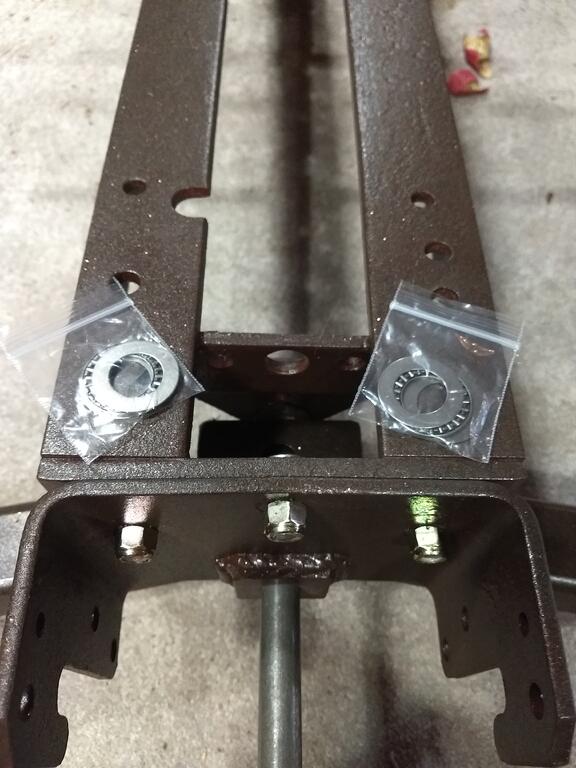

ebinmaine 80,326 #618 Posted May 11, 2020 3 hours ago, Stormin said: Where's the weekend progress report Well.... The only real change is that I got some roller bearings for the front spindles. steering should be easier. 5 2 1 Share this post Link to post Share on other sites

RandyLittrell 3,945 #625 Posted May 17, 2020 On 5/11/2020 at 6:53 PM, ebinmaine said: Well.... The only real change is that I got some roller bearings for the front spindles. steering should be easier. Wherd did you get your bearings Eric? I need to do that kid on my loader tractor. Randy 1 Share this post Link to post Share on other sites
