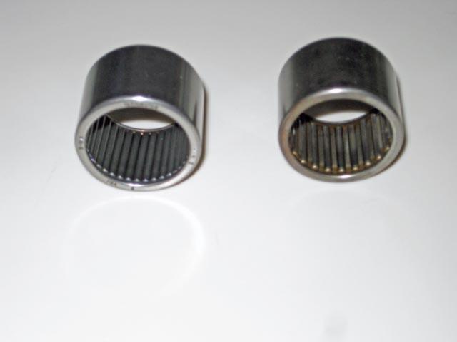

pfrederi 21,230 #459 Posted March 30, 2020 9 minutes ago, ebinmaine said: when you say full complement I'm going to assume that you mean the needle length is literally from one side of the bearing to the other side of the bearing. So like if it's a 1" wide bearing, minus end curl to keep the needles in place... Like a 7/8 inch long needle? That's the only kind I've ever seen. Full complement has no spacers. Picture shows both types WH used.... Not sure when they changed or why.... 3 Share this post Link to post Share on other sites
ebinmaine 80,975 #460 Posted March 30, 2020 Oh yeah ok.... The two in this one are definitely full. I don't remember seeing the other type in a horse.. Share this post Link to post Share on other sites

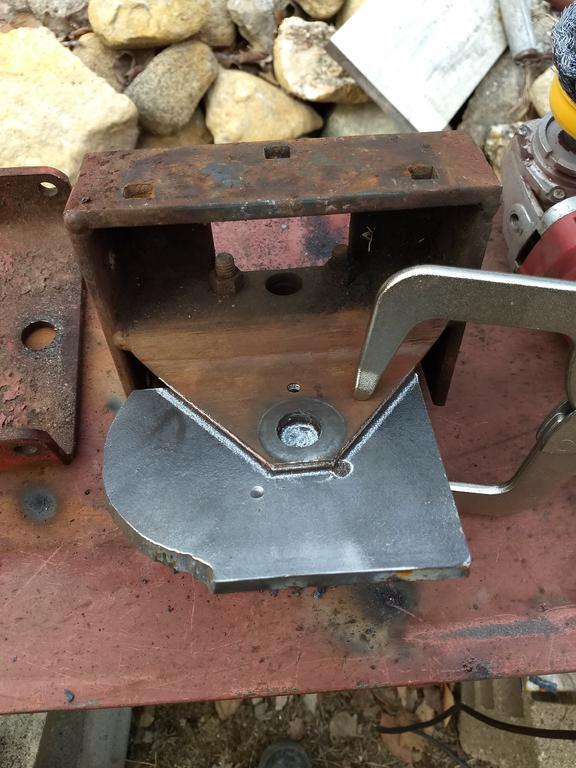

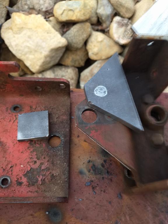

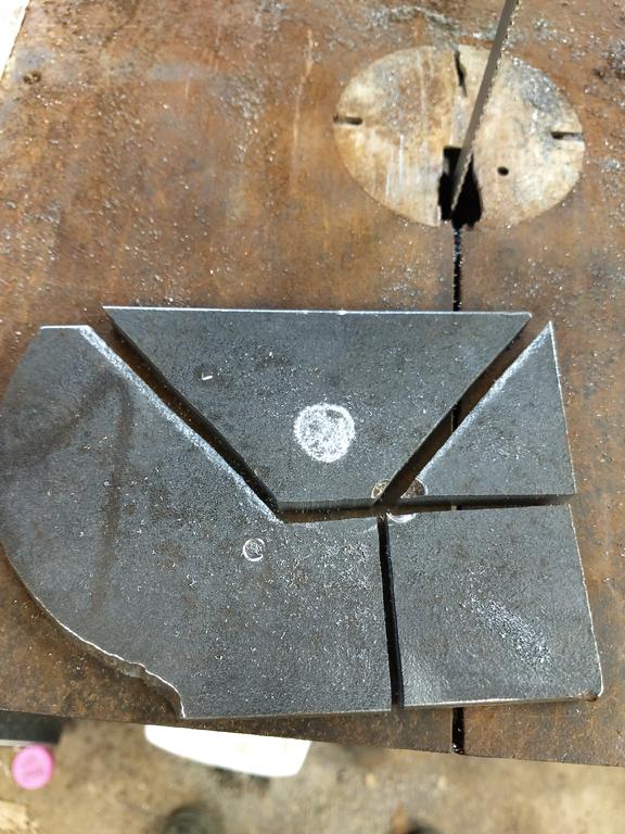

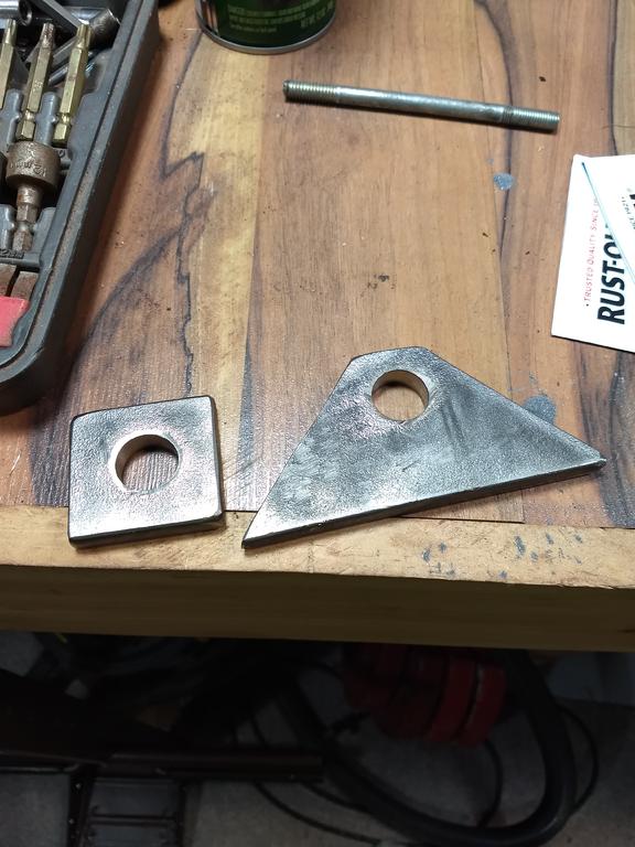

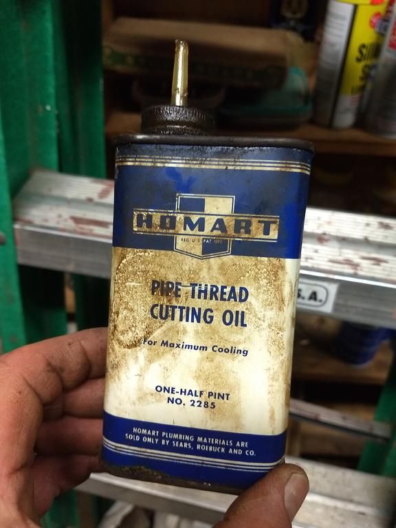

ebinmaine 80,975 #461 Posted April 2, 2020 Spent some time making up the reinforcement pieces for the front axle pin. Here's some pics. Clamped a piece of scrap 3/8" plate to a frame for sizing. @wallfish I put a band saw to use again. Drilled the holes and ground all the edges The cutting oil I use when drilling. This is a can my grandfather had about 3 weeks longer than dirt ago. Bonus dog pic!!!! 3 5 1 Share this post Link to post Share on other sites
Pullstart 71,386 #462 Posted April 2, 2020 What’s up Mirror! Good job on the far work EB! Are you planning on welding those in? 1 Share this post Link to post Share on other sites
wallfish 20,689 #463 Posted April 2, 2020 4 minutes ago, ebinmaine said: @wallfish I put a band saw to use again. Glad to see it's getting used Eric. Well worth the price! And it sure beats using a hacksaw or sawzall which allows more motivation to actually do stuff you normally wouldn't do or want to do with those other tools. 1 1 Share this post Link to post Share on other sites
ebinmaine 80,975 #464 Posted April 2, 2020 (edited) 10 minutes ago, pullstart said: Are you planning on welding those in? Yessir Got me a 25 lb of 7014 in the mail the other day. More practice this weekend! Edited April 2, 2020 by ebinmaine 1 Share this post Link to post Share on other sites

ebinmaine 80,975 #466 Posted April 2, 2020 8 minutes ago, wallfish said: Glad to see it's getting used Eric. Well worth the price! And it sure beats using a hacksaw or sawzall which allows more motivation to actually do stuff you normally wouldn't do or want to do with those other tools. Agreed. It's a tad slow but it's precise. Nice to have it at my disposal for things like this. Share this post Link to post Share on other sites
