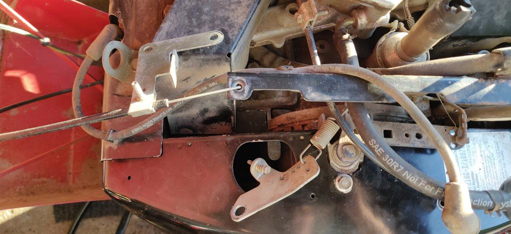

CountryRock 199 #1 Posted August 31, 2019 I took the shroud off the 416 engine and now I can't figure out how the throttle linkage goes back together. Please help. Share this post Link to post Share on other sites
lynnmor 8,915 #2 Posted August 31, 2019 Page 7-6 in the manual shows the parts. You have the side pull governor. Share this post Link to post Share on other sites
CountryRock 199 #3 Posted September 1, 2019 43 minutes ago, lynnmor said: Page 7-6 in the manual shows the parts. You have the side pull governor. Thanks. I figured it out while waiting for a reply. Had to give it a rest for the night before I ended up smashing something in anger. Share this post Link to post Share on other sites
cleat 9,056 #4 Posted September 1, 2019 I never unbolt what you did to pull the shroud off. Just disconnect the cable and unhook the spring. Cleat Share this post Link to post Share on other sites
