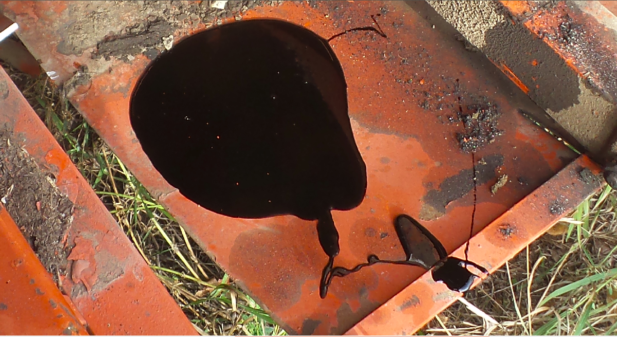

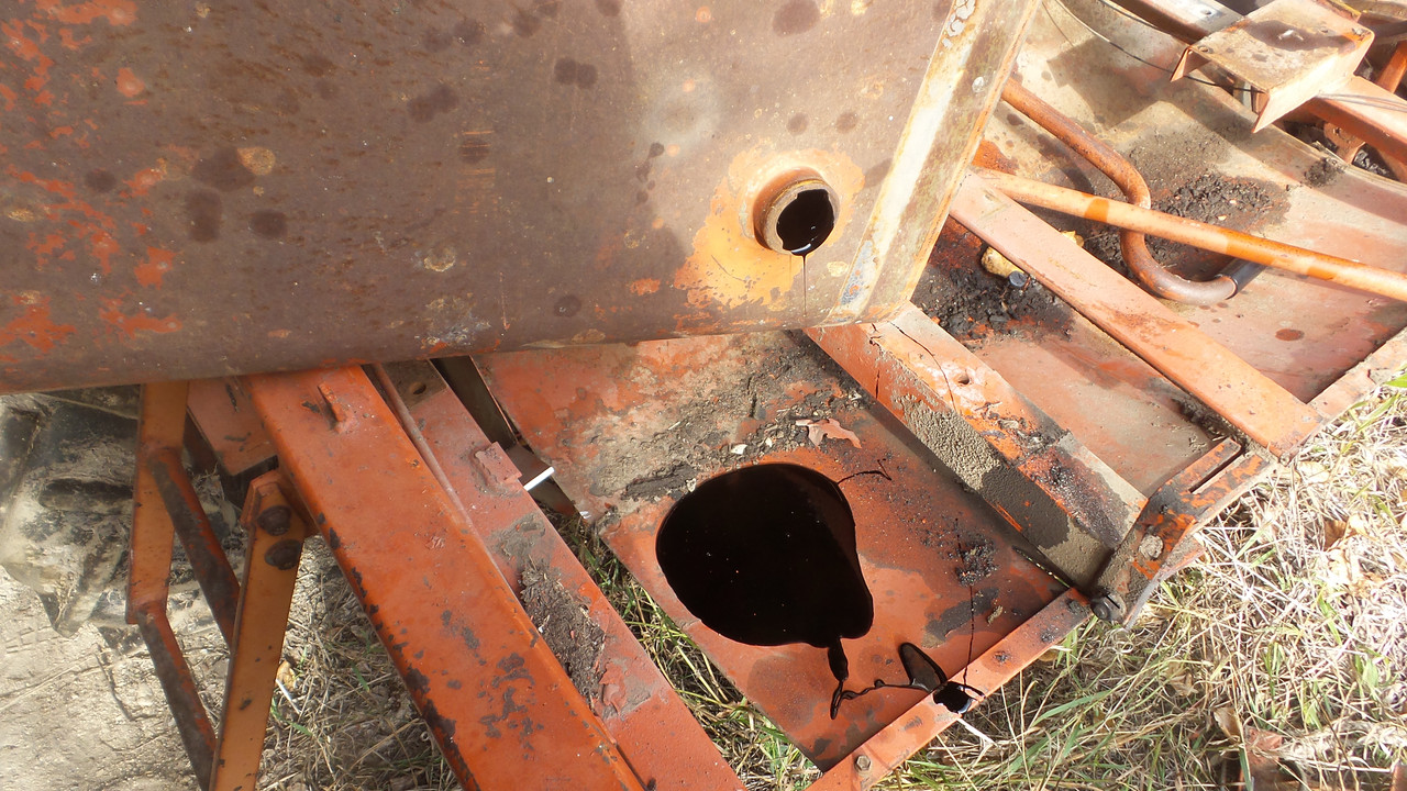

bc.gold 3,406 #51 Posted September 27, 2019 The gasoline in the tank is so old that it turned back into tar. Share this post Link to post Share on other sites
ebinmaine 81,003 #52 Posted September 27, 2019 WOW 1 Share this post Link to post Share on other sites

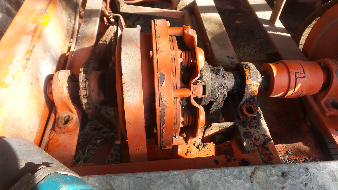

bc.gold 3,406 #53 Posted September 27, 2019 I salvaged a pair of these clutch packs, some pillow block bearings along with two love joy couplings. 2 Share this post Link to post Share on other sites

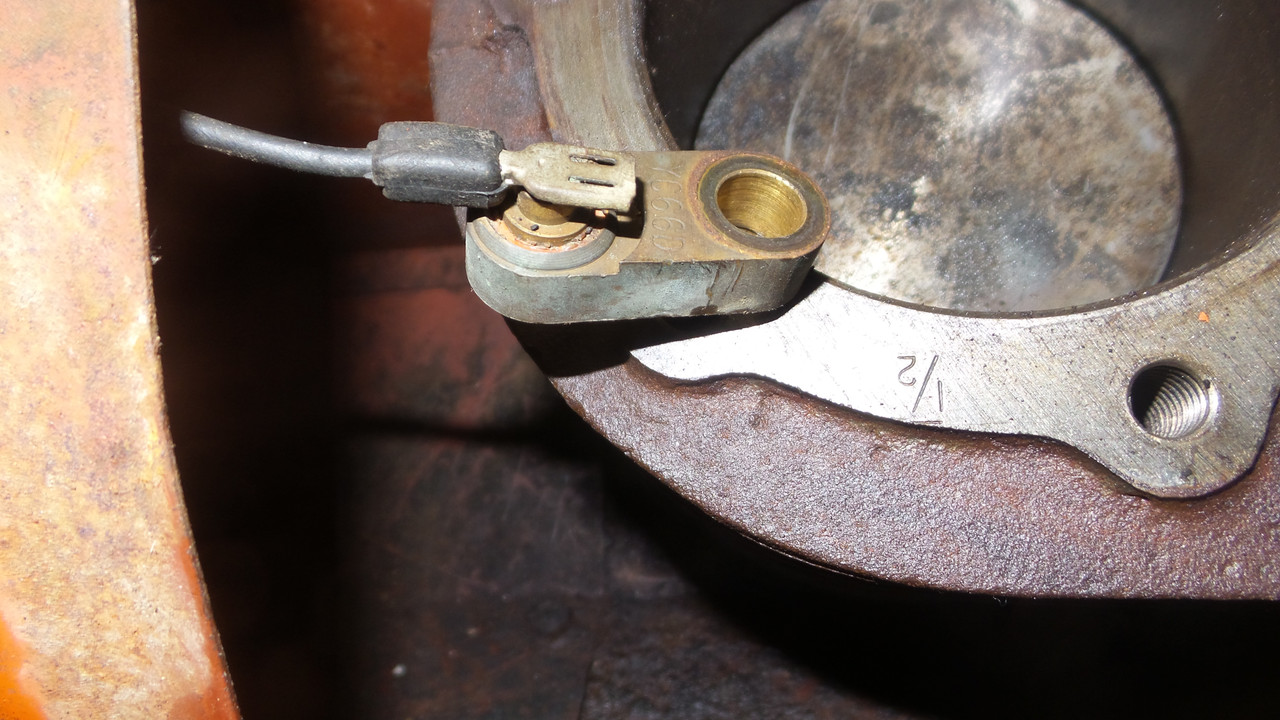

bc.gold 3,406 #55 Posted September 28, 2019 (edited) When I removed the cylinder heads this brass thing secured by a head bolt got my curiosity. HIGH TEMPERATURE SAFETY SWITCH SYSTEM As a safety precaution against overheating,engines can be equipped with a high temperature switch mounted to the cylinder head at the No. 2 spark plug. When cylinder head temperature becomes critically high, the safety switch will automatically stop the engine by shorting out the ignition system. A waiting period of about 15 minutes will be required before the switch has cooled off sufficiently to re-start the engine. An overheated engine will score the cylinder walls, burm out connecting rod and crankshaft bearings, also warp pistons and valves. The cause of the overheating condition will have to be remedied before the engine is re-started. Edited September 28, 2019 by bcgold 3 Share this post Link to post Share on other sites

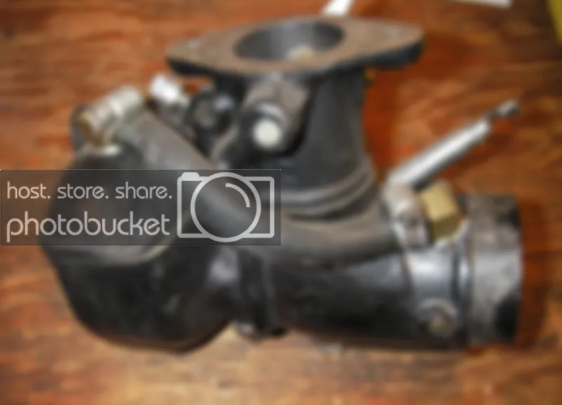

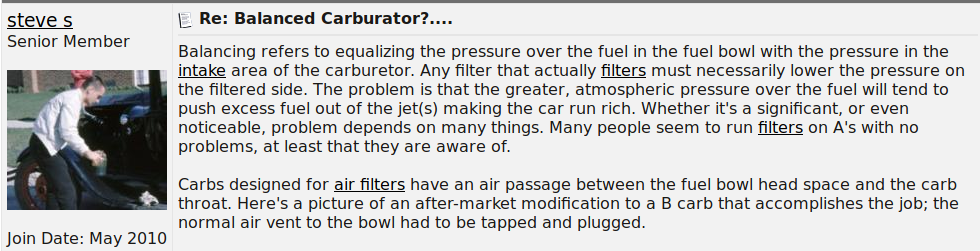

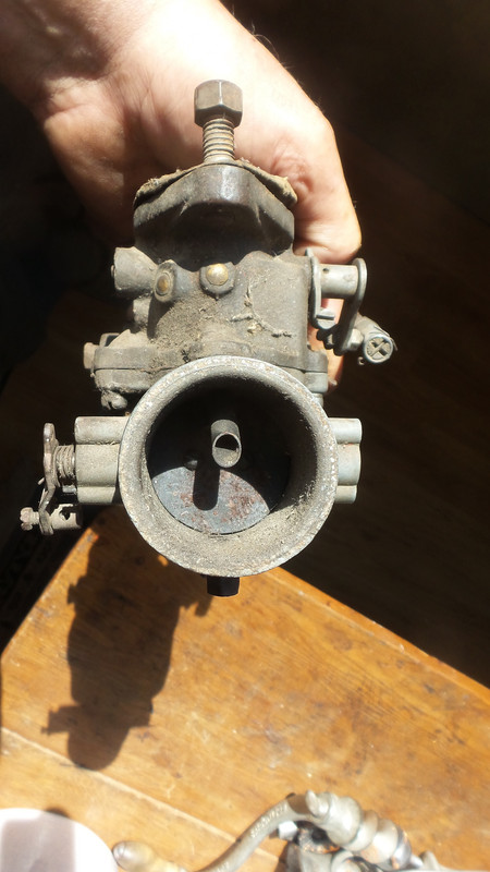

bc.gold 3,406 #57 Posted September 28, 2019 My Wisconsin VG4D uses a Zenith carburetor that is balanced, a bit of research informs me that a balanced carburetor is intended to be fitted to an engine operating in extreme conditions. How it works, as the air filter conditions change with use a normal carburetor draws in a more rich fuel mixture, poor engine performance with increased fuel use. Any carburetor using a float bowel maybe modified. Credits belong to Steve S 1 Share this post Link to post Share on other sites
bc.gold 3,406 #58 Posted September 28, 2019 How to tell if you have a balanced carburetor. Share this post Link to post Share on other sites

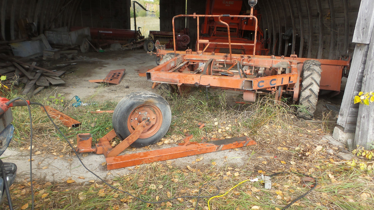

bc.gold 3,406 #60 Posted September 28, 2019 Just figured out how they got reverse gear on the swather, the friction disk is enganged either direction only released when turning or a steering correction is needed to maintain a straight line. The drum with the brake band when the brake is applied a set of planetary gears inside the drum give the swather reverse. I can see a new project coming up, we could use a new water well and this reversing drum will freewheel when the friction band is released. Make a nice pile driver for a cable drilling rig. 1 Share this post Link to post Share on other sites

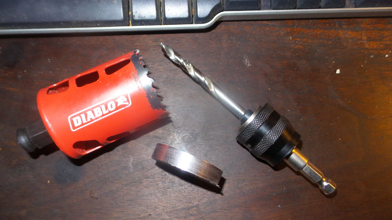

bc.gold 3,406 #69 Posted February 22, 2020 Bought this hole saw to cut in holes for the boiler tubes to make that steam needed for the essential oil project, I'm impressed. Share this post Link to post Share on other sites

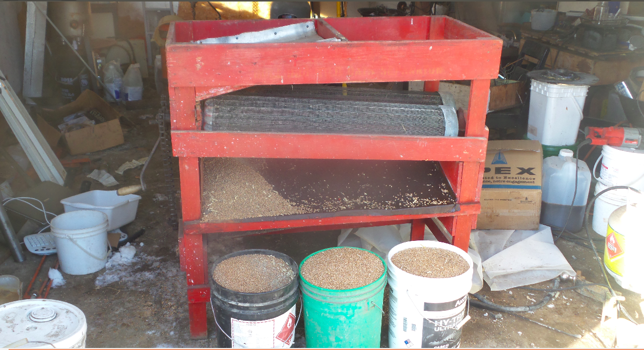

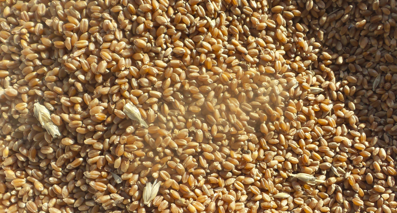

bc.gold 3,406 #72 Posted February 29, 2020 Non GMO wheat from Vern's Ag seed cleaning plant, this is what has leaked from the shaker tables onto the floor, spillage gets swept into an auger installed in the floor to be reclaimed. I was gifted three pails, some chaff with a bit of dust, I'll pass this through my grain cleaner. I'll be doing about a dozen quart canning jars, each jar filled two thirds full. There will be plenty for my own used then some to gift friends. The grain is first soaked in water overnight, jars filled, lid set loosely then pressure cooked for about an hour, once the gran has cooled down it can be inoculated. Close lid tightly, make sure there's a breather hole and this is filled with upholstery batting it looks like cotton. Set your jars in a dark room then in a couple of weeks you'll see that the mycelium has fully grown within the grain kernels. This is used to inoculate your sterilized wood chips, sawdust or straw. I suggest watching a few utube videos growing mushrooms in a bucket. to get a better grasp on growing your own mushrooms. Share this post Link to post Share on other sites
