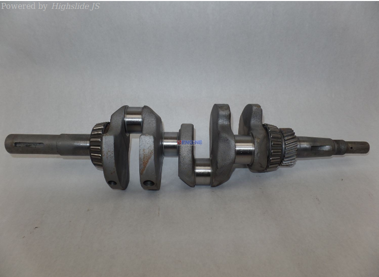

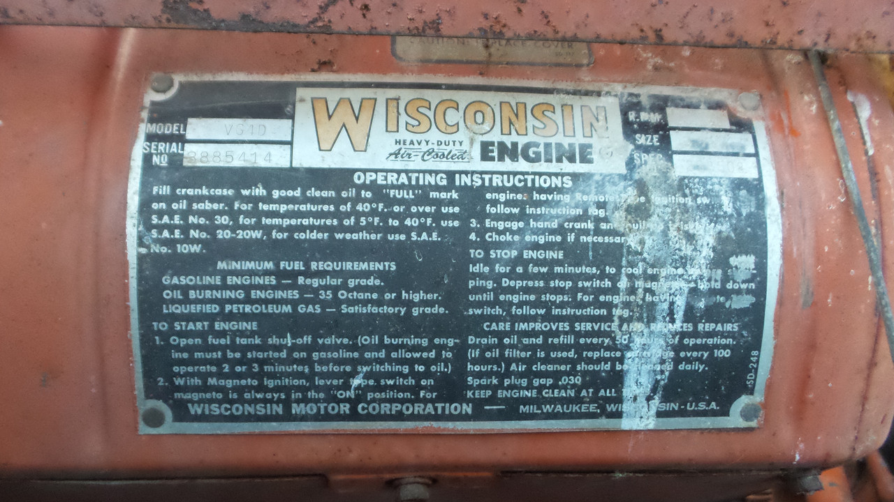

bc.gold 3,406 #32 Posted September 17, 2019 Cool the distributor is attached to the back end of the generator which appears to be gear driven. The presence of an oil filter tells me the engine has a pressurized oil system. If memory serves me the crankshaft rides on Timken taper roller bearings with the connecting rods using shells. The 1 Share this post Link to post Share on other sites

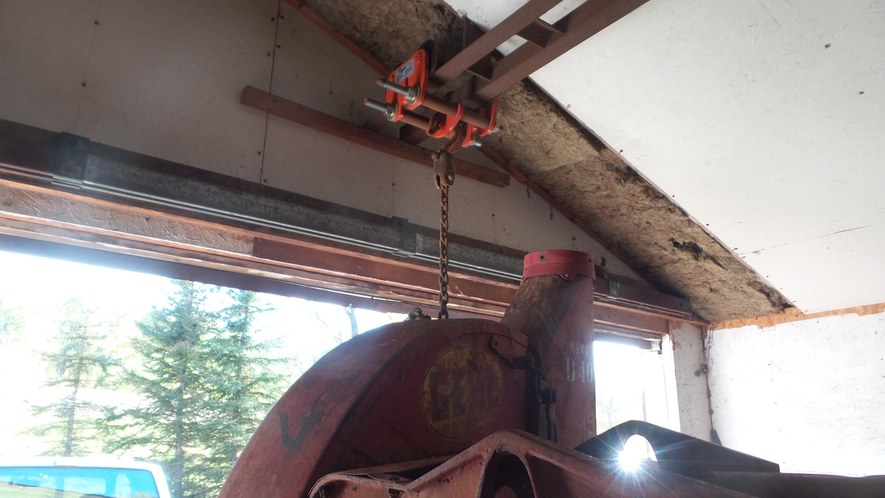

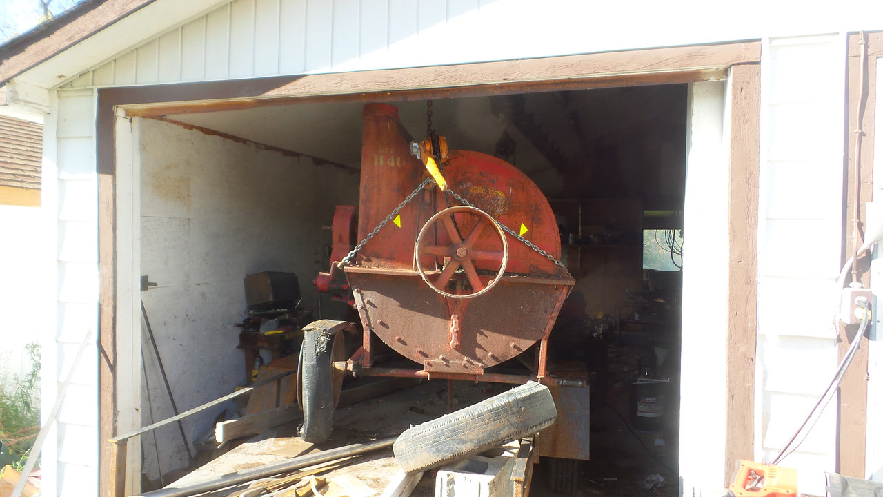

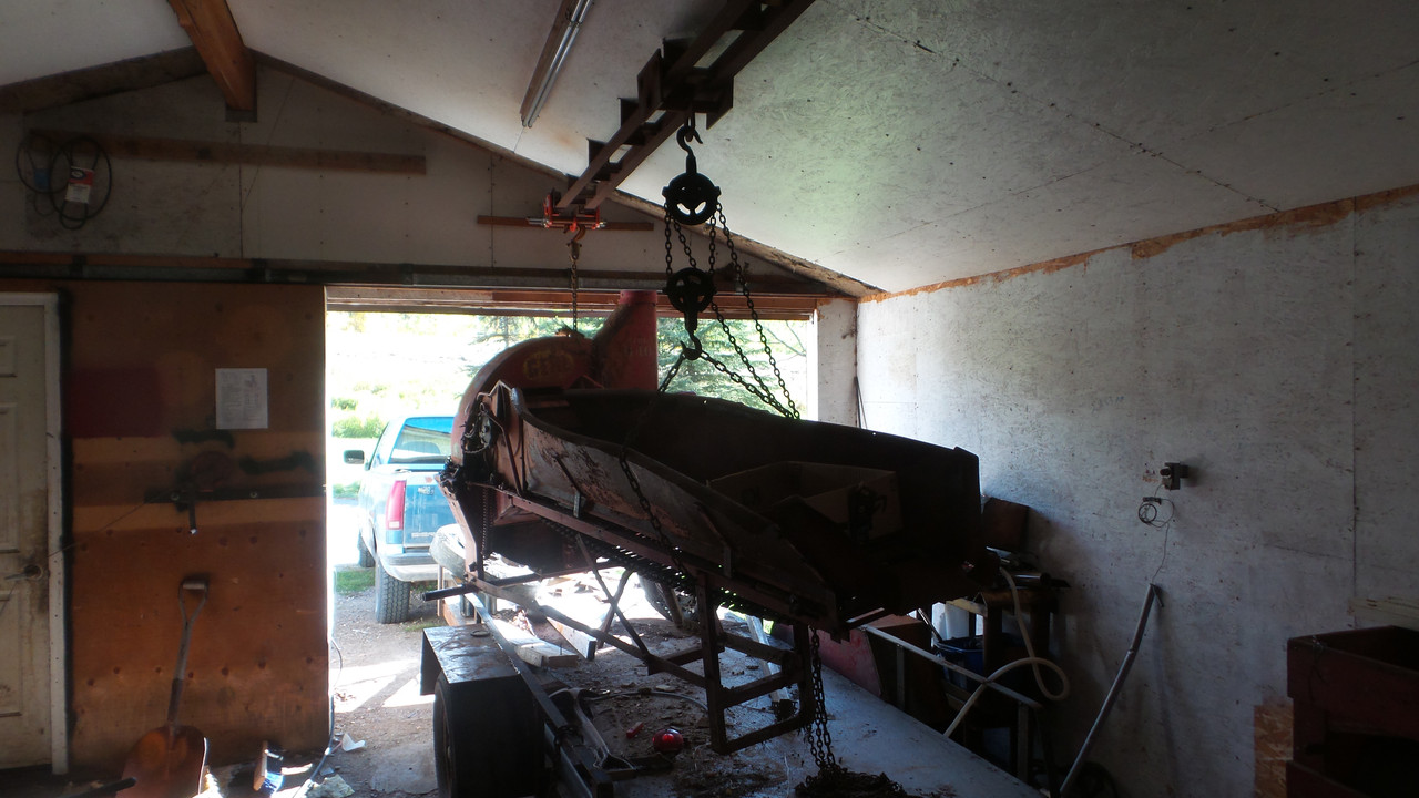

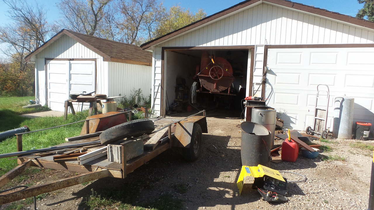

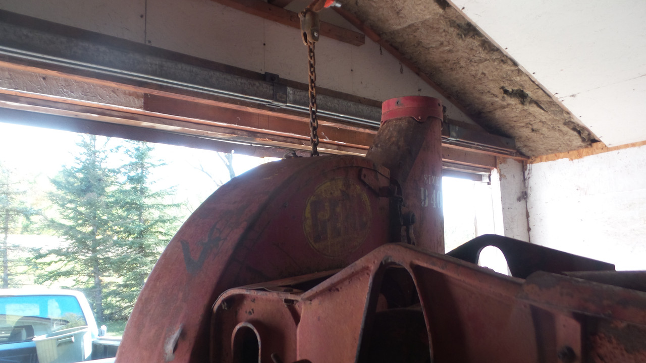

bc.gold 3,406 #38 Posted September 19, 2019 (edited) Taking the silage chopper off the trailer as I'll be needing it to haul home the Wisconsin engine and bits n pieces off that old swather. While its in the shop weld that broken tow hitch back on, maybe scare up a few tires. Notice the rail for the sliding door is inside the building, don't have to shovel snow to get the snow blower out. The garage door on the right hand side is just filling the hole, framed and insulated on the inside Edited September 19, 2019 by bcgold 2 Share this post Link to post Share on other sites

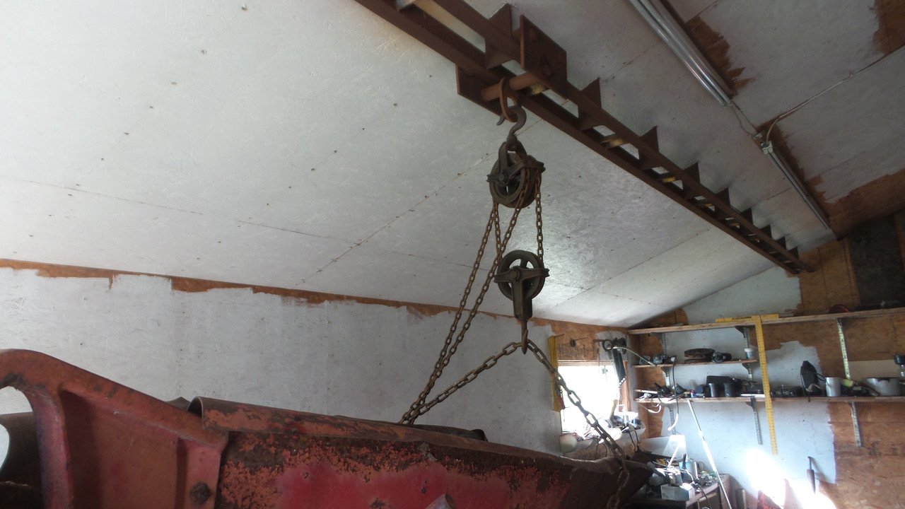

bc.gold 3,406 #39 Posted September 19, 2019 The overhead rail is made from 1/4" angle iron the spacers also serve as hangers, one trolly is a manufactured unit and the one with the chain falls is one I made from wheels that came from an overhead chain conveyor discarded from the hog plant. Jack the owner of one of the scrap yards I dealt with would let me pick goodies from incoming scrap, yesterday was a sad day for me as I had just learned that the yard has a new owner. Jack has retired. Share this post Link to post Share on other sites

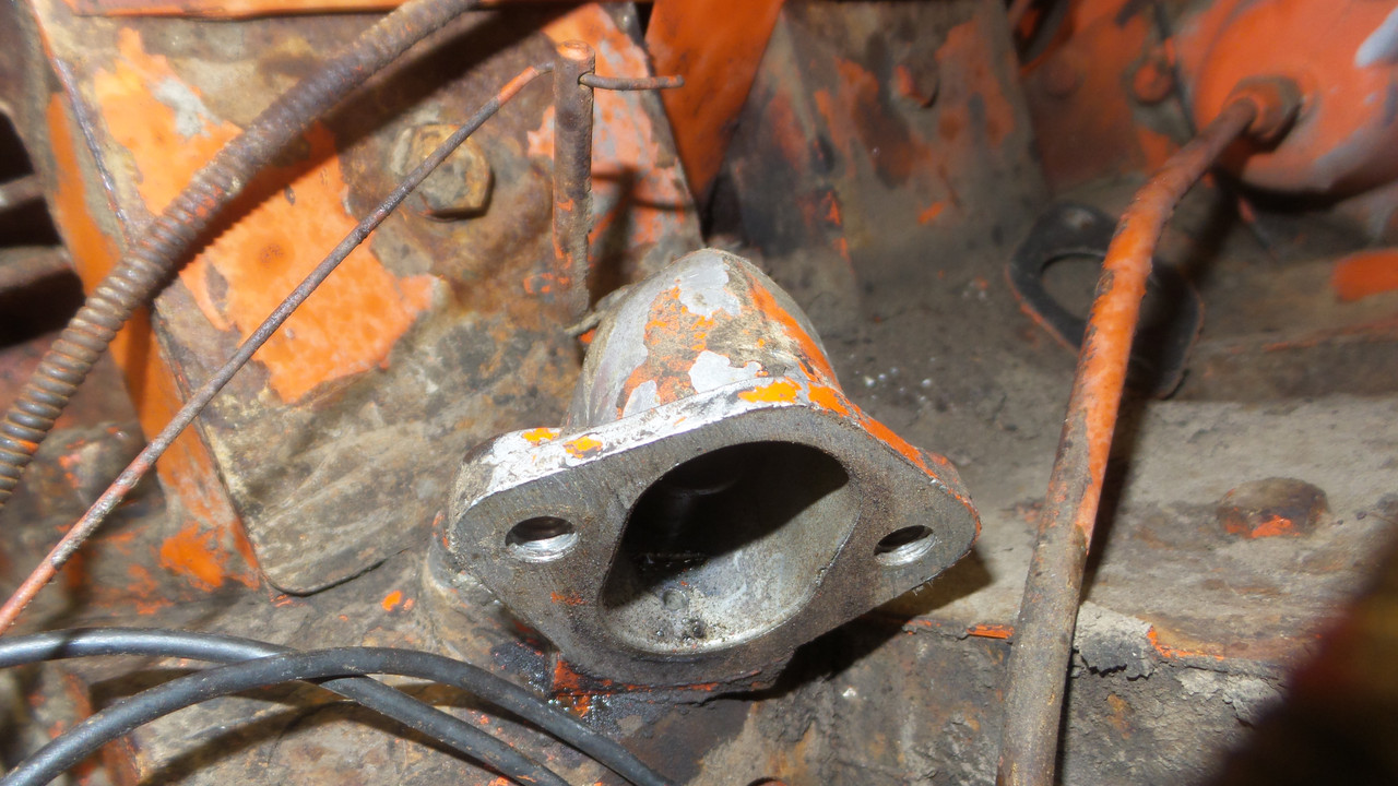

bc.gold 3,406 #40 Posted September 21, 2019 It was another interesting day, I never did make out to the farm where I was supposed to get that Wisconsin carburetor, but came home with one just the same and met a new neighbor who has the time to waste chewing the fat. 1 Share this post Link to post Share on other sites

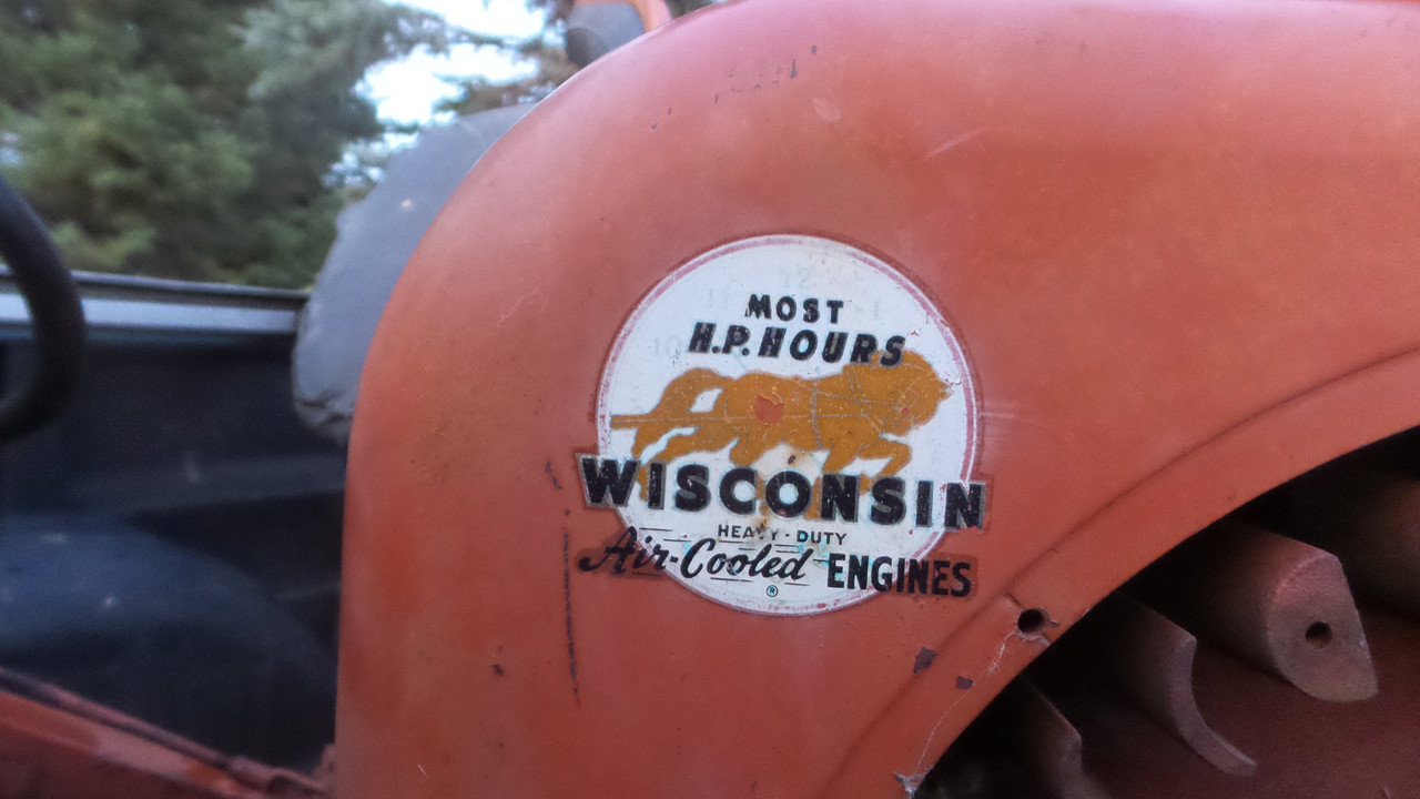

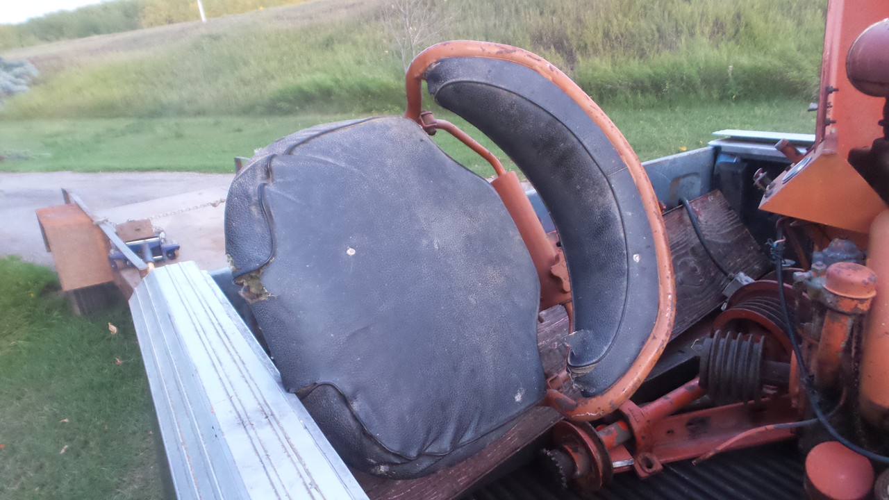

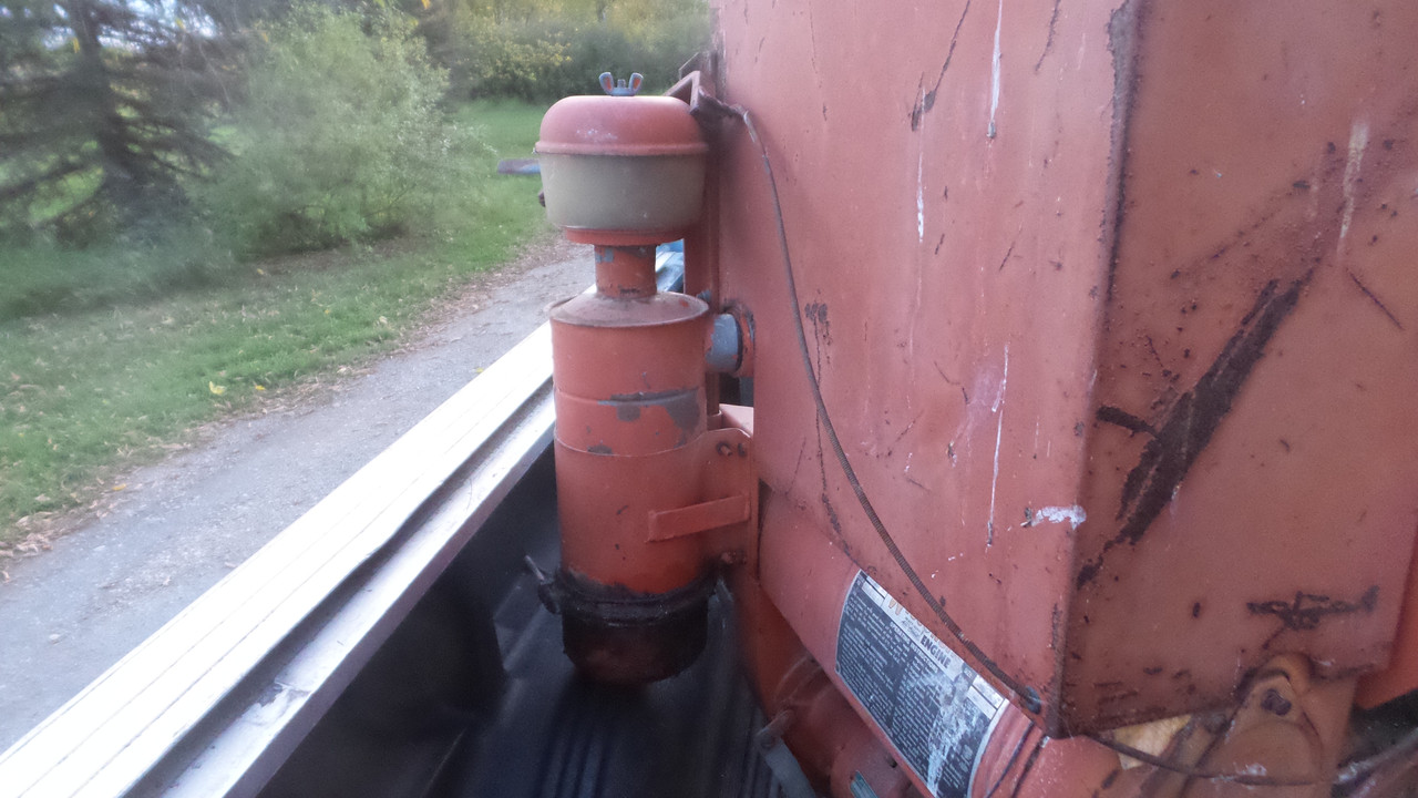

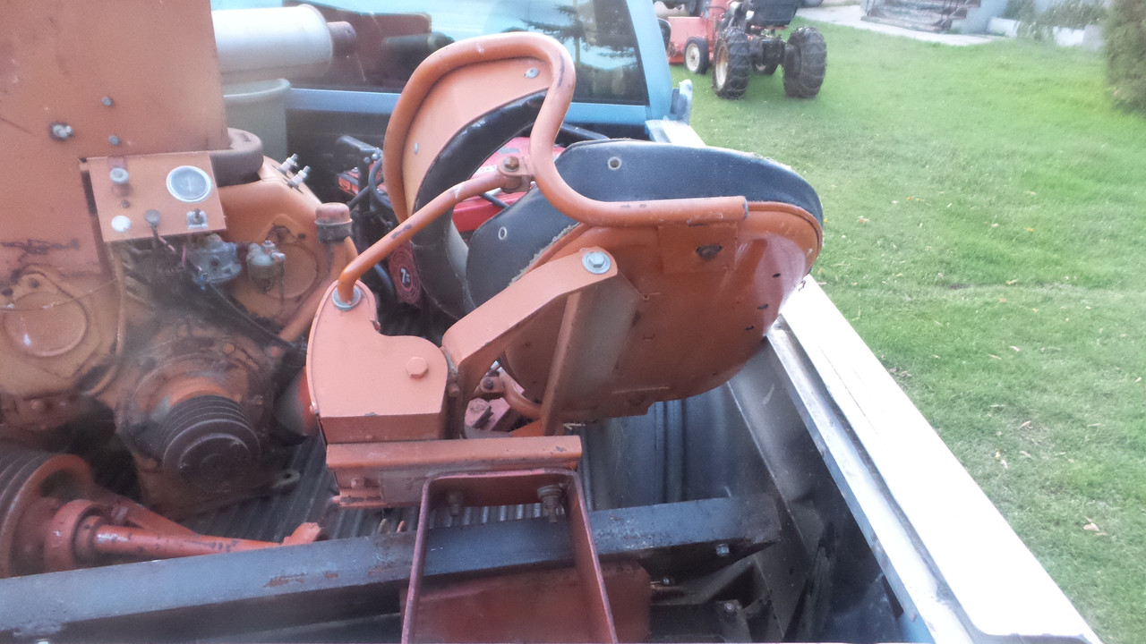

bc.gold 3,406 #41 Posted September 24, 2019 Spent a few hours today dismantling the swather, the engine is a heavy beast but I did manage to get her into the back of the truck by sliding it down a plank. And the seat I'm guessing weighs well over 100 pounds. The final drive is chain, and the steering clutches are interesting, when one of the two steering levers is pulled a fraction the friction disk is released pull the steering lever further back the brake is applied. The swather could turn on a dime. A nice hydraulic pump and four cylinders, two lovejoy couplings lots of pillow block bearings, sprockets and v-belt pulleys a nice sheet of 1/4" checker plate. The pair of AG drive tires are in perfect condition although much to large for anything I currently own. 1 Share this post Link to post Share on other sites
bc.gold 3,406 #42 Posted September 24, 2019 (edited) The VG4D is an older model engine made during the 1950's, the D after the model specifies stellight valve seats making this engine propane ready. Model AENLD Model THD Model VH4D Model W4-1770 Model VG4D Model V465D Cylinder 1 2 4 4 4 4 Bore (in. /mm) 3.00/76 3.25/83 3.25/83 3.25/83 3.50/89 3.75/95 Stroke (in. /mm) 3.25/83 3.25/83 3.25/83 3.25/83 4.0/102 4.00/102 Displacement (cu. in. /cc) 23/377 54/883 108/1765 108/1765 154/2524 177/2901 HP @ 1500 4.3 9.1 18.7 19.7 27.0 38.0 HP @ 1800 5.4 11.7 22.5 24.2 32.0 47.5 HP @ 2000 6.1 13.1 24.7 27.1 34.0 52.4 HP @ 2200 6.8 14.2 26.5 29.6 36.0 56.7 HP @ 2400 7.4 15.2 28.0 32.0 37.0 60.0 HP @ 2600 7.9 16.4 29.2 33.6 63.0 HP @ 2800 8.5 17.0 30.0 34.6 64.5 HP @ 3000 8.9 17.5 35.0 65.9 HP @ 3200 9.2 18.0 HP @ 3400 9.2 18.2 HP @ 3600 9.2 18.2 Torque (Ft-Ibs@RPM) 16@2200 34@2000 66@1800 71@2000 95@1600 139@1800 Weight- in Ibs 110 220 310 330 410 530 Dimensions (L" x W" x H") 18 x 22 x 19 19 x 23 x 26 27 x 28 x 26 30 x 26 x 28 28 x 31 x 29 34 x 28 x 36 Edited September 24, 2019 by bcgold Share this post Link to post Share on other sites

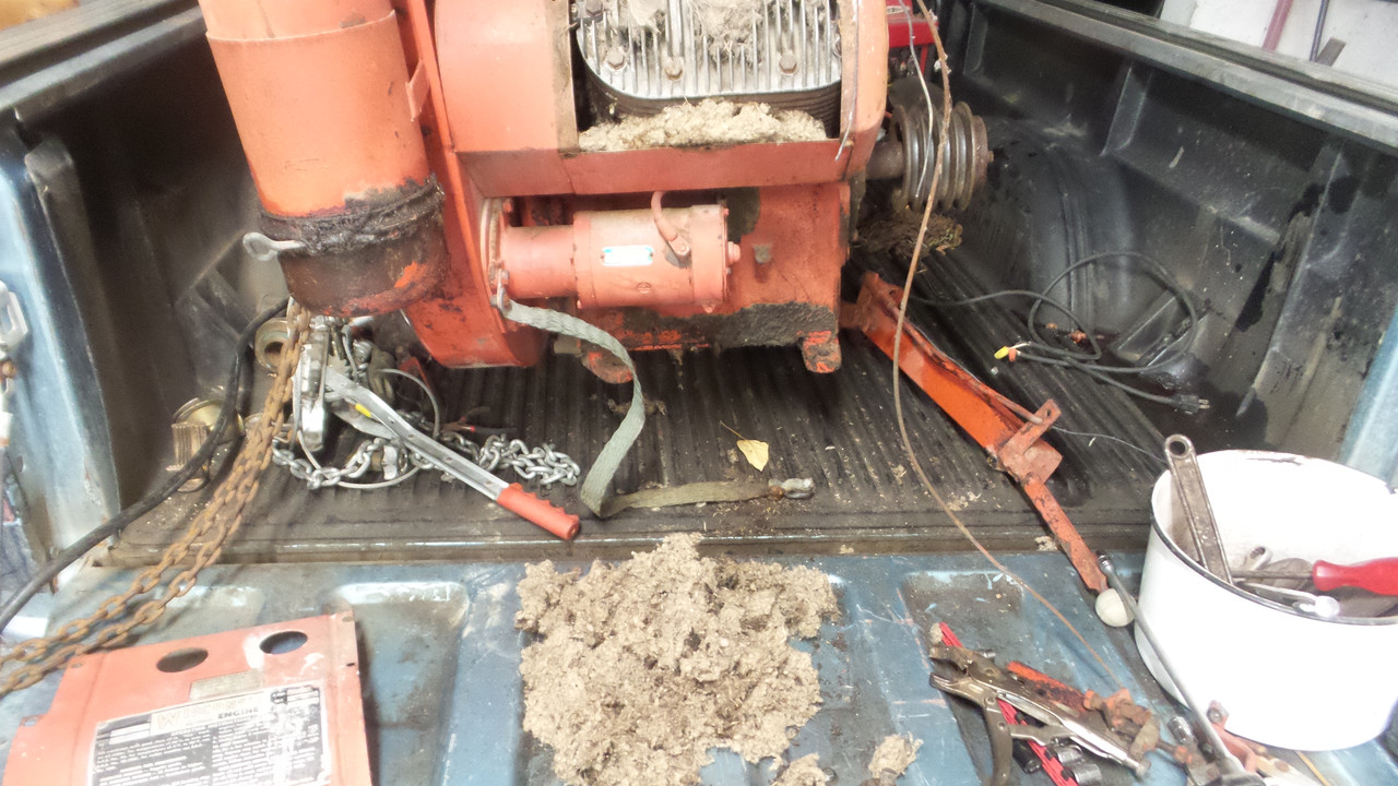

bc.gold 3,406 #44 Posted September 25, 2019 This is the nest from the Wisconsin still have to clean out the other side. 1 Share this post Link to post Share on other sites
bc.gold 3,406 #45 Posted September 26, 2019 (edited) An update on the Wisconsin, underneath the nest a thick layer of urine soaked poop turned to a sticky mud, used a small torch to dry it out and it quickly turned to dust. It;s all been vacuumed out and is now clean as a whistle. Muffler is full of seeds I'm going to blow air through it with an adapter to fit a spark plug hole then turn the engine until an exhaust valve opens. Then do this for each firing order to clean out the exhaust manifold runners any seed left in the muffler will burn out once the engine is running. Spark plugs have not been removed in the past 20 years and are firmly stuck, now I understand why these cylinder heads show up on ebay with a hefty price tag. I'll heat the aluminum cylinder head around the spark plug, squirt a shot of penetrating oil then hit it with my pneumatic impact which has amassing ability's over using hand tools when something is stuck. Any threads that are ruined will get and insert, fortunately the head does not have to be removed to install an insert, just bring the piston to bottom dead center then stuff a shop rag into the cylinder to catch any swarf an oiled rag works best. Edited September 26, 2019 by bcgold Share this post Link to post Share on other sites

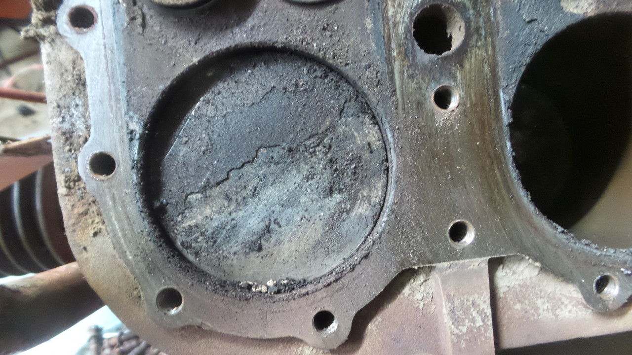

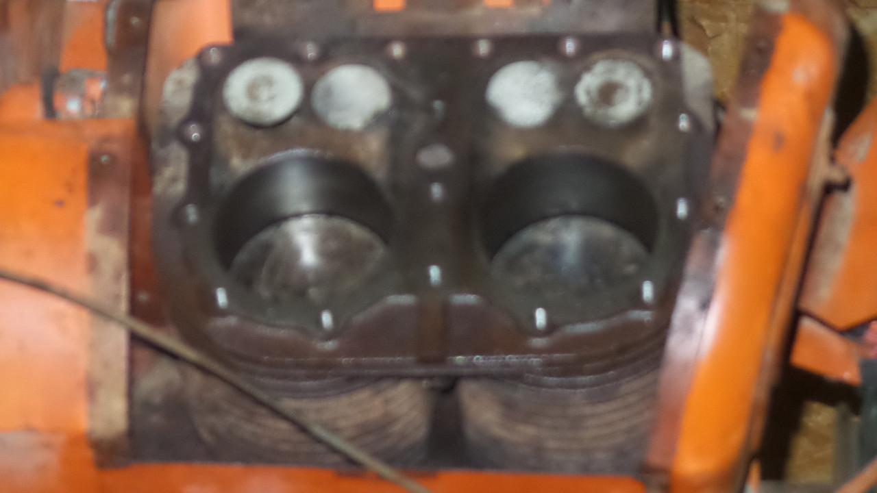

bc.gold 3,406 #47 Posted September 26, 2019 (edited) Spark plugs removed, threads saved. Engine would not turn a full 360 pulled heads off and found a pile of carbon laying on the bottom of this piston, enough that it could not compress. Never been rebuilt, considering checking the clearances on the rod bearings replace if necessary along with a new set of piston rings. Edited September 26, 2019 by bcgold 1 Share this post Link to post Share on other sites
Stormin 9,988 #48 Posted September 26, 2019 1 hour ago, bcgold said: Engine would not turn a full 360 pulled heads off and found a pile of carbon laying on the bottom of this piston, enough that it could not compress. I hope what I'm thinking has not happened, but can you push that piston down by hand? Share this post Link to post Share on other sites
bc.gold 3,406 #49 Posted September 26, 2019 1 hour ago, Stormin said: I hope what I'm thinking has not happened, but can you push that piston down by hand? Just some loose carbon that fell free from the cylinder head that had settled to the lower side of the piston, this is a V configured engine and the pile of carbon was enough to stop the engine from making a full revolution. With the amount of accumulated carbon in each cylinder it would be my guess she's an oil burner and could use a new set of rings. With winter just around the corner it's time to shelve this project and do a tune up on my trusty Onan, it generally snows on pr before the end of October. 1 Share this post Link to post Share on other sites

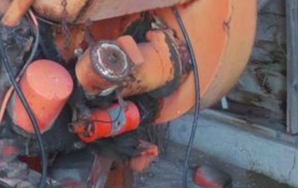

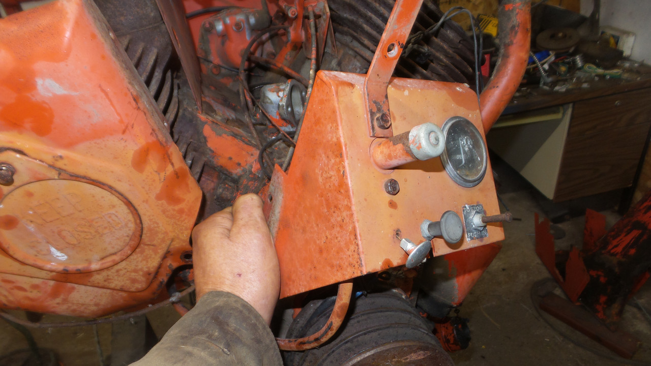

bc.gold 3,406 #50 Posted September 27, 2019 (edited) Turns out the carbon on the piston surfaces and valves is a nice tan color that was blackened on her last run by running a rich fuel mixture. Recently there was a discussion on the primer lever on some fuel pumps, the engineers that designed the Wisconsin engine took it a step further by incorporating the priming lever into the base that the fuel pump bolts onto. The shiny knob on the control panel has a wire for operator convenience leading to the primer lever. Edited September 27, 2019 by bcgold 1 Share this post Link to post Share on other sites
