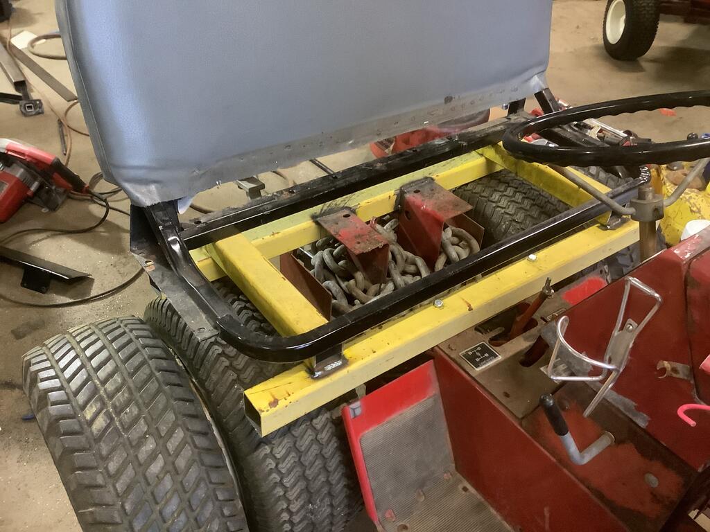

Pullstart 71,478 #127 Posted October 7, 2022 This aughtta work! I tell you what, those seats are NOT easy to pull when they BOLT ‘em through the floor! 3 Share this post Link to post Share on other sites

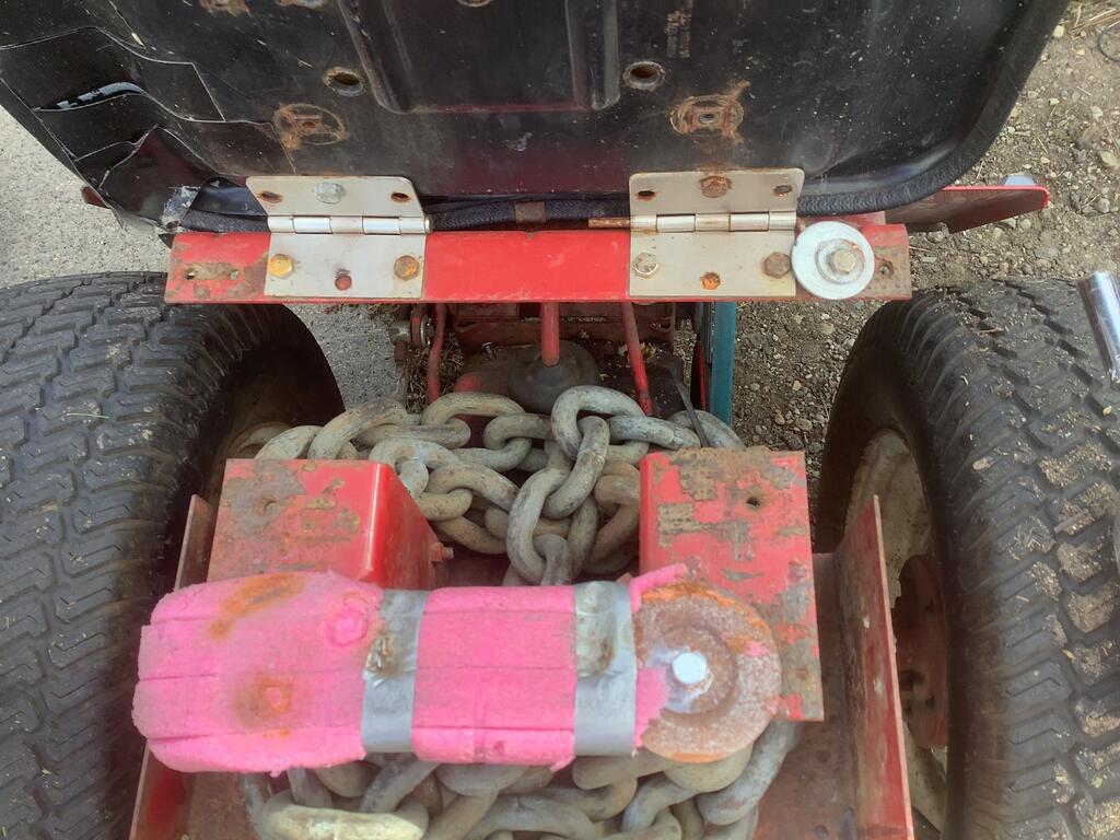

Pullstart 71,478 #128 Posted October 7, 2022 The things you really appreciate after a couple years of ownership… hold downs that keep an Allen wrench in place… when used as hinge pins! 2 Share this post Link to post Share on other sites

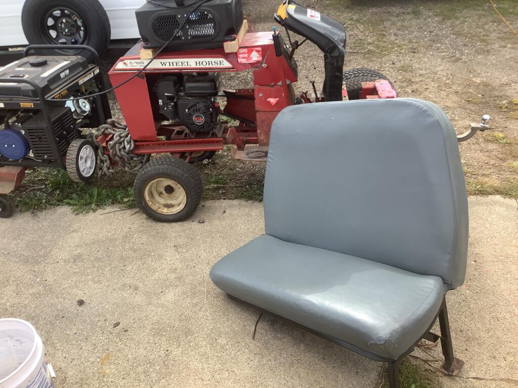

Pullstart 71,478 #132 Posted October 7, 2022 2 hours ago, SylvanLakeWH said: Use what ya got…!!! well, time to see what I got to mount this bus seat! 1 Share this post Link to post Share on other sites
Pullstart 71,478 #133 Posted October 7, 2022 @Achto we both got sexy bench seats! This one was from the back of the bus. It’s hard saying how many shenanigans happened there… but only two wads of gum stuck… 1 1 3 Share this post Link to post Share on other sites

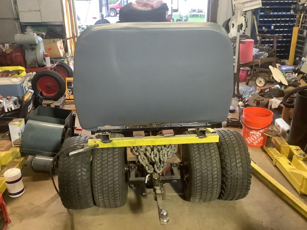

Pullstart 71,478 #137 Posted May 17, 2023 @squonk exactly what you were thinking, right? Not quite enough butt in the tractor! 2 Share this post Link to post Share on other sites
Pullstart 71,478 #138 Posted May 17, 2023 That’s better! 1 Share this post Link to post Share on other sites

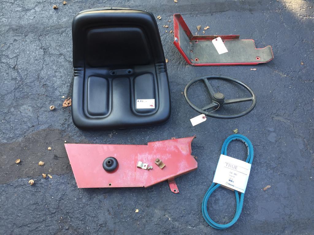

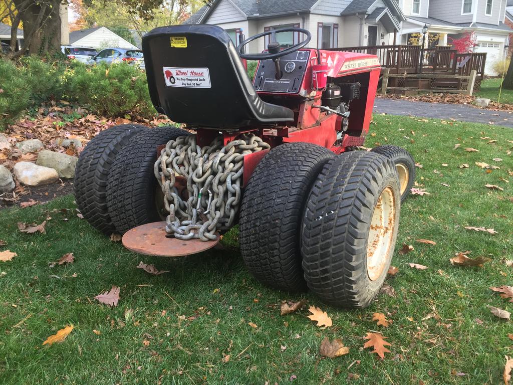

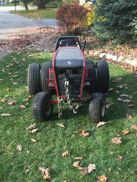

Pullstart 71,478 #142 Posted July 6, 2023 On 11/3/2019 at 5:45 AM, SylvanLakeWH said: Well here she is... I like it! Ended up swapping the new rear tires on this one with my other C 105 due to height difference to get the duallys to ride even.... almost1.5 inches! So the worker gets the new rubber and the WHrat WHrecker gets the old stuff... as it should be! Will be swapping fronts too when I get a chance. Not sure on paint for spacers yet. No paint was sacrificed in the making of this beauty. Not sure I want to break with that standard... Agree though it would look cool! Appreciate everyone’s input. A lot of good advice and expertise!!! Rides quite nice! It’s been a day or two. Couple questions…. Do you have a note on which belt you used? It’s pretty worn and needs replacing soon. We slip the belt a lot! Do you know if your other black hood creation GT6.5 has the same belt? 1 Share this post Link to post Share on other sites
SylvanLakeWH 32,753 #143 Posted July 6, 2023 I do not have any notes, but i am pretty sure I used stock size belts. Previous post pic shows stens true blue belt from az and i think it says 82"...? Both builds would be exactly the same for the predator swaps... 1 Share this post Link to post Share on other sites
Pullstart 71,478 #144 Posted July 6, 2023 Surely they are different size, both length and girth Share this post Link to post Share on other sites
SylvanLakeWH 32,753 #145 Posted July 6, 2023 Hhhmmm... maybe i only replaced one??? I can't remember... sorry. I do know i tried to get the pulley location the same... 1 Share this post Link to post Share on other sites

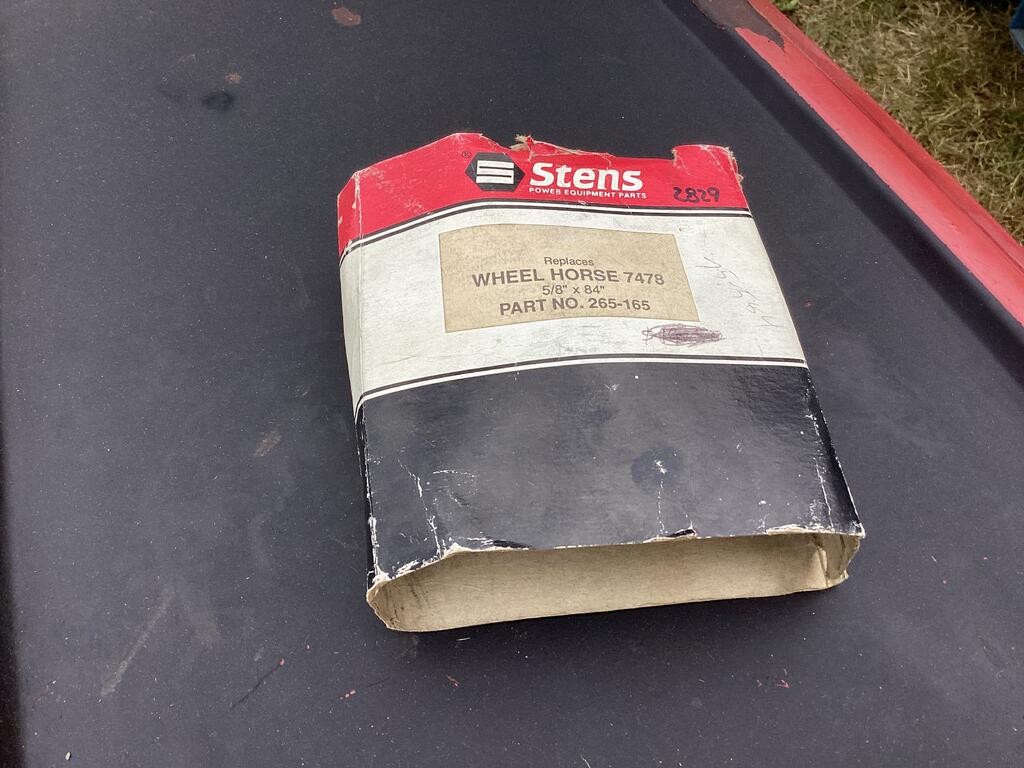

Pullstart 71,478 #147 Posted July 7, 2023 For record keeping purpose… 5/8 x 82” would not fit the engine and trans pulleys alone, excluding the clutch. I found this 5/8x84 belt in the flea market and it flops around a bit, but does the job great. I’d imagine an 83” belt would be sweet. 1 Share this post Link to post Share on other sites
