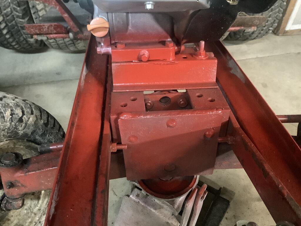

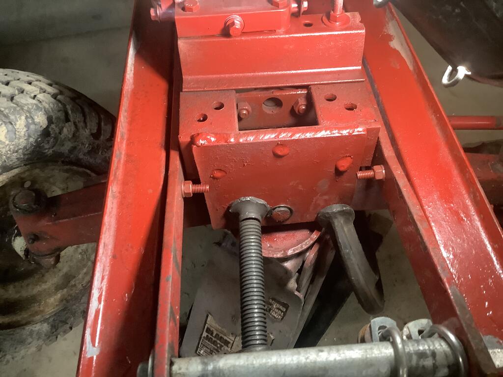

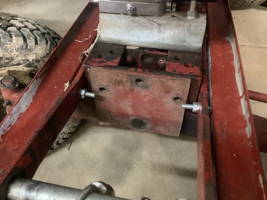

Pullstart 71,478 #103 Posted March 9, 2021 A little site prep... I decided in the nature of this build to rather than find the correct bolts, do something a bit different. I drilled out the holes and will plug weld them, along with a bead up top. 2 Share this post Link to post Share on other sites
Pullstart 71,478 #104 Posted March 9, 2021 A tack aughtta take care of that problem! A bit of Regal Red to pass this as authentic... 2 Share this post Link to post Share on other sites

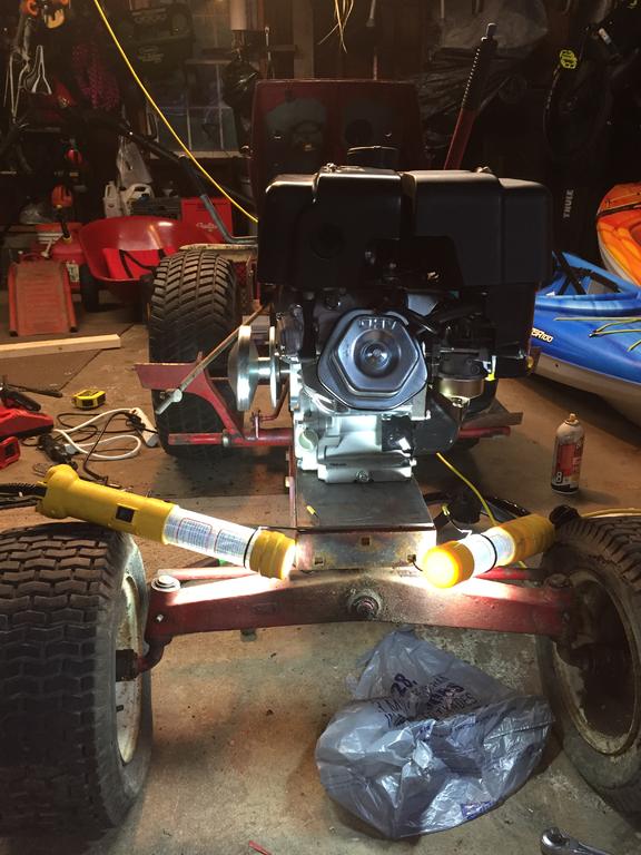

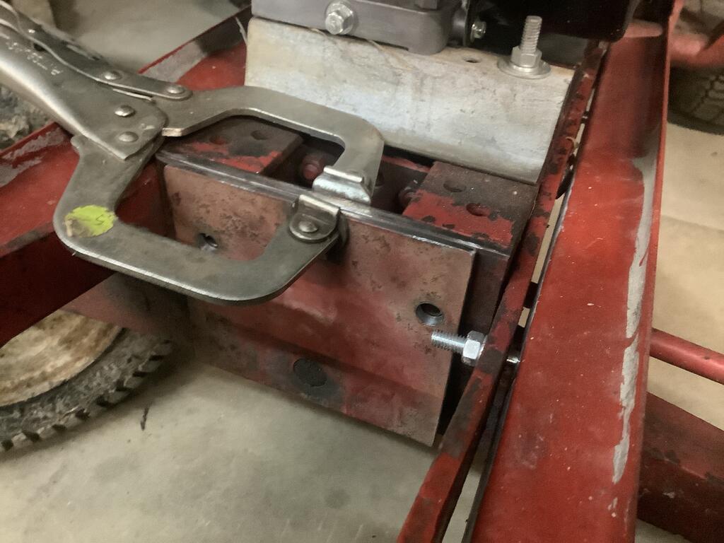

Pullstart 71,478 #105 Posted March 9, 2021 The back plate had bent a tad, but some c clamp pressure and the clip is in the right place! 2 Share this post Link to post Share on other sites

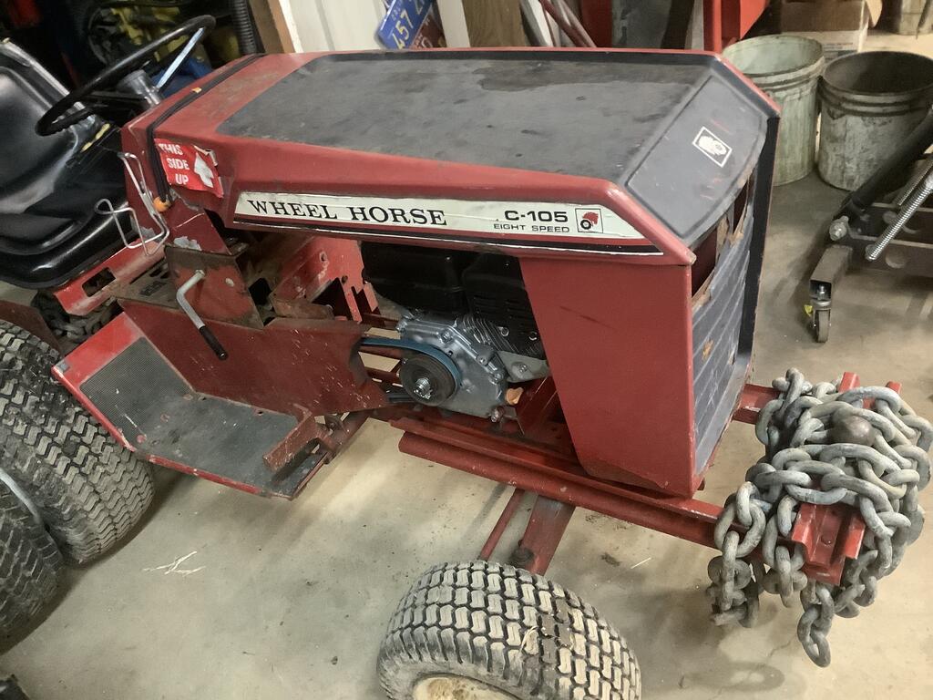

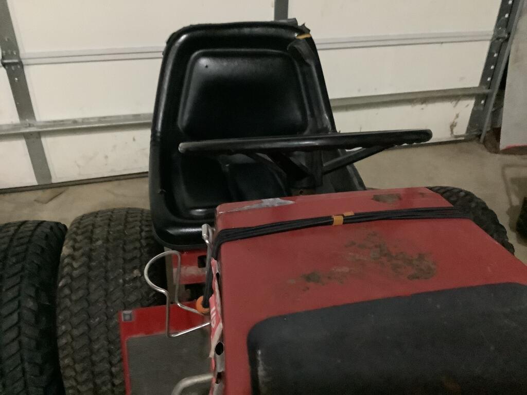

Pullstart 71,478 #106 Posted March 9, 2021 Gassed up, fixed up, hood on, hubs sinched up, ready to rock n roll! 2 Share this post Link to post Share on other sites
SylvanLakeWH 32,753 #108 Posted March 9, 2021 (edited) She looks right at home...! And thank you for not using the correct bolts... don’t want to compromise the integrity of the build...! Edited March 9, 2021 by SylvanLakeWH 1 1 Share this post Link to post Share on other sites

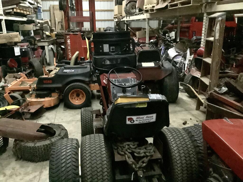

Pullstart 71,478 #110 Posted October 6, 2021 As mentioned today in this fun thread… the WHRat fell off the wheel… or maybe the wheel fell off the WHRat! In true Rat Fink form, I think I may have found a replacement… 2 Share this post Link to post Share on other sites

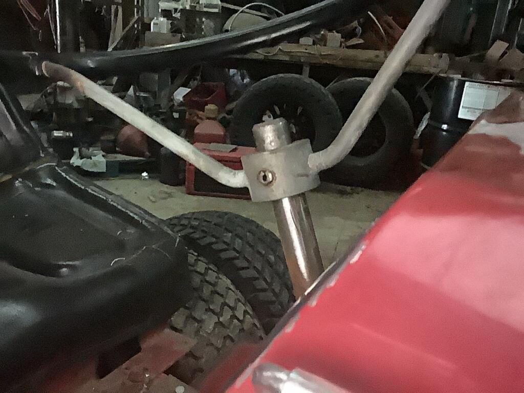

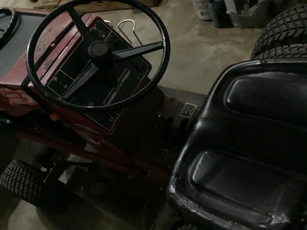

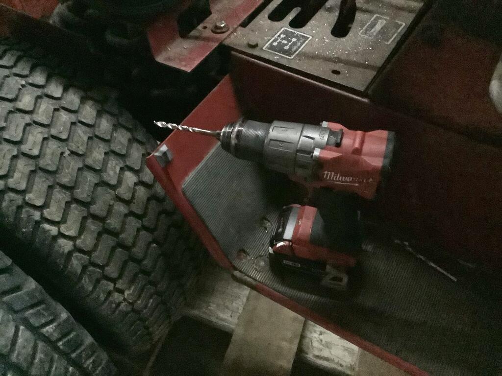

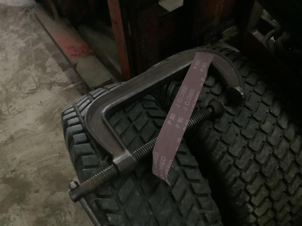

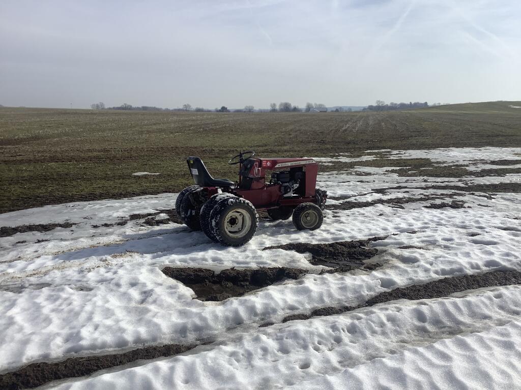

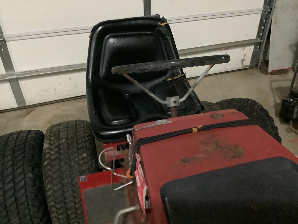

Pullstart 71,478 #112 Posted July 5, 2022 Last year the WHRat was parked up high. Not much a winter rig. One of the last times riding, the retaining bolt holding the steering wheel through the steering shaft came out, leaving me to find a way home with a sleeping babe on my lap. I ended up using leverage to pinch the wheel on the shaft for the last 1/2 mile or so. I never realized, there’s a broken roll pin in the existing hole. Today, I used a drill, some emory paper and a c-clamp to get the new wheel pinned in place for good! A couple yanks of the @Pullstart and the WHRat was awake from winter’s nap. He must be a millennial, he slept until July! 1 Share this post Link to post Share on other sites

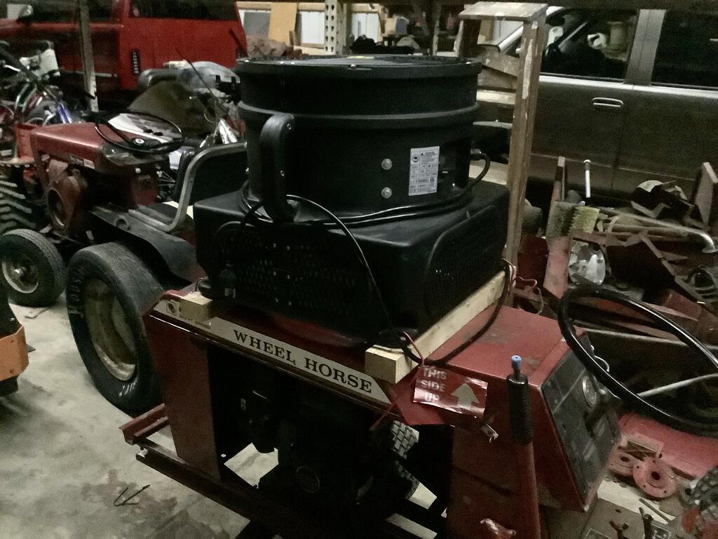

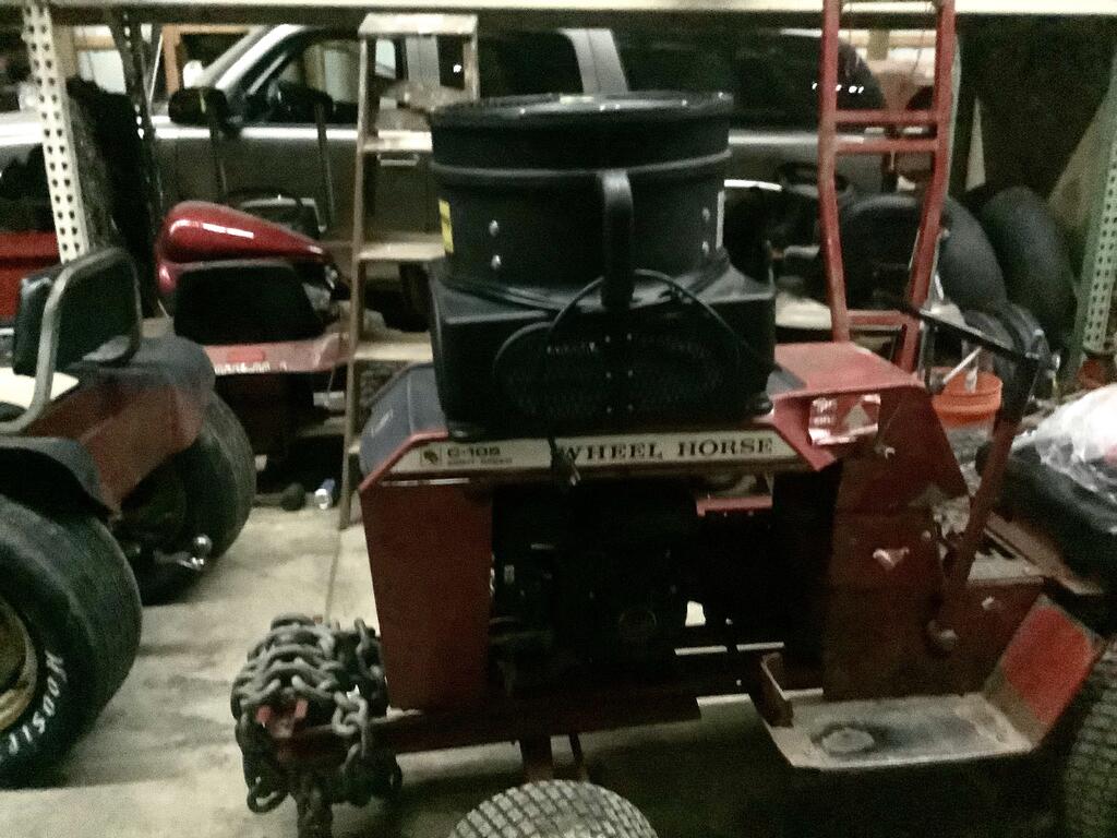

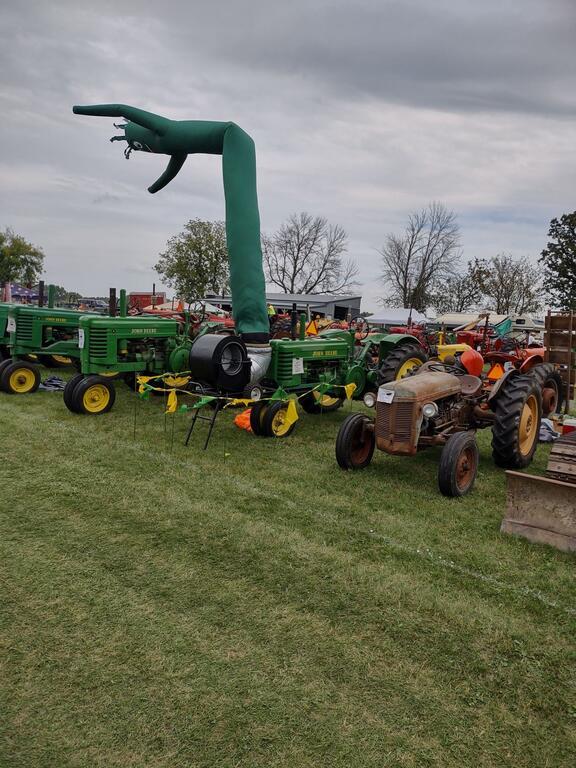

Pullstart 71,478 #115 Posted October 6, 2022 I do believe, the WHRat needs to be a bench seater… The initial idea was to mount a blower squirrel cage to the front of a Horse. For now, we might just go with Snooter’s own blower and a generator to power him! 2 Share this post Link to post Share on other sites
Pullstart 71,478 #116 Posted October 7, 2022 Wood planks screwed down, blower wired in place… shaker plate inspired The big question, is do I attach a 3500W generator (not WheelHorse powered) onto a stand out front, or just on a little trailer? If it’s out front, I was thinking on swiveling casters like a front mounted deck. Yes the goal is to be a little more obnoxious 1 1 Share this post Link to post Share on other sites

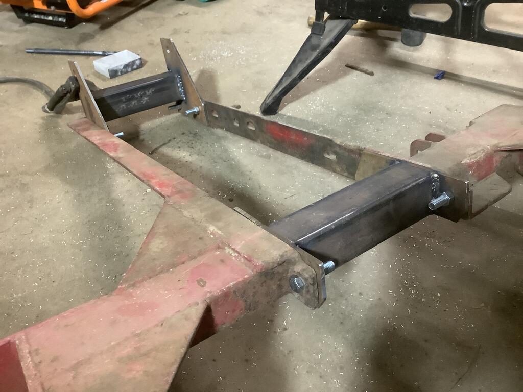

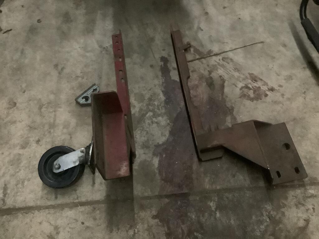

Pullstart 71,478 #118 Posted October 7, 2022 (edited) Some GT14 loader parts here, casters there… front mount genny stand! Edited October 7, 2022 by Pullstart 1 Share this post Link to post Share on other sites

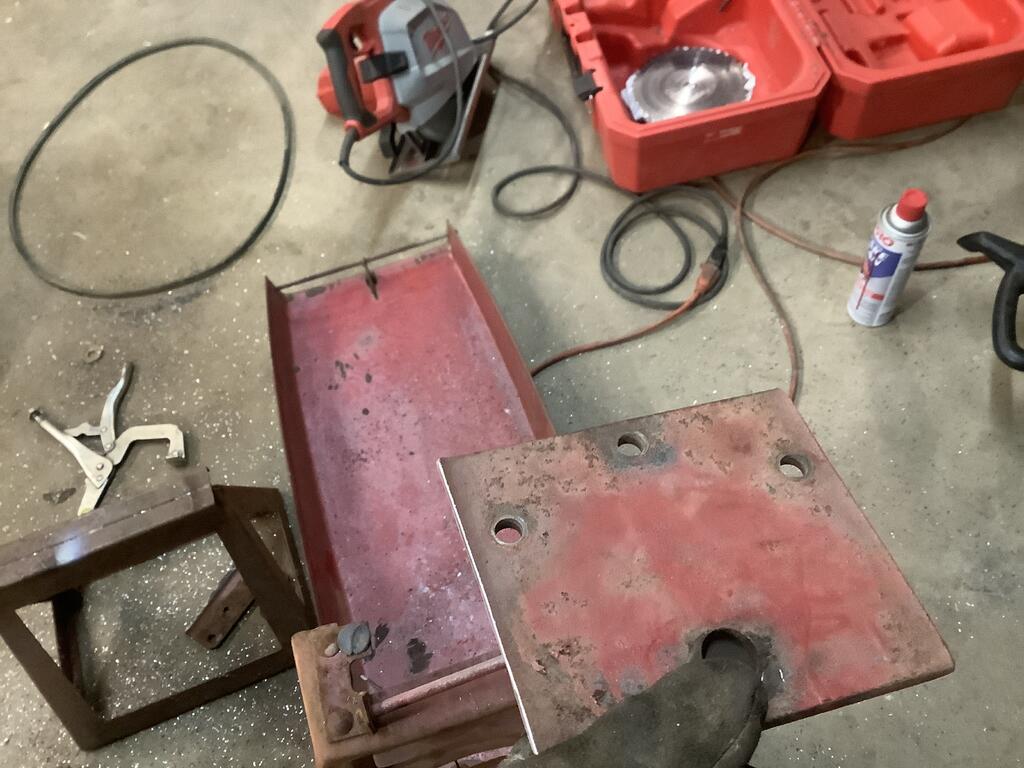

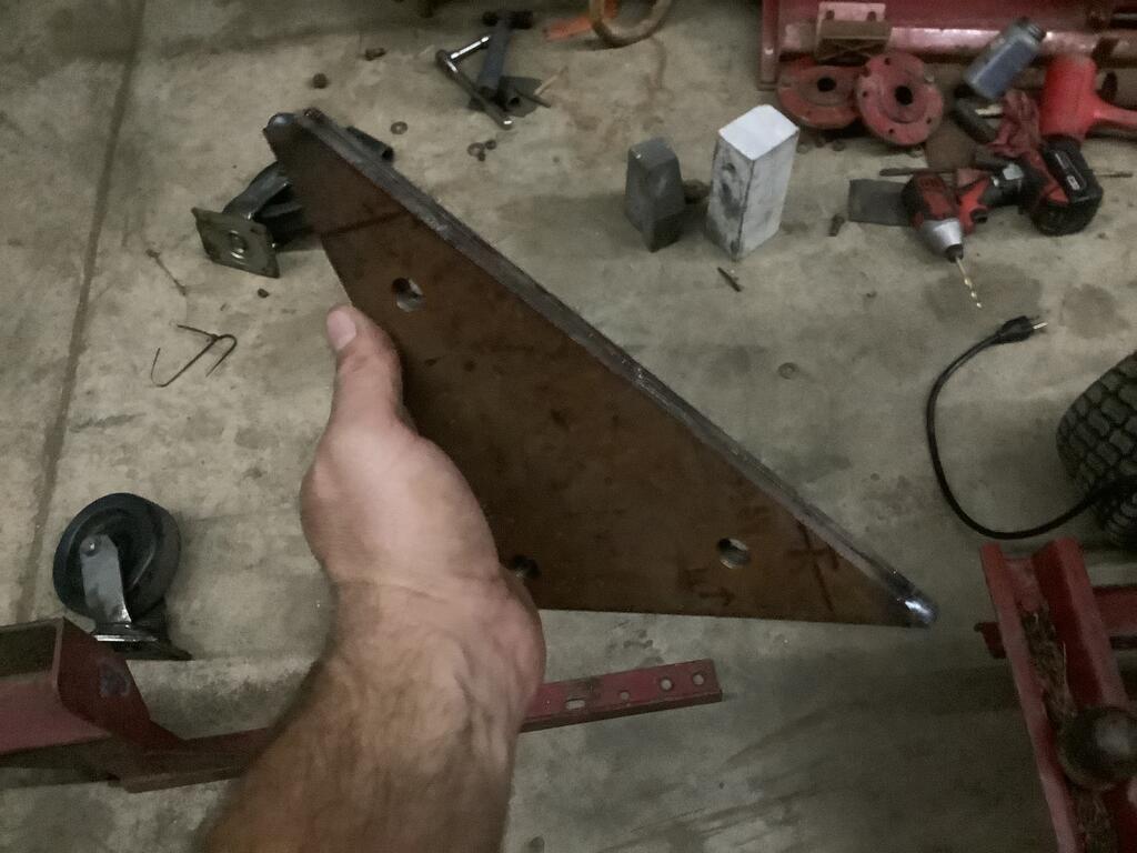

Pullstart 71,478 #119 Posted October 7, 2022 I cut some plates and tack welded them together for hole drilling exercise. I’m not too concerned on the taper matching, just a reference side and hole locations. 1 Share this post Link to post Share on other sites

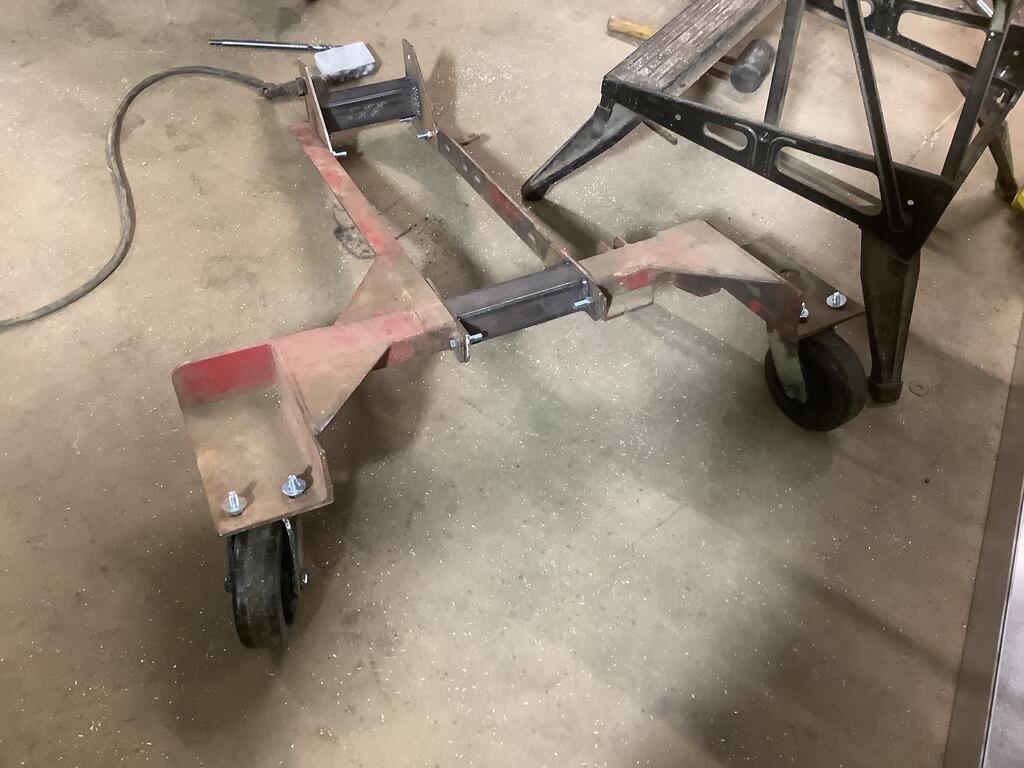

Pullstart 71,478 #120 Posted October 7, 2022 Couple added braces and we’ll be rolling! 3 Share this post Link to post Share on other sites

Pullstart 71,478 #122 Posted October 7, 2022 Everything bolts onto the GT14 Loader stuff, just in case of something. 1 Share this post Link to post Share on other sites
