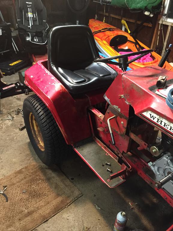

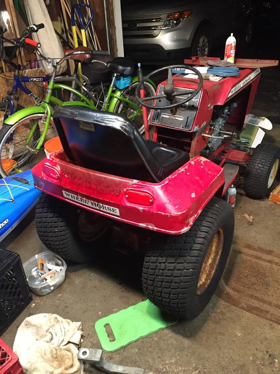

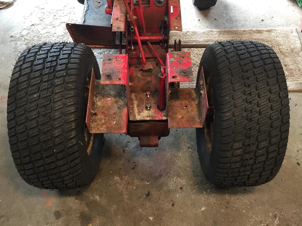

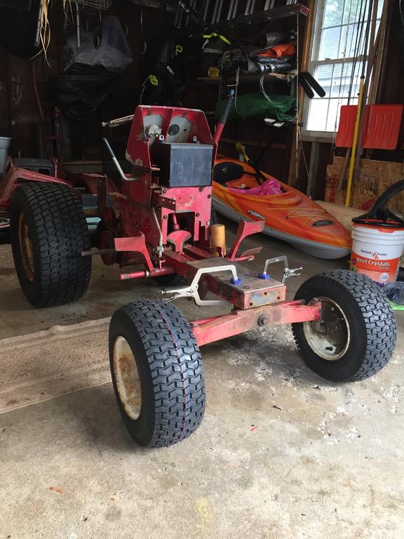

SylvanLakeWH 32,753 #26 Posted September 9, 2019 More progress today... New shoes!!! Carlisle Turf Masters... For the moment, not pursuing the dually option just for cost reasons...but after seeing the beefy Carlisle rears I am drifting back in that direction...gotta dig up that thread on dually spacer dimensions... Still interested in thoughts on the clutch options... consensus seems to be drifting towards a standard clutch... Some pics... 1 Share this post Link to post Share on other sites

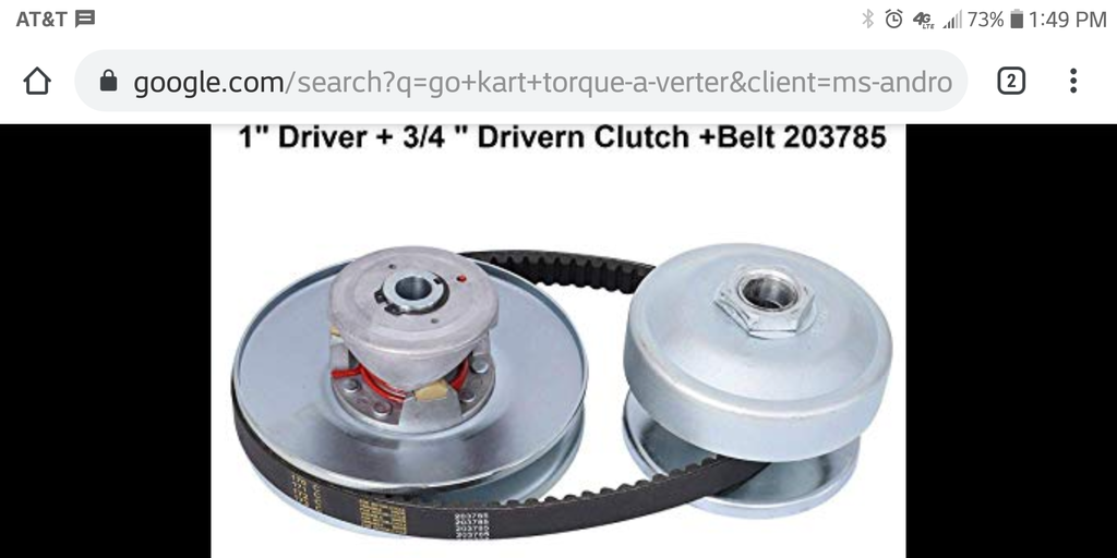

WVHillbilly520H 10,379 #33 Posted September 10, 2019 (edited) @ebinmaine here's a go kart "torq-a-verter" ... The belt rides at different heights in the sheaves as speed is increasing or decreasing there by changing the final drive ratio from low to high to in between just from the engine RPM. Edited September 10, 2019 by WVHillbilly520H 2 Share this post Link to post Share on other sites

SylvanLakeWH 32,753 #37 Posted September 10, 2019 Going through multiple options...including standard WH clutch design with no changes... Your idea Is essentially the same as if I were to use both the clutch and torque converter as shown in picture above. This is what I basically have already...still mulling options... Appreciate the continued interest and input! I am enjoying your Collosus build as well! 1 Share this post Link to post Share on other sites

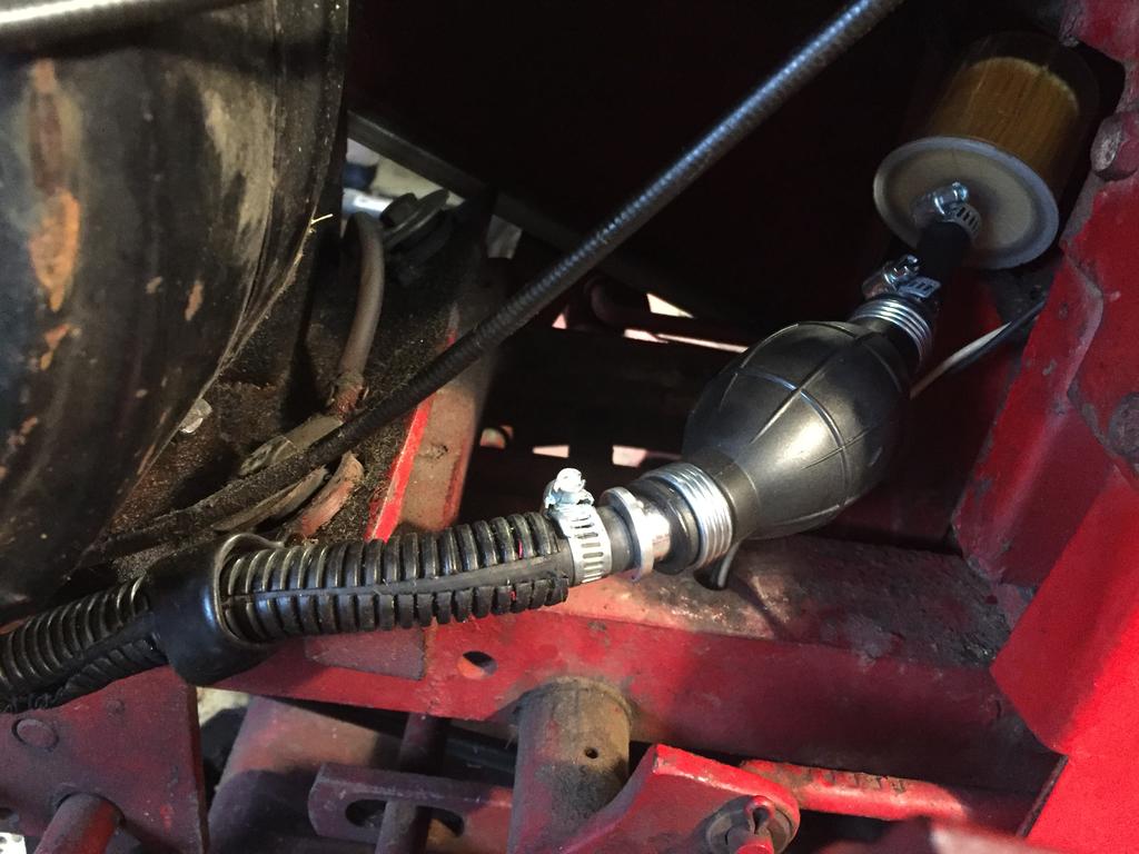

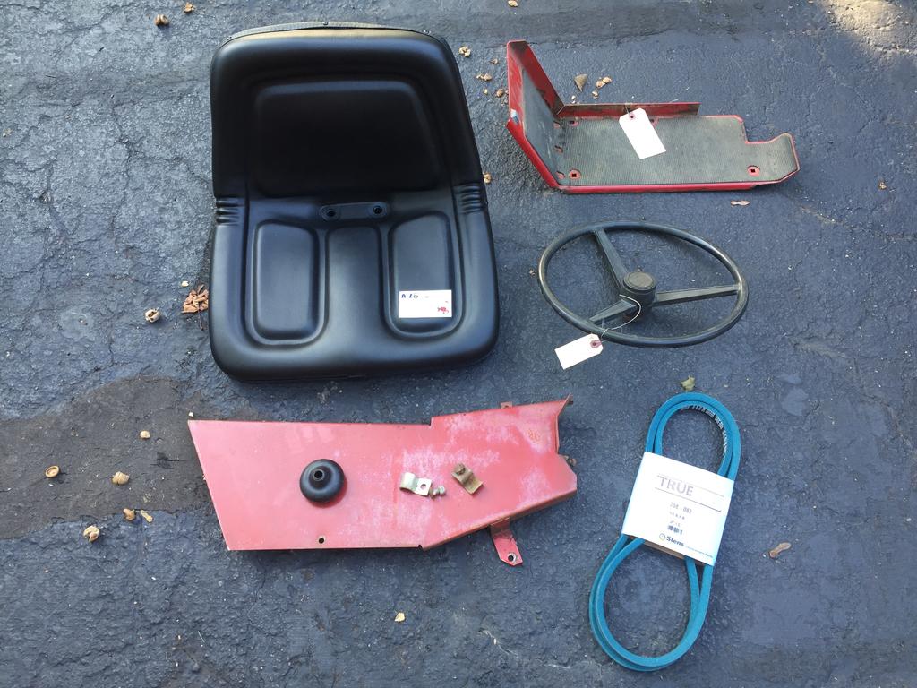

SylvanLakeWH 32,753 #40 Posted September 17, 2019 Stuff arrived from A to Z!!! Thank you Lincoln! So some more progress... Seat fitment progressing...new seat went on my other C105, this one gets the beater seat...still working on hinge and mounting height...if wondering, purposely let the fiberglass epoxy drip etc... adds to the decor... Shift boot cover installed. Right foot plate installed. Only waiting on drive pulley and engine mounting / belt installation to follow... Oh, also installed a marine primer bulb in my other C105 and man does it make a difference on cold start up...! 3 Share this post Link to post Share on other sites
