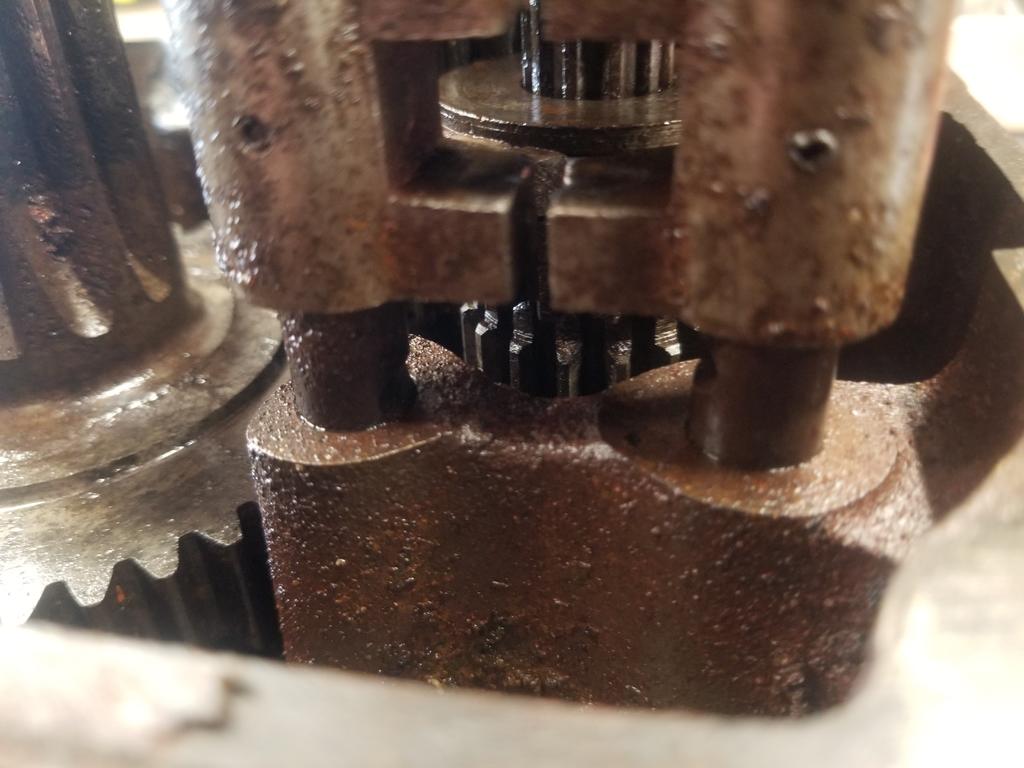

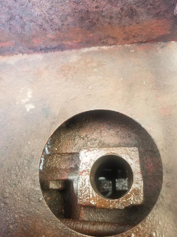

Elliot Garfinkel 166 #19 Posted September 11, 2019 Well the new issue is it will run with clutch engaged as soon as I let up it stalls out.ive been running with shifter out I'm starting to think that wasnt to smart I'll enclose a picture not sure if you can make it out.im no rabbi but it dont look kosher thanks Share this post Link to post Share on other sites

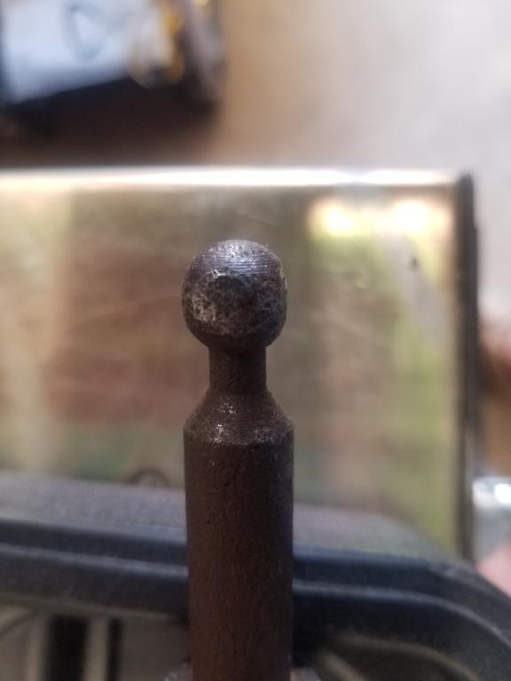

Elliot Garfinkel 166 #20 Posted September 11, 2019 Disregard that last panic post I had to align I guess you call the forks not sure but got the shifter back in and it doesn't stall when clutch released is the ball on the shifter within specs. Thanks for listening Share this post Link to post Share on other sites
stevasaurus 23,763 #21 Posted September 11, 2019 Excellent...you did the right thing...alien the forks and put the shifter back in. Can you shift it now?? Share this post Link to post Share on other sites

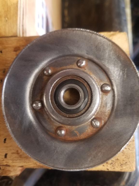

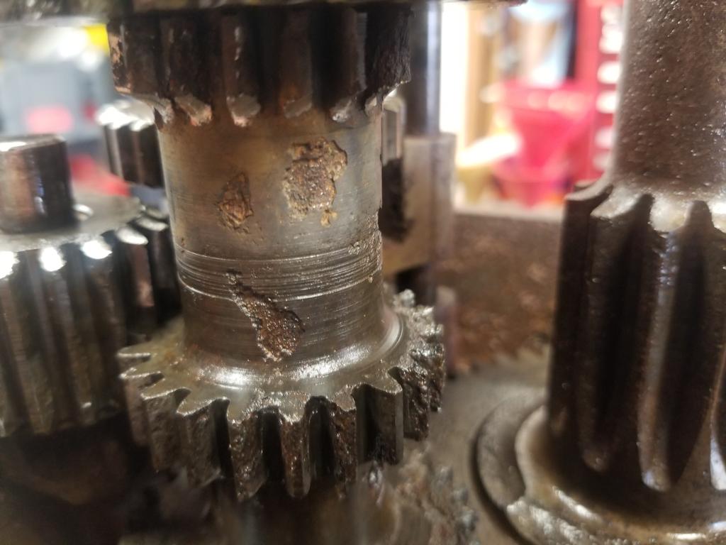

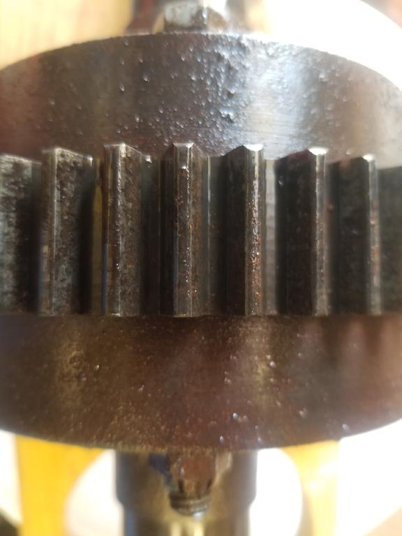

Elliot Garfinkel 166 #22 Posted September 28, 2019 Hey all sorry for slow reply well I'm in it now opened the 5025 I dont think it looks to bad hopefully will enclose pics on the shaft their appears to be what I call flaking but I guess age and lack of maintenance. On a side note the pully #1611 shows it takes 2 1303 is their a bearing in their also. Thanks Share this post Link to post Share on other sites

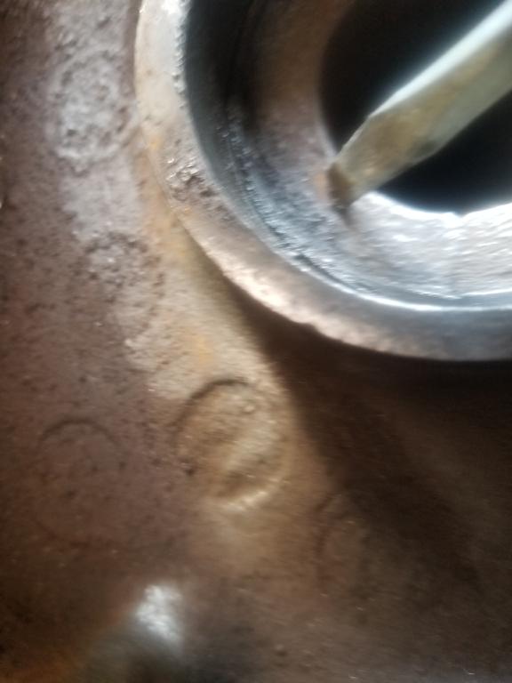

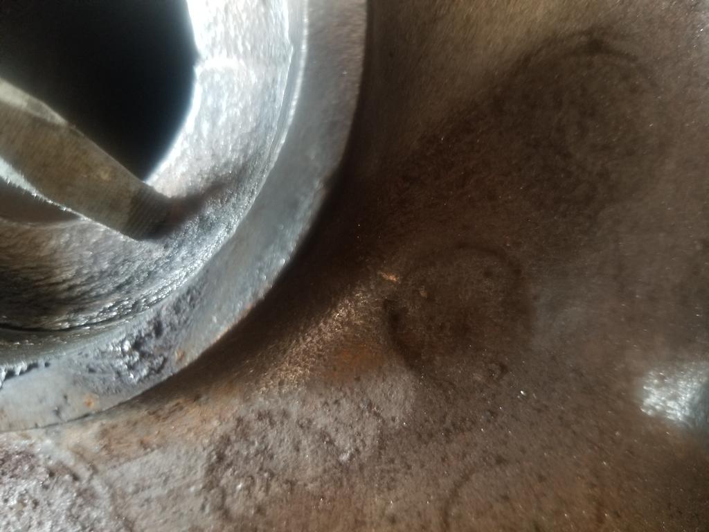

Elliot Garfinkel 166 #23 Posted September 28, 2019 After removing 1533 bearing and cleaning up in their it looks like bearing was not seating properly. The seat is worn how much problem is this. Thanks Share this post Link to post Share on other sites
clueless 3,430 #24 Posted September 28, 2019 On 8/31/2019 at 11:52 AM, RickyMayhew said: Okay let transmission set for 7 days with Diesel Fuel and Marvel Mystery Oil and oil. What next? Really not much information, did it work before? Share this post Link to post Share on other sites
Elliot Garfinkel 166 #25 Posted September 29, 2019 I really cant say since I got it it's been on blocks working on getting it running took for short ride with diesel in rear to run it through the gears but it was hard to tell where the leaks were coming from I know it was coming from the case seam and from motor and from axel seal but it seems the wheel turned freely without noise. I haven't got to the other side yet. I hope this is a little more info thanks Share this post Link to post Share on other sites
