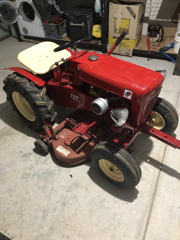

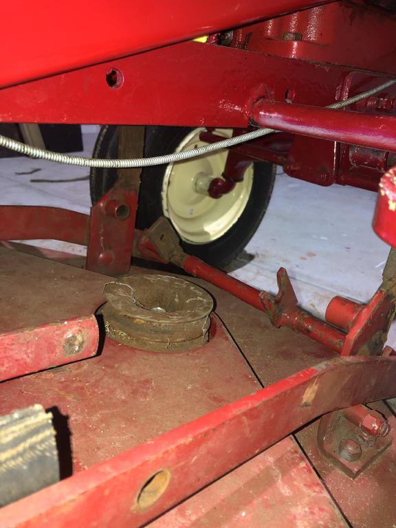

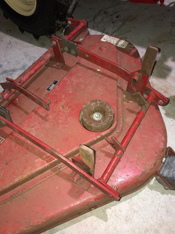

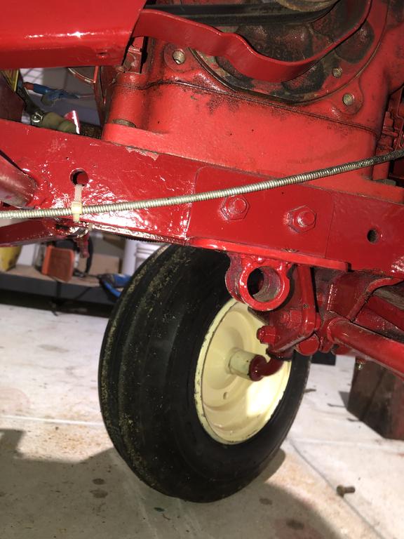

Cat Balou 38 #1 Posted August 31, 2019 Hello everybody. i need some assistance. The story. I purchased this 753 and tidied it up a bit and now i wish to attach the deck that came with it. The deck is a belgium made 75-36XR that has had some modifications. 1. I am not sure how this is supposed to attach. any ideas would help. i can do some fabrication but i can't work out how it was done previously. 2. how to get power from the vertical pulley on the engine (magnum 8) to the horizontal pulley on the deck? again i can fab something up but i would like an efficient way of getting the most power down to the deck. thanks Steve 1 Share this post Link to post Share on other sites

953 nut 69,827 #4 Posted August 31, 2019 Your 753 looks fantastic, but unfortunately the deck you have will not work without adding a "Mule Drive" to the front and a Attach A Matic to the frame. This thread will give you some idea what is needed. Share this post Link to post Share on other sites
WHNJ701 4,173 #5 Posted August 31, 2019 you need this style deck to work with your 753 Share this post Link to post Share on other sites
