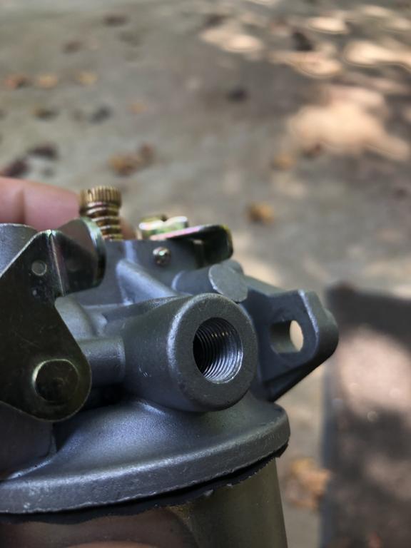

The Tuul Crib 7,354 #1 Posted August 30, 2019 So I picked up this Chinese carburetor off of Amazon and went to put it on and swap out the fittings and no way! The gas line inlet is a metric size cannot use the one off of the old carburetor! I'm sure that someone else has run into the same situation and I'm curious what's your fix might be. You would think that these carburetors would come with that particular fitting but Noooooo! 1 Share this post Link to post Share on other sites
ebinmaine 80,755 #2 Posted August 30, 2019 It's possible you could find an adapter at a Big box Auto parts store. You may be able to get something that is metric threaded on one side and meant to fit like 6 mm hose on the other... Share this post Link to post Share on other sites

Pullstart 71,267 #5 Posted August 30, 2019 How about a pipe tap Randy? Could you chase in some of your own threads? Share this post Link to post Share on other sites
The Tuul Crib 7,354 #6 Posted August 30, 2019 Not sure that would work. I have thought about that as well though. I would be worried about cracking the case of a carb Or metal filings getting into places it didn't belong ! Share this post Link to post Share on other sites

pacer 3,180 #9 Posted August 30, 2019 Last couple I got I did use a pipe thread tap, only got about 3-4 rounds but it sealed off OK ----when you get that done then you gotta fix the choke conx! Share this post Link to post Share on other sites

clueless 3,439 #14 Posted August 31, 2019 If you have a good hardware than go to the section where they sell small brass or copper tubing connections and fitting and start testing the fittings that's how I found mine. Kinda like the old hard plumbed carb connection. Me and one of the young sales guy spent about 10 minutes try to find something, one of the old guys walk up and said follow me, took about a minute to find one that fits, OLD GUYS ROCK . Not even sure it's metric. I will try to get some pics later today, the carb is on a K181. Share this post Link to post Share on other sites
The Tuul Crib 7,354 #15 Posted August 31, 2019 14 minutes ago, clueless said: If you have a good hardware than go to the section where they sell small brass or copper tubing connections and fitting and start testing the fittings that's how I found mine. Kinda like the old hard plumbed carb connection. Me and one of the young sales guy spent about 10 minutes try to find something, one of the old guys walk up and said follow me, took about a minute to find one that fits, OLD GUYS ROCK . Not even sure it's metric. I will try to get some pics later today, the carb is on a K181. I did go to my local Ace Hardware here and everything they had was American Standard. I may put the old one back on for now. It's an eight horse that I picked up and I'm trying to just get it running for now. This new carburetor I Purchased a year ago for another project and never did use it and didnt for the reason of the problem im having now. Share this post Link to post Share on other sites
