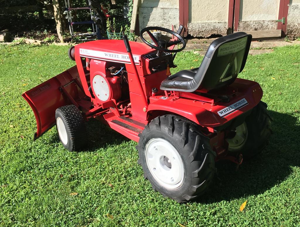

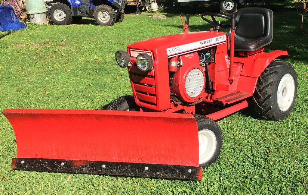

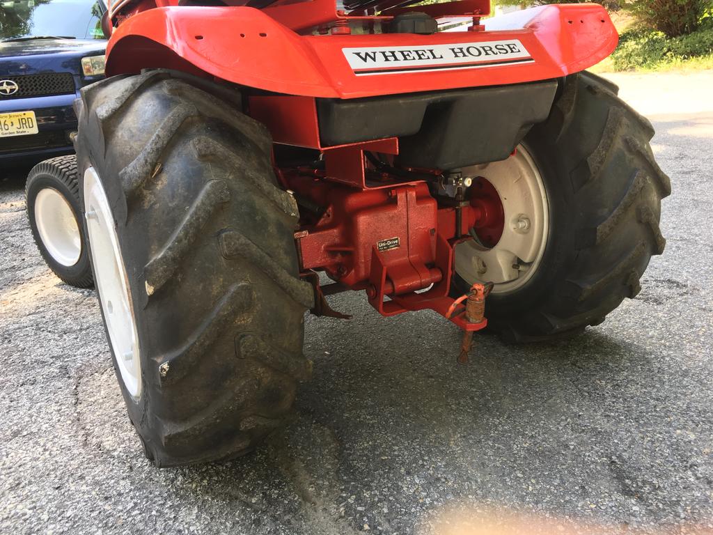

Had the day off so I figured I’d get the plow situation set while I wait for mower deck parts.
I have the rear tires weighted to 90# ea. The old ag tires are dried out and have some cracks but still hold air tubeless. I have a set of chains but they do a number on the driveways I plow. I see a tire spray that’s supposed to improve traction. Anyone ever try it? Is there something out the to soften old rubber? I the really don’t wanna drop $160 on new tires when these still hold air. 😁
292C7B5C-152D-4A05-B558-B82309525416.jpeg.c47089cf0a1ada75be6d1d4f1749cfb0.jpegThat’s my 4”x3/16” plow edge. It’s a 50” long piece I got from the cut pile at the local steel yard. It was cheap and has lasted a long time. I flipped it for the first time.
A2ABCDD2-D6BD-4A03-9149-376AAB8A42D4.thumb.jpeg.80071b96b6e3dd1a29ab9e768a7a6303.jpegI may put tubes and fill my fronts with RV antifreeze. I’m also gunna make a downpressure link soon.
 I haven't used it to plow in about 5 years due to transmission issues that are now solved and some timing adjustments that quelled almost all of my engine knocks.

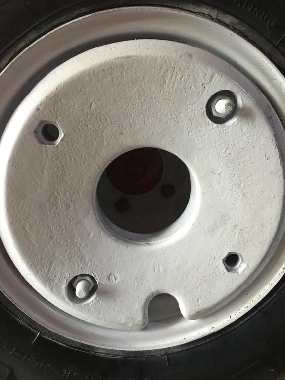

The Tuul Crib
Real nice looks like your prepared for the
season!  your weights look a lot like mine .  Any idea of the maker?

Burnerman
I have no idea. I bought the rims, ag tires and the outer weights from a friend for $100 about 13 yrs ago. He was building a pulling tractor and these were too small. The inner weights ( which I found out they can be mounted inside on this forum, thanks!) I think the same guy gave to me when he quit pulling a few years later.
They have no legible markings I can find. :dunno:

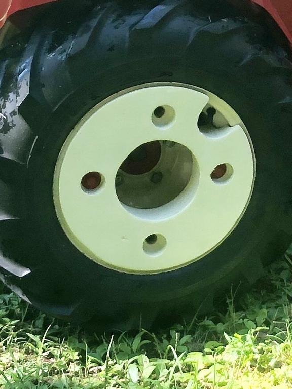

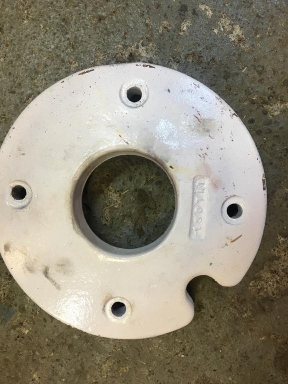

The Tuul Crib
They have readable markings I can find. :dunno:
Heres mine
Burnerman
Yours fit in the rim better and look thicker. My outer ones weight around 40#s I think the inners slightly less.

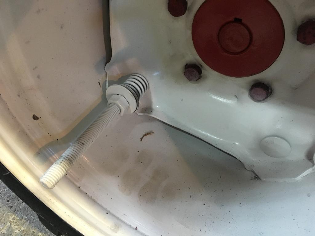

 They’re curved slightly for stacking I guess. I have them dished in. I had them both on the outside and they stuck out and got caught on stuff occasionally. Now with 1 in and the other out there’s nothing sticking out beyond the rim. 8C5B5491-6A3F-48B0-918E-01743BB76C2D.jpeg.fe650df4fe6a33cba9fead2002bf0e2a.jpeg

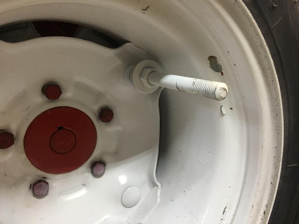

Burnerman
ECE99397-0147-4E66-9419-914C1E611C8D.jpeg.e211fcc4f4d58fb60db3a34b85aa261e.jpegThere is a cast “130TW” and that’s it.
OH! I don’t know if it’s been done but I put my bolts on springs. I can easily line up the weight and I use my 1/4” impact driver and 3/4” socket to cinch it down. They’re old valve springs. ECE99397-0147-4E66-9419-914C1E611C8D.jpeg.e211fcc4f4d58fb60db3a34b85aa261e.jpeg536A5556-AE84-4DC3-84A7-2CAD5CA265C5.jpeg.6b5d519bf7c7a19b51c50e4d67e0d491.jpegD1F94E9C-299A-4871-8846-3168295F8BD2.jpeg.6d2bc078d060806ddd6ffb6cd13c31c7.jpeg
