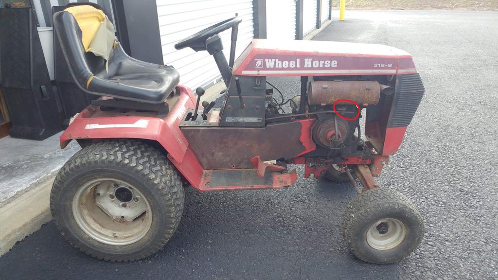

Sparky-(Admin) 26,693 #3 Posted August 29, 2019 I agree with Ed. Here’s a pic of where the trunnion is (circled in red) to increase pressure on the PTO. Share this post Link to post Share on other sites

upstate yank 219 #5 Posted August 30, 2019 On 8/29/2019 at 4:47 AM, Sparky said: I agree with Ed. Here’s a pic of where the trunnion is (circled in red) to increase pressure on the PTO. thanks for the reply and yes i do where that item is as i have a B-80 that is set up the same way plus a few other horses ;'but the trunnion will not turn as it is froze up so i used some WD-40 and then cut some of the grass ;it seemed to work as it should but i am sure i have a bad spindle which when it stops raining i need to remove the deck and check it over ;again thanks so much Share this post Link to post Share on other sites
