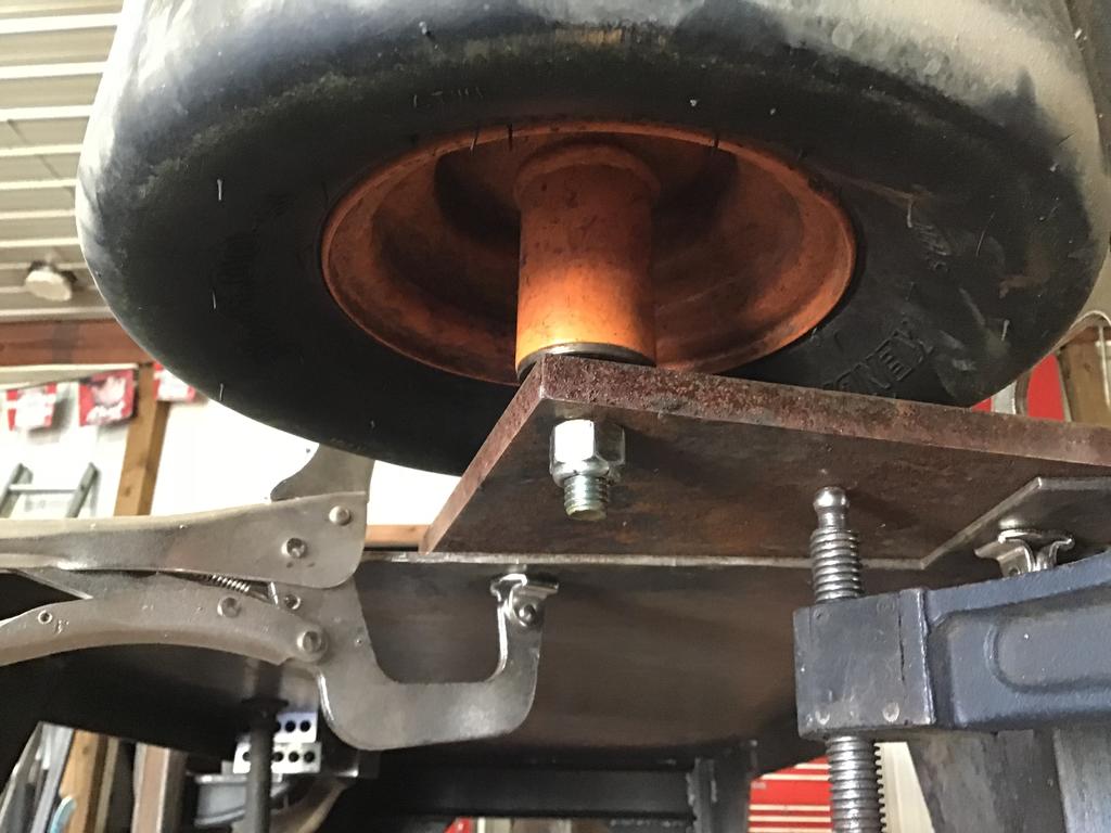

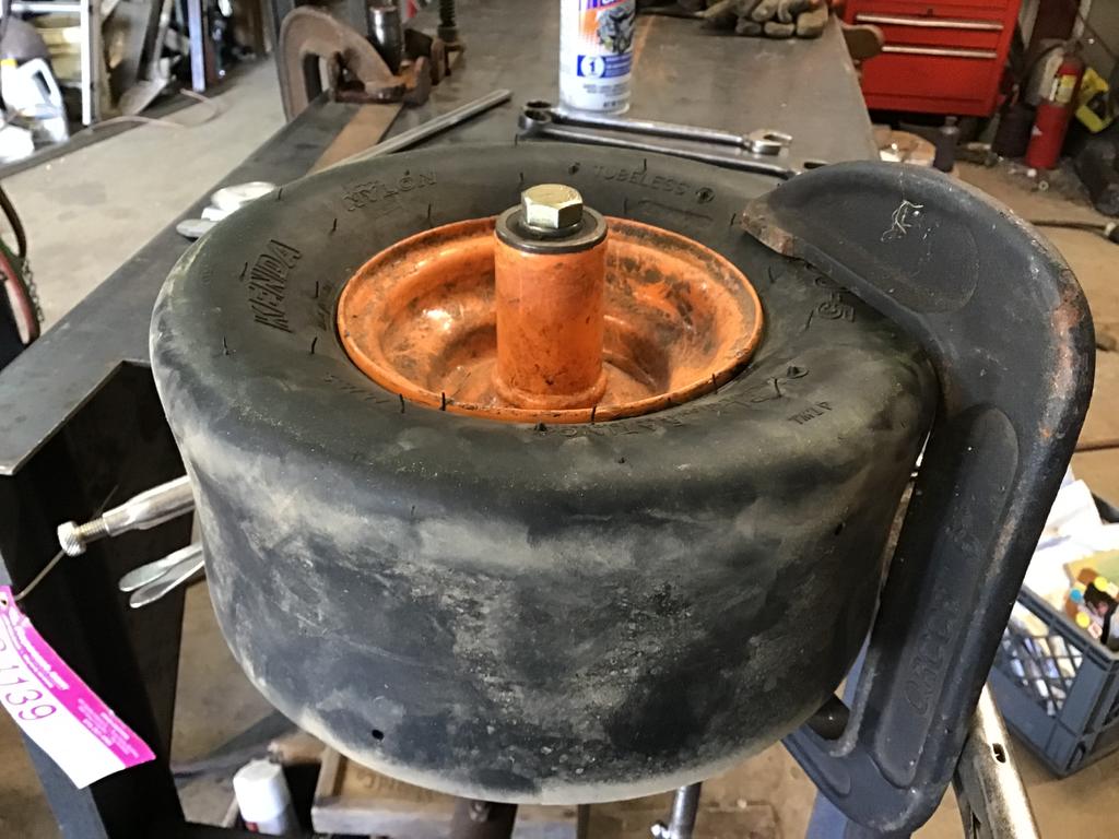

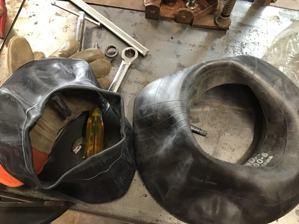

Pullstart 71,481 #1 Posted August 28, 2019 I’ve been loosing air in a front tire of my zero turn since about day 2. I got tired of pumping it up a while back, fought to break down the tire and cram a way oversized tube in it, then I think I tore the tube. I’ve been dreading the repair again because fighting small tires and wheels is the worst in my book! I found this plate with a ho,e in it and bolted the wheel to the plate for very simple breakdown. The dealer suggested I feel the inside of the tire to make sure there isn’t a thorn stuck in it before re-assembly. Smart move, now I’m ready to pop it all together with the right sized tube! 5 2 1 Share this post Link to post Share on other sites

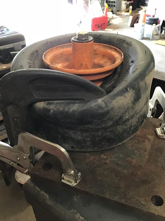

Pullstart 71,481 #3 Posted August 28, 2019 18 minutes ago, 857 horse said: MAN,,,,,,,USING THAT C CLAMP IS SOOOO SMART......GREAT IDEA...!!!!!!!!!!!!!!!!!! I keep it on the tire to keep the bead below the seat on the wheel... until I have to finish popping it apart. 3 1 Share this post Link to post Share on other sites
ebinmaine 81,035 #4 Posted August 28, 2019 Awesome idea Kev. I read or saw on YouTube about somebody using a 3/4" piece of thread rod and clamp that in a vice. Goes right up through the wheel and holds everything steady. 2 Share this post Link to post Share on other sites
953 nut 70,019 #5 Posted August 28, 2019 I have a piece of 3/4" threaded rod through a hole I drilled in my workbench that i can secure the rim to while changing a small 6" or 9" tire. I use the large Harbor Freight tire changer to break the bead first. 1 1 Share this post Link to post Share on other sites

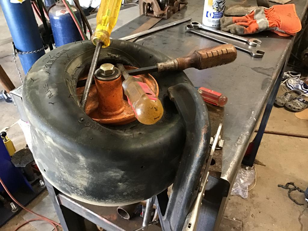

ohiofarmer 3,525 #13 Posted September 27, 2019 The C-clamp is a good idea that I have been using for a while. Also a big help is to use actual tire spoons. Look at how chewed up those tire beads are on that tire and that is the reason it needs a tube in the first place. I like to use up to three of the Harbor Freight 24" spoons on most of my tires. I also use a fish tool to get the valve stem through the rim. once the tube is inside the tire, you should put some air in the tube [probably about 1 PSI] or just enough to keep the tube from getting pinched in the rim. Breaking the bead has got to be the worst part on some of the tractors I have bought. The sidewalls on a lawn and garden tire are flexible and the bead breaker just slides off. I use penetrating oil on the worst ones that are actually rusted to the rims and also heat the bead area with a propane torch just to where the thing smokes a bit . When all else fails, I use a 4x4 cut to a 30 degree angle and place the point next to the rim and drive my truck up the ramp. Share this post Link to post Share on other sites

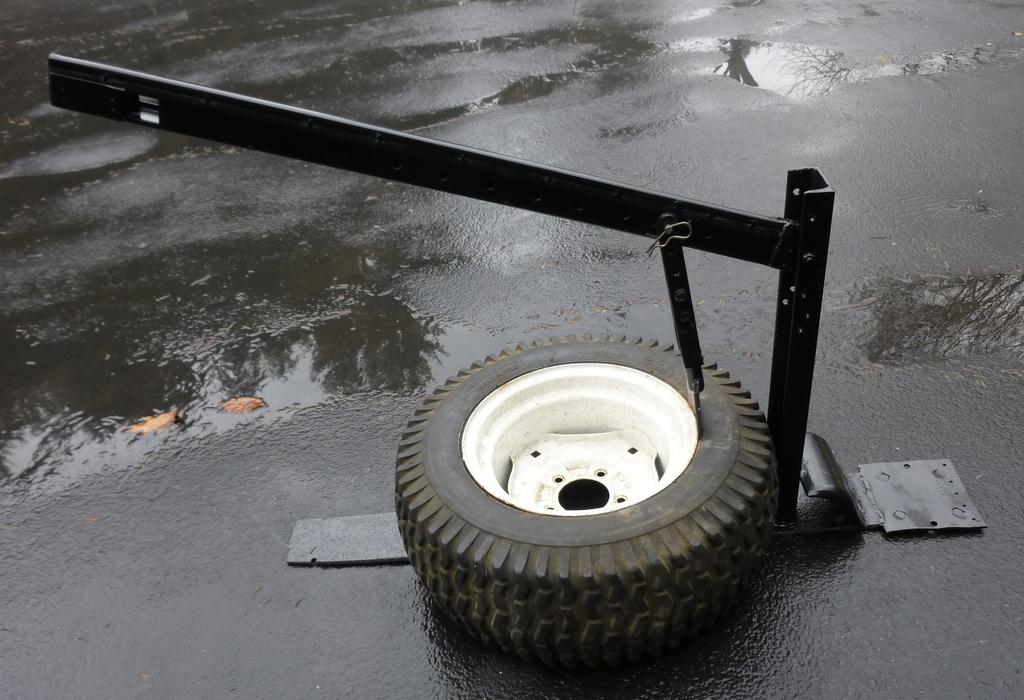

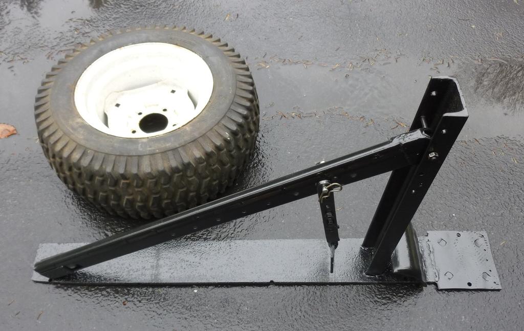

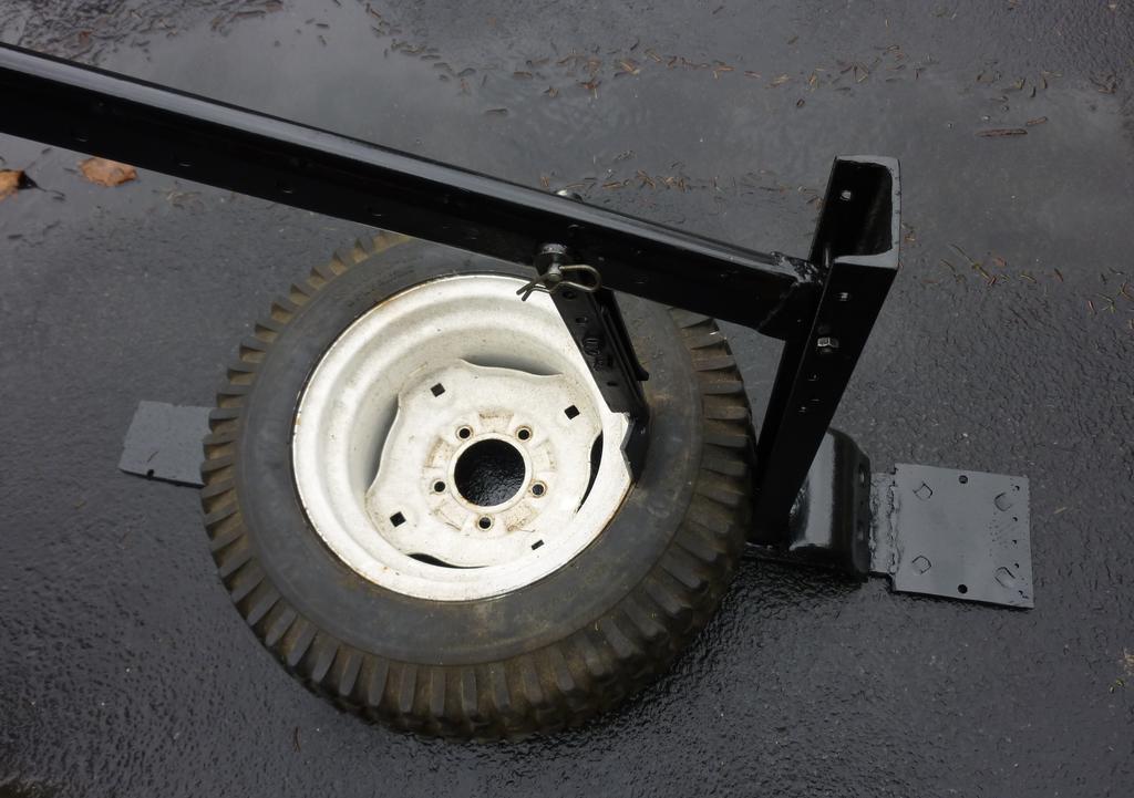

Rob R 992 #14 Posted September 27, 2019 Years ago I made tire breaker out of scrap steel..... best tool I have ever made and I use it all the time as well as my neighbors and anyone in a 10 mile radius 5 2 Share this post Link to post Share on other sites
