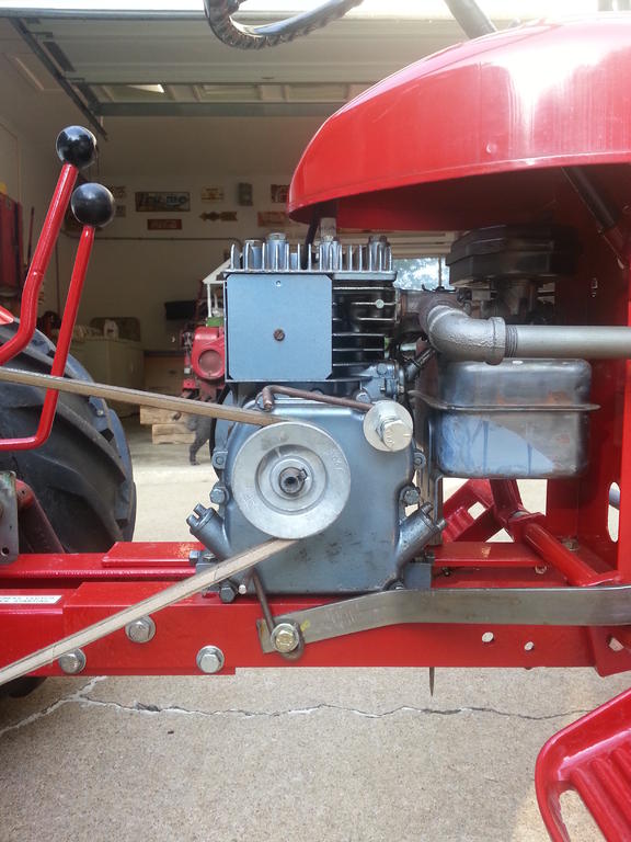

ebinmaine 81,046 #2 Posted August 28, 2019 First thing comes to mind... Is your belt guard on? Your belt GUARD is the belt GUIDE. If it isn't there the belt won't free up enough. Or The little tabs at the nose of the guard are bent down a bit. Or The belt is a tiny bit too tight. What's the tractor details and where's the belt from? Also, have you double checked the belt to verify it was packaged correctly? Pics would help too. We love to look at tractors.... 2 2 Share this post Link to post Share on other sites

rmaynard 17,634 #9 Posted August 28, 2019 ...and there's the problem. Short of finding and installing the belt guard, you might be able to fashion some wire guides to assist the belt in moving away from the drive pulley. On my 701, the wire guide at the bottom assists the belt in moving away from the pulley. The top of the belt guard does the rest. Not sure if this is original, but it's been working for me since I got the tractor. Share this post Link to post Share on other sites

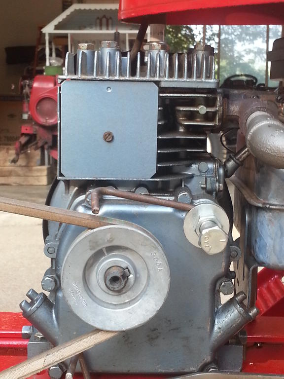

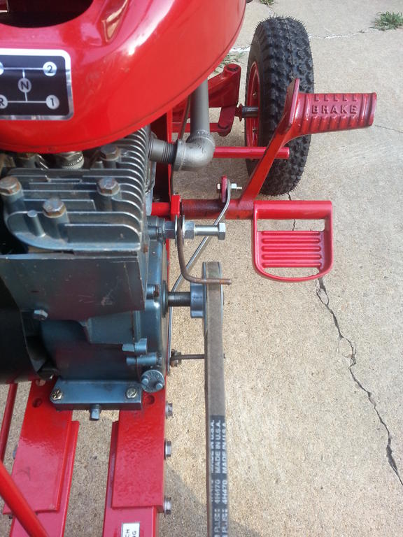

stevasaurus 23,861 #14 Posted August 28, 2019 We did this on Howard's horse and it worked great on his. His belt is a lot shorter then yours, but it still might be enough to work. We used like #109 wire. ace would have it if you do not have something lying around. 1 Share this post Link to post Share on other sites

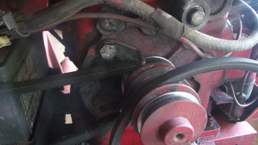

870express 116 #15 Posted August 28, 2019 (edited) 7 hours ago, ebinmaine said: We love to look at tractors.... Is the drive pulley rusted? If it is, the pulley inner surface will create more friction with the belt. It should be clean and shiny. Not like this - Edited August 28, 2019 by 870express 2 1 Share this post Link to post Share on other sites
XLT 13 #16 Posted August 28, 2019 Pulley is brand new, so excess friction from rust isn't the issue. I had mentally considered something like those wire brackets on the idler arm itself to push the belt forward as the idler was depressed. What think ye? 1 Share this post Link to post Share on other sites
ebinmaine 81,046 #17 Posted August 28, 2019 Just now, XLT said: What think ye? Belt guard will be the ultimate solution but those certainly can't hurt anything. Share this post Link to post Share on other sites
XLT 13 #18 Posted August 28, 2019 Yeah, the belt guards for the 701 seems pretty scarce... 1 Share this post Link to post Share on other sites
stevasaurus 23,861 #19 Posted August 28, 2019 They may be rare, but if you do not have the correct engine or pulley you may have to fabricate something. 1962 belt guards are more common and they may work. Like you said, also, the guess on that belt you put on there may be to short to have enough slack to push forward. Contact A-Z Tractors...one of our vendors...to see if he can help you out with a guard. I would think that with a 702 guard and the bent wires on the engine near the drive pulley, you will be OK. You might try bending your own from sheet metal. BTW, when you try the bent wire, it needs to be about 1/4" from the belt...top and bottom. Something to think about...a belt guard has a lip bent along the bottom. That is what supports the belt when the slack is there and pushes it toward the front. 1 Share this post Link to post Share on other sites

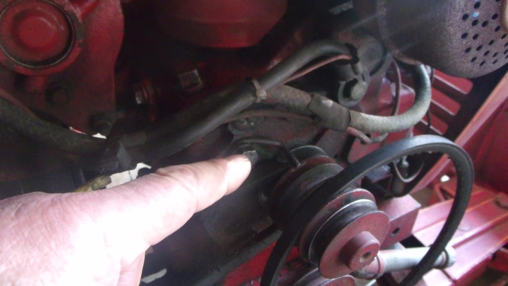

Elliot Garfinkel 166 #21 Posted September 8, 2019 Hi trying to follow threads on the 702 shifting I have the guard on I'm on my third belt and still seems that the belt doesn't disengage enough to shift without some grinding I'm not sure if I'm missing anything on the guard or on the block. I see that their is a clip on the front guard bolt but I dont think that has anything to do with it I see in your 3rd picture a guide I guess I'm missing that or is that instead of a guard, thanks Share this post Link to post Share on other sites
