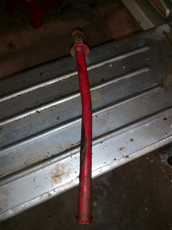

Dave3434 13 #1 Posted August 28, 2019 Good Evening everyone. Does anyone happen to know what this part is? I was doing work on my 414 and it fell off. Any help is appreciated. Thanks Dave Share this post Link to post Share on other sites
Stepney 2,357 #2 Posted August 28, 2019 Maybe the sheave for the rear lift cable? Looks flared at one end. 2 2 Share this post Link to post Share on other sites
troutbum70 858 #3 Posted August 28, 2019 Stepney is correct it just lays in over top of your transmission/rear differential a control cable is routed threw it from the front rockshaft to a rear slip hitch. If you are not using a rear implement such as a Brinley plow, cultivators, drags or the such it has no purpose. Share this post Link to post Share on other sites

Pullstart 69,723 #10 Posted August 28, 2019 @Dave3434 I concur, it looks lift cable related. Share this post Link to post Share on other sites
Lee1977 7,632 #12 Posted August 28, 2019 That one is for a gear drive. it looks worn can't tell for sure, but if it has a hole worn in it. will destroy a new cable.. You need a bracket like this ti bolt it to the top of the transmission. 1 Share this post Link to post Share on other sites
