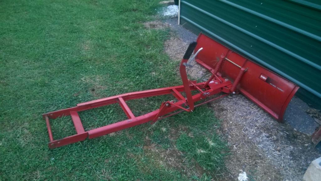

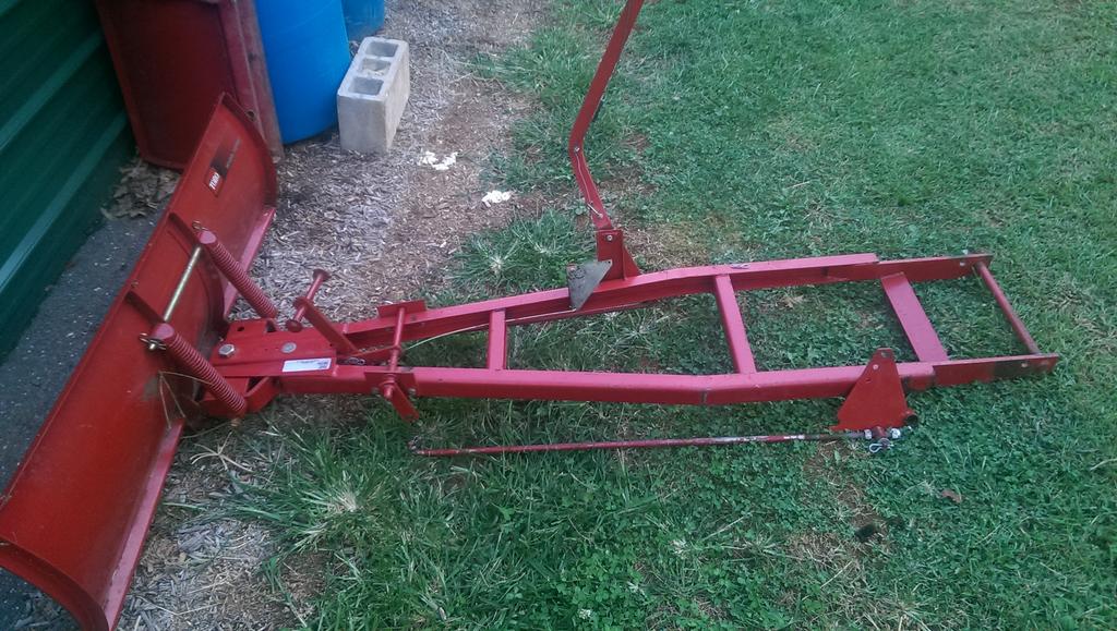

daveoman1966 3,882 #11 Posted August 28, 2019 18 minutes ago, ebinmaine said: So I take it that goes around the outside edge of the forward end of the step plate. Don't shape you index lever like this one for the 260 tractor. Make it like the one in the FIRST PICTURE in this string. That 1st pics is whats needed for the B C tractors. Share this post Link to post Share on other sites
ebinmaine 77,537 #12 Posted August 28, 2019 42 minutes ago, daveoman1966 said: Don't shape you index lever like this one for the 260 tractor. Make it like the one in the FIRST PICTURE in this string. That 1st pics is whats needed for the B C tractors. Oh yeah. I know. Thanks Dave. Patriot is a B series and cinnamon is a C Series. I have two different snow plows here and on both of them that lever it's the step. 1 more so than the other. It's obvious to me that one of them was badly bent when I got it and I've tried to reconfigure it with limited success. That's why I was wondering about the 260 series lever. I wondered if I could get the entire lever to the outside edge of the foot step. Share this post Link to post Share on other sites
WVHillbilly520H 10,378 #13 Posted August 28, 2019 3 hours ago, ebinmaine said: So I take it that goes around the outside edge of the forward end of the step plate. I converted that blade over to fit B,C,3 &400 series and I do believe the lever set forward and to the side of the foot rest. The xi series had a better design in my opinion. 1 Share this post Link to post Share on other sites

WVHillbilly520H 10,378 #17 Posted August 30, 2019 On 8/28/2019 at 10:55 AM, WVHillbilly520H said: I converted that blade over to fit B,C,3 &400 series and I do believe the lever set forward and to the side of the foot rest. The xi series had a better design in my opinion. @ebinmaine... Found a couple more 260 series pics. Last one xi series 1 Share this post Link to post Share on other sites
ebinmaine 77,537 #18 Posted August 30, 2019 I reeeeelly like how that goes to the far outside of the area so it doesn't interfere with the brake pedal. Extra reach isn't an issue with my ape arms. I may have to experiment with that..... 1 Share this post Link to post Share on other sites
WVHillbilly520H 10,378 #19 Posted August 30, 2019 (edited) 2 hours ago, ebinmaine said: I reeeeelly like how that goes to the far outside of the area so it doesn't interfere with the brake pedal. Extra reach isn't an issue with my ape arms. I may have to experiment with that..... Toro still has that index lever available... "92-7036" for around $50 from whole assembly 79252 Edited August 30, 2019 by WVHillbilly520H 1 Share this post Link to post Share on other sites
