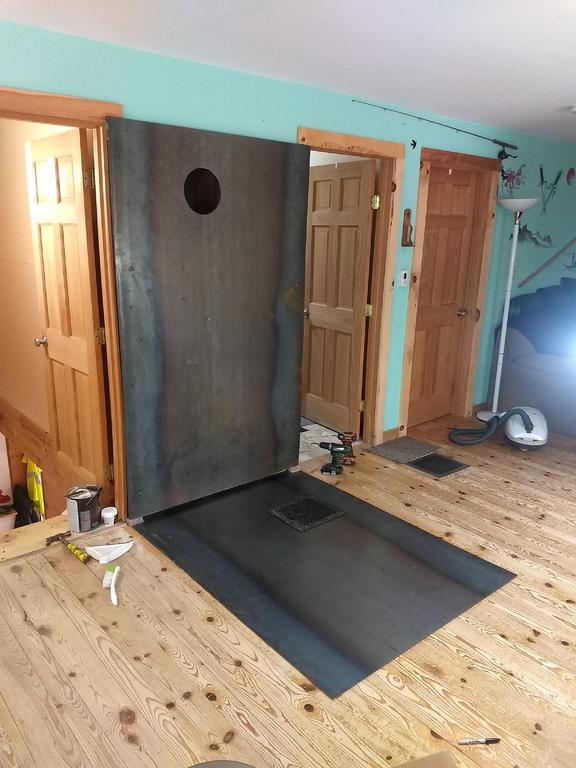

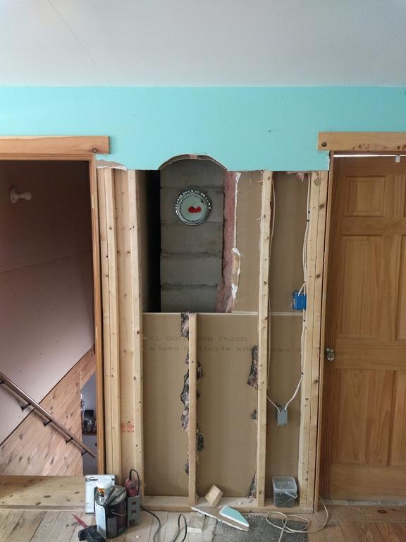

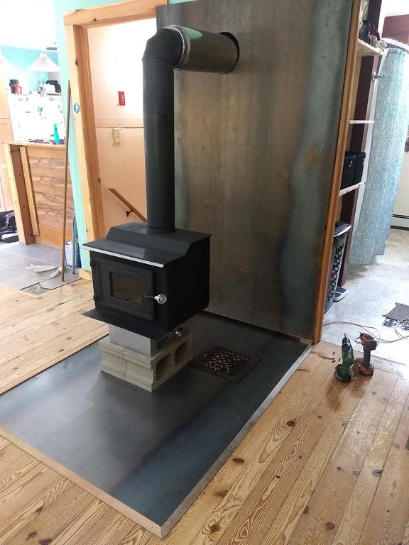

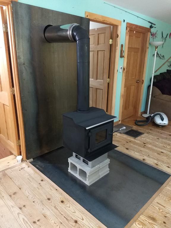

ebinmaine 78,408 #30 Posted October 13, 2019 (edited) Couple weeks ago we had the Mason come over and cut a hole in the chimney and he tied in a thimble for us. Over the last few days we have finished the wood stove installation. We allowed for extra clearances in every direction to increase safety level. The top horizontal piece of stove pipe is a double-wall insulated piece that requires only 2 inches of clearance to combustibles. With the notch cut into the top of the wall there's around 4 inches. The vertical portion of the sheet steel is spaced 2 inches from the wall studs. There's a 1.25 inch air gap at the bottom so air can flow behind the whole piece. Both floor and ceiling pieces are 16 gauge where minimum is 24. This stove requires 2 inches of masonry below it. We went with 8 inch hollow blocks so as to increase airflow under the stove to keep the floor cooler. Trina started a fire as soon as it was in. Good draft. Seems nice. An excellent addition to our home. Edited October 13, 2019 by ebinmaine 2 2 Share this post Link to post Share on other sites
adsm08 4,363 #31 Posted October 13, 2019 When venting a wood stove there are two rules to keep in mind. 1) NEVER go down in size from the stove's outlet. 2) Keep it as close to the stove's outlet size as possible. It is acceptable to vent a 6 inch stove into an 8 inch chimney, but doing it into a 6 inch one is better. You loose exit velocity and can backdraft like was mentioned earlier. I had a fire in one chimney a few years back, and while it didn't do any damage the wife still wanted it lined. Her BIL does HVAC and the like, so ordered a liner kit from Rockford Chimney Supply and we installed it on a Saturday afternoon. I got the flex kit, the stacked solid ones would probably have been better, since that chimney is a straight shot down to the stove, but I was on a tight budget and it was a few hundred dollars difference. I really liked how they deal with the T-fitting at the bottom. They have a nifty two-piece thimble, so you can get the piece that goes through the wall in place, then drop your liner and inner thimble in from the top and draw them together with a clamp. I burned on that all last winter and had less crap in the chimney at the end of the winter than I did after a few weeks of intermittent use on just the clay liner. Share this post Link to post Share on other sites

ebinmaine 78,408 #33 Posted October 13, 2019 11 minutes ago, adsm08 said: Keep it as close to the stove's outlet size This one's 6 all the way Share this post Link to post Share on other sites

adsm08 4,363 #36 Posted October 13, 2019 1 hour ago, ebinmaine said: This one's 6 all the way That's ideal. 6 inch gives good exhaust velocity. I've even seen some with an outlet as small as four inches in the last year or so. 1 Share this post Link to post Share on other sites
tunahead72 2,627 #37 Posted December 1, 2019 On 10/13/2019 at 4:10 PM, ebinmaine said: Couple weeks ago we had the Mason come over and cut a hole in the chimney and he tied in a thimble for us. Just curious Eric, how did he cut the hole? Share this post Link to post Share on other sites
ebinmaine 78,408 #38 Posted December 1, 2019 9 hours ago, tunahead72 said: Just curious Eric, how did he cut the hole? Mostly a cement drill. Combined with a side angle die grinder and hand chisels. I figured he might use a round 7" hole saw but he's done this in this manner for only 30 years or so and the hole saws have a much shorter life span (dry) than the tools he uses. More cost effective for him... 1 Share this post Link to post Share on other sites
