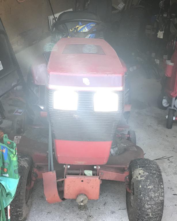

Bean701 35 #40 Posted September 14, 2019 (edited) Temporarily wired up the LED par36 headlights. For some reason the factory wiring is inop. I’m not getting any power at the switch. Edited September 14, 2019 by Bean701 Share this post Link to post Share on other sites

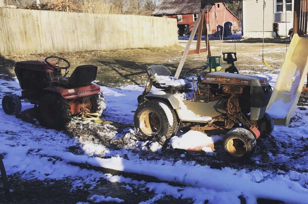

Bean701 35 #41 Posted May 13, 2020 So I need info on part interchangeability. I literally drug my poor old GT 1800 from a five foot pit my grampa had pushed it into thinking it was scrap iron. I would like to run the bigger front wheels from it on my little 312. Will this require an axle swap and if so, is it direct bolt in? Next, I’d like to swap the big Eaton 1100 into this tractor. If I do that, must I use the hydro deck lift? Any advice would be great. In the meantime we will be blasting the sheet metal in preparation for swapping into the rust-pitted 312... Share this post Link to post Share on other sites

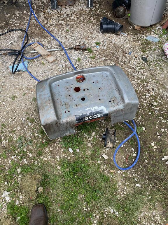

Bean701 35 #42 Posted May 23, 2020 Pulled the seat pan off the GT1800 and a friend is going to blast it. We tried some pressure washing with some grit. The paint on the GT tractors seems to hold up better than the red. Share this post Link to post Share on other sites
