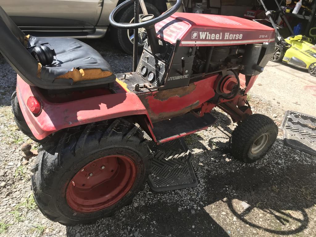

Bean701 35 #1 Posted August 27, 2019 (edited) Got this tractor off a good friend who knew I had an interest. Unsure of year, possibly an 86. 700 Eaton (bad news, but works), 12 horse Kohler (my first Kohler, good!) rotting paint, came with a small mowing deck and a snow blade. Edited August 27, 2019 by Bean701 4 Share this post Link to post Share on other sites

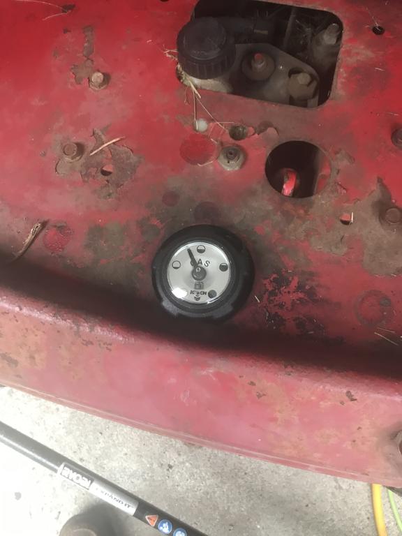

Bean701 35 #2 Posted August 27, 2019 So this will be my “build” thread for this little tractor. So far I’ve managed to install a way too small set of Amazon special Ag tires, install a new gas cap/gauge, new tail lights are here but not installed, and I ordered a way too big air filter. I previously had a 84 GT1800 Work Horse. The motor failed and the tractor was junked. However I found it mostly intact and am going to retrieve it for a parts tractor. 7 1 Share this post Link to post Share on other sites

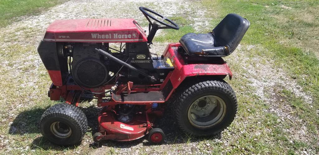

ZXT 2,402 #3 Posted August 27, 2019 That thing isn't nearly as crusty as a lot of them out there! Looks like it'll be a good worker once you get the Eaton fixed/swapped out. What brand and size are those rears? They look pretty good. 1 Share this post Link to post Share on other sites
Bean701 35 #4 Posted August 27, 2019 The tires are “Deestone” 23x8.5-12. Apparently the Chicoms don’t have an accurate tape measure bc these are a far cry... The 700 seems to function really well. It’s very smooth compared to the 1100 on my old GT. But when it fails I’ll have a swap hopefully. 1 Share this post Link to post Share on other sites

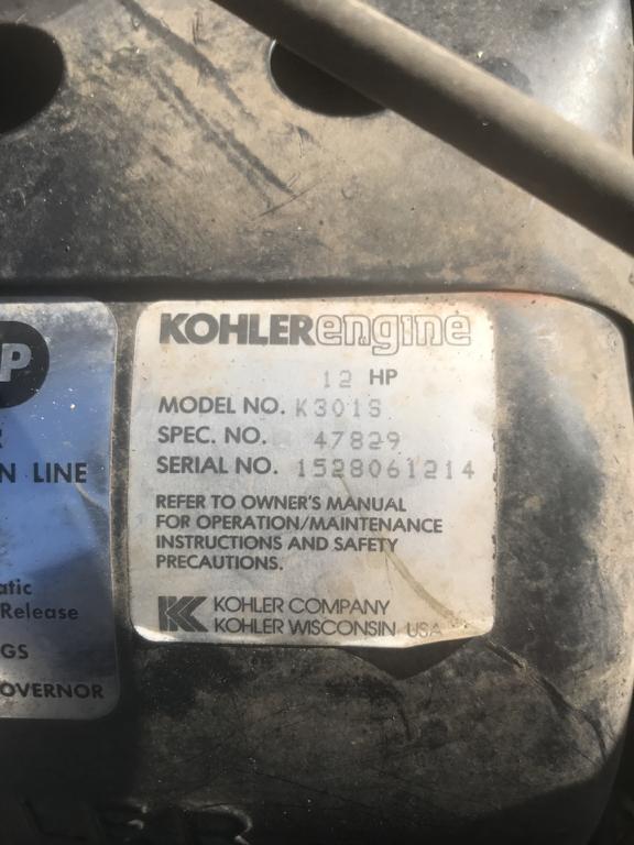

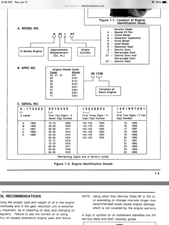

Bean701 35 #5 Posted August 27, 2019 Anyone able to decode this engine tag and come up with a year? Share this post Link to post Share on other sites

81blackhood 168 #7 Posted August 27, 2019 looks like 1985. Nice tractor👍 2 Share this post Link to post Share on other sites

gwest_ca-(File Mod) 12,521 #9 Posted August 28, 2019 Engine made in 1985 but it landed on a 1986 tractor model 21-12KE01 or 21-12KE02. https://www.wheelhorseforum.com/search/?&q="21-12KE01"&type=downloads_file&search_and_or=or Garry 1 Share this post Link to post Share on other sites
Bean701 35 #10 Posted August 28, 2019 What is with the paint peeling off in sheets? Was this a common issue? Share this post Link to post Share on other sites

oliver2-44 11,791 #12 Posted August 28, 2019 10 hours ago, Bean701 said: What is with the paint peeling off in sheets? Was this a common issue? When they moved to the 300,400,500 series they changed the paint process and it fails in sheets like a powder coat does. I restored a 312-8 gear drive for my son a few years ago. Sand blasted everything to bare metal and repainted. It's a great stout tractor and is worth every bit of time I put into it. 1 Share this post Link to post Share on other sites
