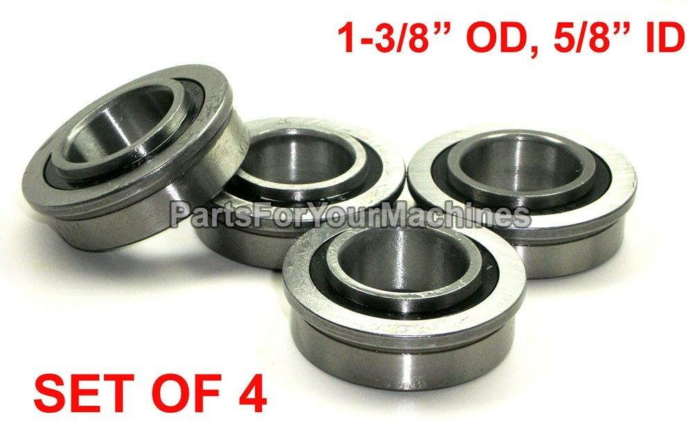

pacer 3,181 #6 Posted August 27, 2019 The sealed ones are plentiful and inexpensive on the bay, either by the piece or in lots. I will do a bit of prowling and usually find/buy a 10 pack. (I like to do this with most of the bearings I buy) https://www.ebay.com/itm/LOT-OF-4-FLANGE-BEARINGS-1-3-8-OD-5-8-ID-GO-KARTS-BUFFERS-CARTS-LAWNMOWERS/280834975724?hash=item416311a7ec:g:EDgAAOSw7NNUHbgo 1 Share this post Link to post Share on other sites

pfrederi 21,274 #8 Posted August 27, 2019 32 minutes ago, pacer said: The sealed ones are plentiful and inexpensive on the bay, either by the piece or in lots. I will do a bit of prowling and usually find/buy a 10 pack. (I like to do this with most of the bearings I buy) https://www.ebay.com/itm/LOT-OF-4-FLANGE-BEARINGS-1-3-8-OD-5-8-ID-GO-KARTS-BUFFERS-CARTS-LAWNMOWERS/280834975724?hash=item416311a7ec:g:EDgAAOSw7NNUHbgo The bearings in the picture are not correct you need 3/4" ID for WH front wheels.... 1 Share this post Link to post Share on other sites
pacer 3,181 #9 Posted August 27, 2019 3 minutes ago, pfrederi said: need 3/4" ID for WH front wheels.... OOOPS!! my bad --- hit the wrong key when I did the search (I guess?) But anyway there are plenty of the 3/4" 1 Share this post Link to post Share on other sites
