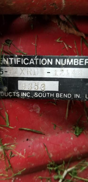

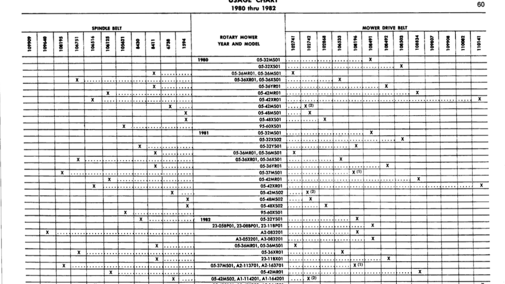

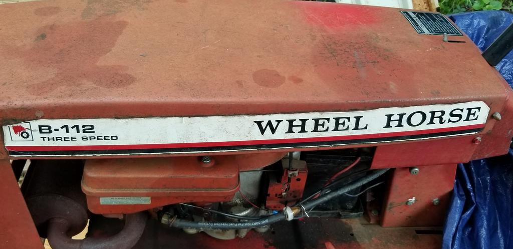

Pitmasterken 4 #1 Posted August 27, 2019 I bought my first wheel horse it's a 80 B112 and I'm having a hard time finding the belt to engage the blades. I know these are great machines my father inlaw had a few before he passed. 4 Share this post Link to post Share on other sites
Burnerman 759 #2 Posted August 27, 2019 Welcome to the forum! Looks like you need a 110141 to drive the deck and a 106516 to drive the spindles. 1 Share this post Link to post Share on other sites
Pitmasterken 4 #7 Posted August 27, 2019 1 hour ago, Burnerman said: Welcome to the forum! Looks like you need a 110141 to drive the deck and a 106516 to drive the spindles. Thank you Share this post Link to post Share on other sites
