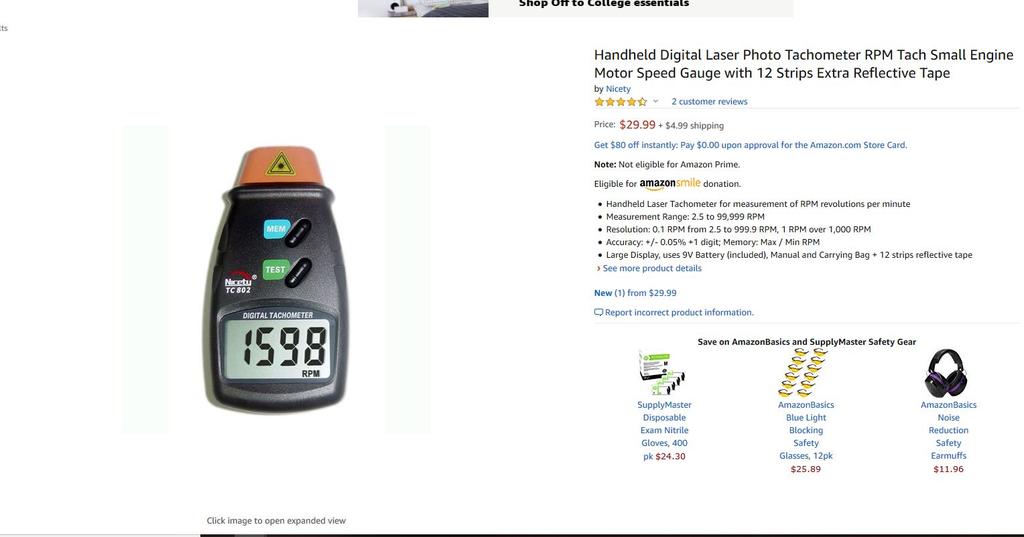

southernPAguy 2 #7 Posted September 2, 2019 Also - Can anyone recommend a Tachometer ? Share this post Link to post Share on other sites
pfrederi 21,300 #8 Posted September 2, 2019 Idle 1200-1250 Full throttle 3600 I bought one like this a few years ago seems to work OK 1 Share this post Link to post Share on other sites
southernPAguy 2 #9 Posted September 2, 2019 Thank you pfrederi, I saw that while looking on amazon. Ill add it to my list and pick it up! Thank you! Share this post Link to post Share on other sites
