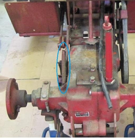

gwest_ca-(File Mod) 12,519 #3 Posted August 25, 2019 108035 clutch spring Garry Share this post Link to post Share on other sites
