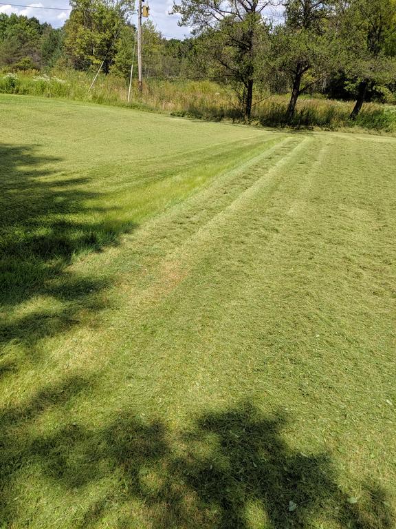

ktowndave 5 #1 Posted August 23, 2019 Having a problem with mowing. For some unknown reason, my deck isn't cutting right. My cutting path is leaving grass up the center. I have brand new blades on it, actually I bought the deck recently and haven't looked to see if the middle blade was put on upside down. Guess I'll have to check it out after while. Would there be another reason for this? It is a side discharge deck, not rear. Share this post Link to post Share on other sites

pacer 3,180 #8 Posted August 23, 2019 1 hour ago, pullstart said: My RD decks have always had a windrow characteristic. The pic DOES indeed look like a RD's discharge..... hmmmmm! But, shur nuff could be blade backwards.... Share this post Link to post Share on other sites
ktowndave 5 #9 Posted August 23, 2019 Well, the blades are on correct, the deck was low so I'm assuming the deck was to low and the grass was to high. 1 Share this post Link to post Share on other sites
ktowndave 5 #10 Posted August 23, 2019 I was high rpm and slow speed. The grass in that area is like cotton candy and the ground stays soggy. I believe my problem could also be that the blades of grass are so full of water that they don't exit the shoot quick enough. The deck is clean underneath and the shoot isn't clogging up. Share this post Link to post Share on other sites
Pullstart 71,369 #11 Posted August 23, 2019 Maybe try to rake the cut grass away, then see how it looks? A yard sweeper works great behind an RD! 1 Share this post Link to post Share on other sites
Lee1977 7,805 #12 Posted August 23, 2019 Check to see if the double pulley is tight. If it is slipping the center blade won't cut. 1 Share this post Link to post Share on other sites
Tractorhead 9,217 #13 Posted August 23, 2019 Even if your Blades are new, are the blades really sharp? i purchased this year also new Blades for my Deck, but they not really Sharp, for my opinion. So i decide, to grinding them with Flex and sandpaper disc, to resharpen them carefully. After fresh sharpened (and i mean really sharp, like a knive) i also be able to cut high grass even my deck was a Mulcher Deck, but i just can cut with low speed forward and high rpm on the deck. If i drive to fast, the Engine pulls strong on Power, what can be heared. Even the cut is nearly accurate, my experiences was as sharp the Blades, as cleaner the Cut. Last week i forgot to resharpen my Blades, the result was also a windowing cut. Another issue can be anybody has changed the mid Spindle with a shorter one. I see such issue at a Fella‘s mower with same result. Share this post Link to post Share on other sites
ktowndave 5 #14 Posted August 23, 2019 I do use a lawn sweeper if the grass clumps up and makes the yard look horrible. I keep the belts tight enough that they don't flop around to much. I didn't sharpen the blades as they are brand new. I do notice that the middle blade is almost a 1/4" lower than the 2 outside blades. Share this post Link to post Share on other sites
