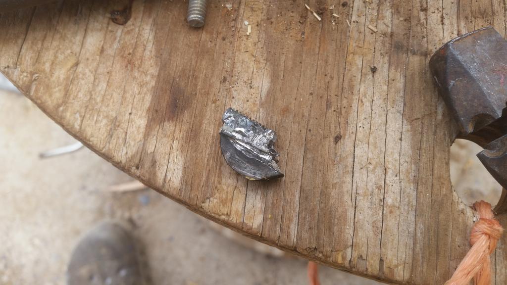

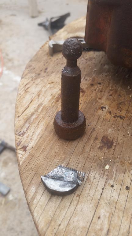

XLT 13 #28 Posted August 24, 2019 Got it. Welded a small bolt on to give me something to grab and/or get a chisel on. 3 1 Share this post Link to post Share on other sites
953 nut 68,789 #29 Posted August 24, 2019 9 minutes ago, XLT said: Welded a small bolt on to give me something to grab and/or get a chisel on. Good technique, will have to add that to our usual list of tricks! 1 Share this post Link to post Share on other sites
ebinmaine 80,456 #30 Posted August 24, 2019 45 minutes ago, XLT said: Welded a small bolt on Well done! Heard of doing that somewhere else too... The heat from welding also can help free up the piece. Share this post Link to post Share on other sites
