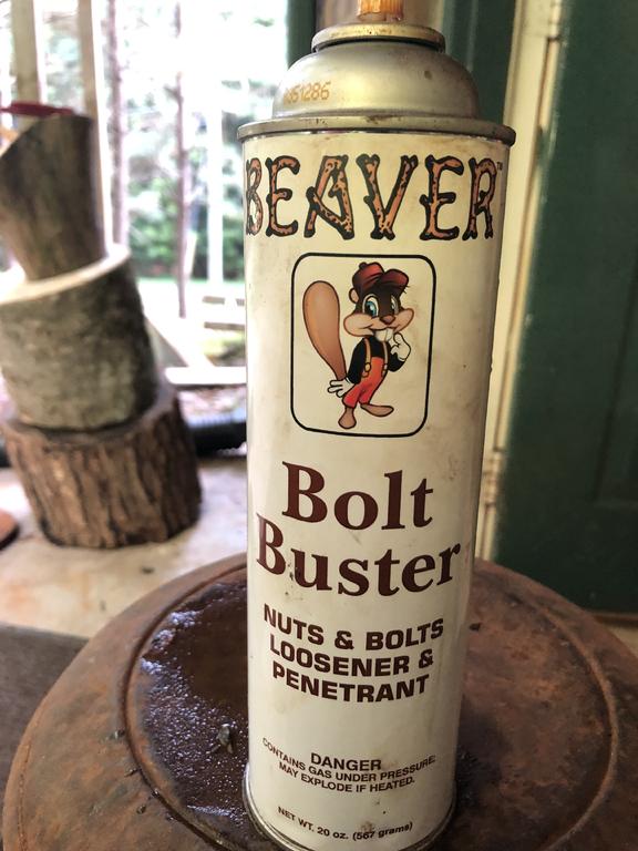

The Tuul Crib 7,354 #10 Posted August 23, 2019 I use a product called nut buster. Its made by beaver products. Works really good for me. 1 Share this post Link to post Share on other sites

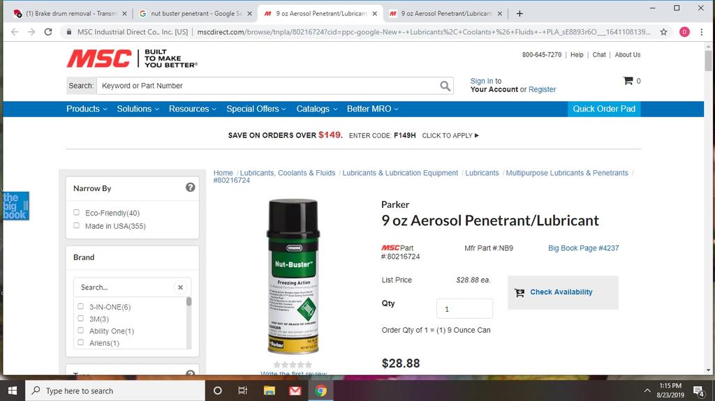

953 nut 68,787 #12 Posted August 23, 2019 1 hour ago, ebinmaine said: Richard likes paraffin wax Mostly for steering wheels, it will run toward the heat when you heat the shaft. 14 minutes ago, The Tool Crib said: nut buster. New to me, I've got a half dozen different brands that have been recomended on here but never heard of "Nut Buster". 8 minutes ago, stevasaurus said: Sounds like you got the drum off, if you are now trying to separate the case halves. Think he is still fighting that and the part of the shift lever that is inside too. Share this post Link to post Share on other sites
953 nut 68,787 #13 Posted August 23, 2019 31 minutes ago, The Tool Crib said: I use a product called nut buster. Its made by beaver products. Works really good for me. For $ 28.88 plus shipping it better take the nut off for you! Share this post Link to post Share on other sites
ebinmaine 80,456 #14 Posted August 23, 2019 1 minute ago, 953 nut said: For $ 28.88 plus shipping it better take the nut off for you! Ouch Share this post Link to post Share on other sites
The Tuul Crib 7,354 #15 Posted August 23, 2019 Thats not the same. Can is different and l payed a whole lot less . Ill take a pic of it when l get home! Share this post Link to post Share on other sites

The Tuul Crib 7,354 #17 Posted August 23, 2019 OK I was a little wrong on that pronunciation of the product it's called bolt buster. Here is a picture of the can . 1 Share this post Link to post Share on other sites
