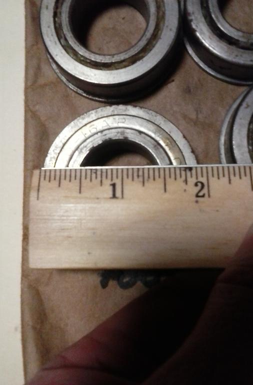

Skipper 1,792 #1 Posted August 22, 2019 Hi guys The flanged ball bearings in the front rim is ID 1" and OD 1-7/8" and is NLA. Part number 104396. I have searched high and low. Cant seem to find any NOS of aftermarket parts to fit. I am not that familiar with where to look in the US after this stuff, so I tried junglesite, fleabay, mc masters and google suggestions. Nada! Can someone give me a helping hand in locating where I could get these bearings. Thanks 1 Share this post Link to post Share on other sites

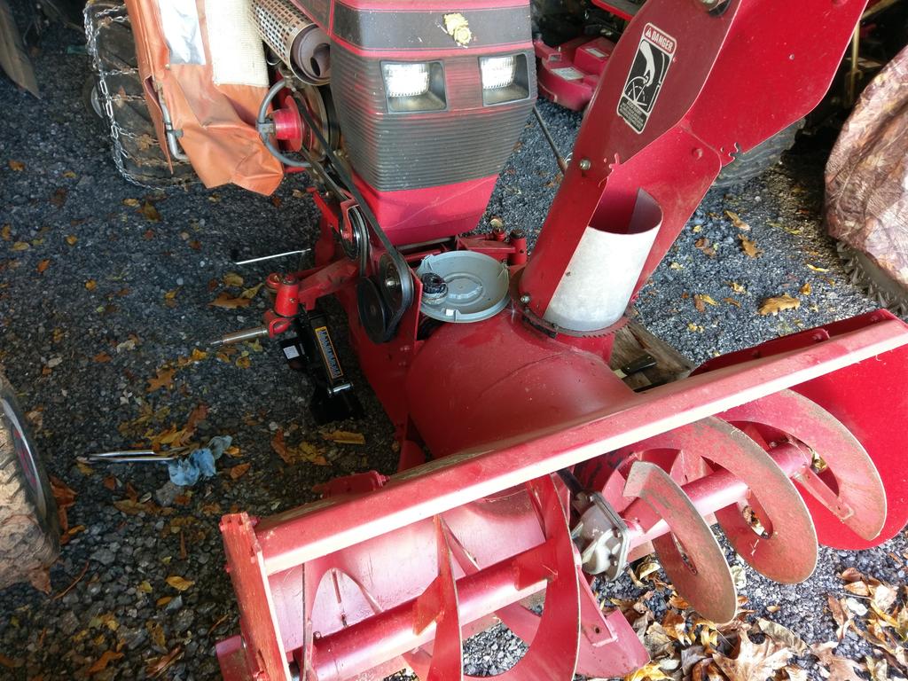

WVHillbilly520H 10,379 #12 Posted August 23, 2019 2 hours ago, Skipper said: How about 520 rims? They might fit, no? 520 rims may fit but you'll need the spindle as well, they have automotive style tapered roller bearings instead of the flanged ball bearings...zoom in on my pic 1 Share this post Link to post Share on other sites
peter lena 10,109 #13 Posted August 23, 2019 noting those reinforced front axle base areas, i would favor the trailer hub conversion , that 2 stage blower needs all the support it can get, pete 1 Share this post Link to post Share on other sites
Lee1977 7,809 #14 Posted August 23, 2019 It's not cheap but they don't ware out. 3500# 5 lug hubs and wheels. I drilled the new spindles and cut off the originals put the over the originals and welded them up. 2 1 Share this post Link to post Share on other sites

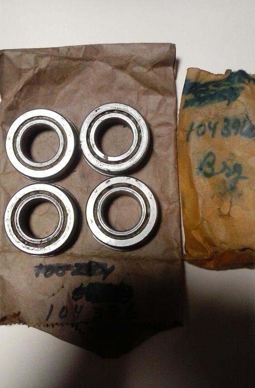

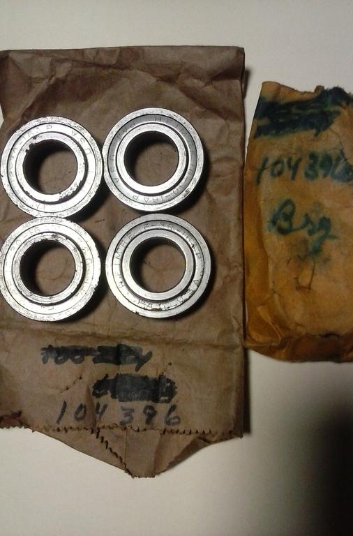

76c12091520h 4,292 #15 Posted August 24, 2019 I have a set of 4, Nos, send me a private message and we'll figure something out. 2 Share this post Link to post Share on other sites
Skipper 1,792 #16 Posted August 24, 2019 message send 2 Share this post Link to post Share on other sites
peter lena 10,109 #17 Posted August 24, 2019 LEE1977, nice change over on that front hub issue, i also like your heim joint steering joints, i have them on most of my working joint areas, steering , clutch linkage rod ends , pto trunion rod end , they are very smooth and rugged , and eliminate the often stiff and binding original set up , nice job, pete Share this post Link to post Share on other sites
peter lena 10,109 #18 Posted August 24, 2019 skipper , i hope this bearing find solves your problem , if you can get some, lucas red and tacky grease , in those bearings your swap will be very good , and very smooth , pete Share this post Link to post Share on other sites
