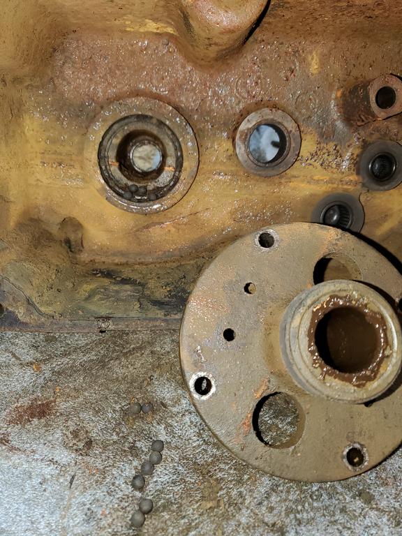

Charley 40 #76 Posted August 23, 2019 can i bead blast the gears? they're pretty rusty. Share this post Link to post Share on other sites
953 nut 66,285 #77 Posted August 23, 2019 47 minutes ago, Charley said: Got'em out, last but not least this guy! I would suggest you not remove the 1533 bearings right away. Clean everything up with mineral spirits to get the old oil film off and some diluted vinegar to get the rust out. Rinse it well with water and then put a few drops of gear oil into the 1533s. If they turn freely you will have saved yourself around $ 150.00. 2 1 Share this post Link to post Share on other sites
953 nut 66,285 #78 Posted August 23, 2019 33 minutes ago, Charley said: can i bead blast the gears? they're pretty rusty. Use the vinegar to remove rust. Share this post Link to post Share on other sites
Charley 40 #79 Posted August 24, 2019 I havent been able to turn the 1533 an inch. I'll get on it with the vinegar and some oil. Thank you 1 Share this post Link to post Share on other sites

WHX?? 56,631 #82 Posted August 24, 2019 (edited) Hello Elliot ...please do follow.. amount of oil is about a quart and a half + or - I fill thru the shifter hole till it just comes out the actual left rear fill hole. Little more is no going to hurt anything. Charlie follow Richard's advice on the bearings. DO NOT try and blast them. If they are are gone they are gone but luckily there are replacements these days. Sounds like the the fellas got you coached properly on the rest of bearings. Good luck The only hard part is cleaning all that old crap off. Just a sample of what I have dealt with ....but here is what I ended up with. Thank you fellas! Edited August 24, 2019 by WHX24 3 1 Share this post Link to post Share on other sites
oliver2-44 11,495 #83 Posted August 24, 2019 (edited) Yes you can glass bead blast the Gears and shafts. I did a rusty Suburban transmission and the glass will not remove metal. Vinegar also works well but don’t use any that is over 4% acetic acid. I use some 9% on some angle iron so was cleaning up and feel it added some pitting. I’ve recently used some Evaporust and really pleased how it worked. It’s a little expensive but a good solution for delicate parts Edited August 25, 2019 by oliver2-44 3 Share this post Link to post Share on other sites
WHX?? 56,631 #84 Posted August 24, 2019 (edited) I'm sorry. .. yes you can blast the gears, and the shafts but be gentle. Ollie knows. BTW Jim I haven't forgot about that crank you need for a 90/91 ......life gets busy! Edited August 24, 2019 by WHX24 1 Share this post Link to post Share on other sites

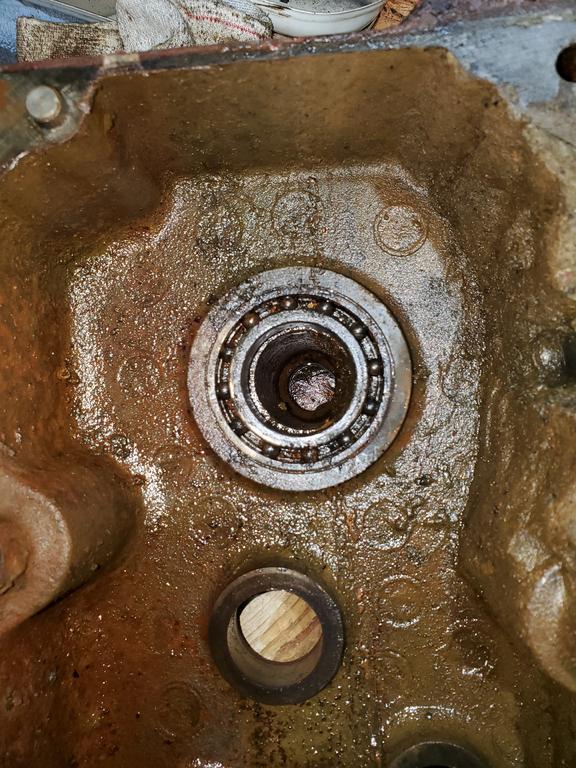

Charley 40 #85 Posted August 24, 2019 11 hours ago, 953 nut said: I would suggest you not remove the 1533 bearings right away. Clean everything up with mineral spirits to get the old oil film off and some diluted vinegar to get the rust out. Rinse it well with water and then put a few drops of gear oil into the 1533s. If they turn freely you will have saved yourself around $ 150.00. Wow I'm really surprised that my 1533 cleaned up and spins free. I honestly wouldn't have even tried, it was locked up pretty tight. Im ready to order a kit. I don't see any difference between kit 1 or kit 2 just a price difference. How do i pick the right one? 1 Share this post Link to post Share on other sites
Charley 40 #86 Posted August 24, 2019 Not so lucky on this one... 1 Share this post Link to post Share on other sites
953 nut 66,285 #87 Posted August 24, 2019 14 minutes ago, Charley said: Not so lucky on this one. PM sent! Share this post Link to post Share on other sites

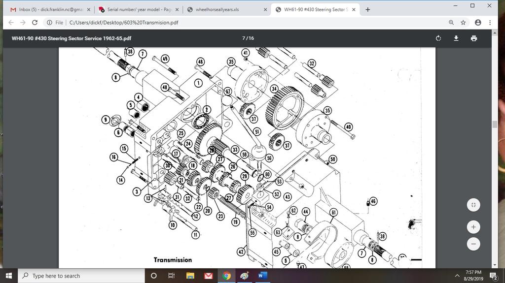

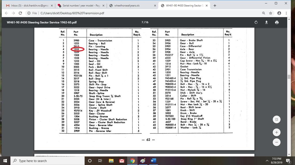

Charley 40 #88 Posted August 29, 2019 how many 1532 bearings do I need I think I need 2 but kit 1 only came with 1. Share this post Link to post Share on other sites
953 nut 66,285 #89 Posted August 30, 2019 1 hour ago, Charley said: how many 1532 bearings do I need I think I need 2 but kit 1 only came with 1. 1532 is a closed end roller bearing that carries the shaft end opposite the break drum. #4 on the drawing. 1 Share this post Link to post Share on other sites
Charley 40 #90 Posted August 30, 2019 (edited) I see it now, I was relying to much on the pictures provided by the forum but its a 5085, its a little different then mine. thank you, Moving forward shes clean and primed slowing getting her back together... Edited August 30, 2019 by Charley 2 1 Share this post Link to post Share on other sites

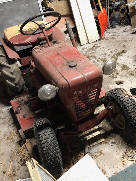

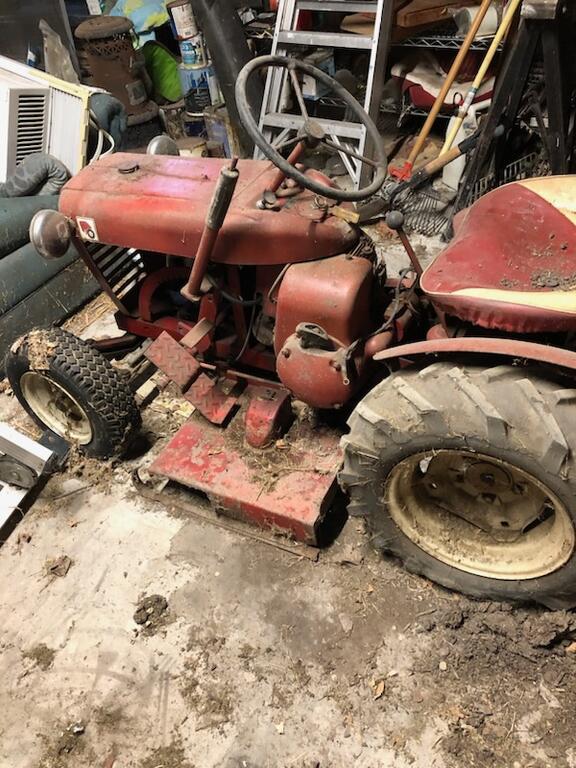

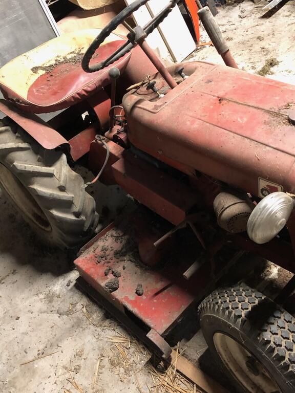

Jason70 0 #91 Posted August 24, 2025 A good friend would like to sell this tractor but I just cannot find what model it would be so she can list it. Anyone know a price Share this post Link to post Share on other sites
953 nut 66,285 #92 Posted August 24, 2025 1 hour ago, Jason70 said: what model it would be That is a 1961 Model 551 Suburban. Is it in good running and driving condition? 2 Share this post Link to post Share on other sites
