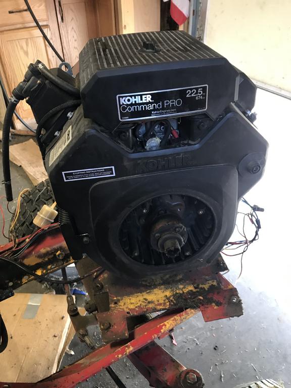

Guest 88vic #1 Posted August 20, 2019 Installing a kohler command twin 18 engine on this 414-8 but the mounting holes dont line up. Has anyone else been down this path before ? What did you guys do to make it right ? Thank you in advance. *Wheel Horse or die fan club* 😎🐎💪🤠 Share this post Link to post Share on other sites
953 nut 63,130 #3 Posted August 20, 2019 With any engine swap your goal should be to have the crank shaft be right where the old one was so the drive system will work properly. 5 Share this post Link to post Share on other sites
ebinmaine 75,840 #4 Posted August 20, 2019 9 hours ago, WHEELHORSEFAN*16 said: Installing a kohler command twin 18 I've read the phrase Kohler Command many times but I'm not familiar with the nomenclature of the different series of twin engines over the years. Is that the same size and shape as the 18 horse Kohler twin that Wheelhorse used in the 418 ? If so, maybe you could have someone take measurements or pictures of their own 418? I'll be following along with great interest to see what you come up with. Please do let me know how you solve this. Over the next few months I'm going to be, hopefully, putting a k23 horse into a C Series chassis. I can't get anywhere near the original line up position as @953 nut Richard suggested above because the Kohler single crankshaft is about 1.5" lower than the twin that I have. I'll have to make up my own belt guard or modify one. 2 Share this post Link to post Share on other sites
