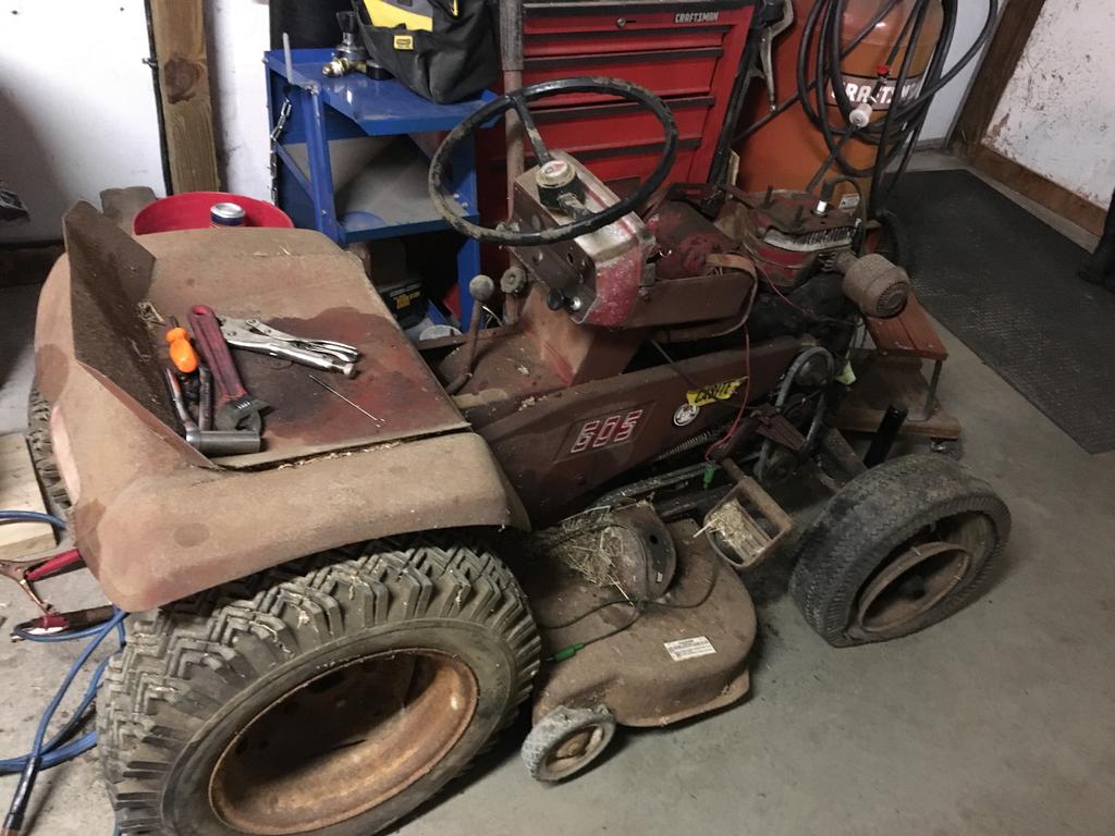

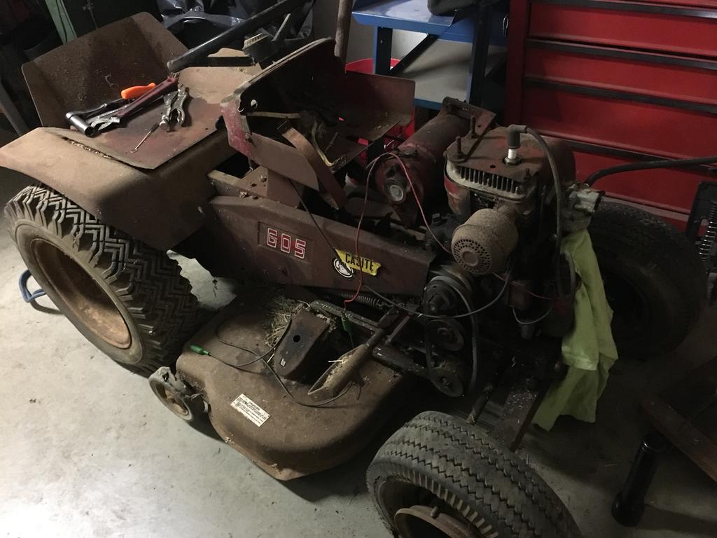

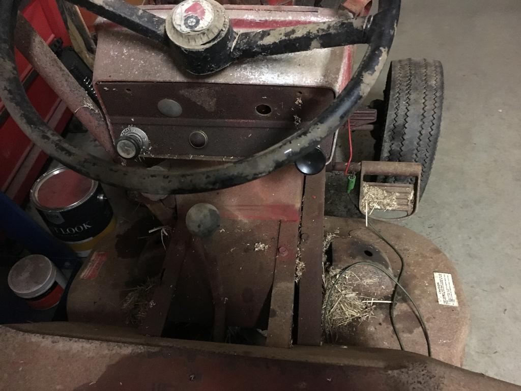

Steph 5 #1 Posted August 19, 2019 (edited) My husband and I recently purchased a Wheelhorse to restore. But, upon getting the tractor home and doing some more research we are unsure if the model stick on the tractor is correct. Unfortunately, the serial number plate is MIA. The stick on the tractor says 605, but it has an electic start. How can we determine what the exact model of the tractor is? We did get the unit running (with my husband's ingenuity) since we are looking for a fuel pump. Any input is greatly appreciated. Thank you in advance!!!! Edited August 20, 2019 by Steph Added pics 5 Share this post Link to post Share on other sites

Steph 5 #7 Posted August 20, 2019 Thank you!! I have added pics above. Share this post Link to post Share on other sites
953 nut 70,346 #8 Posted August 21, 2019 You have a 1965 model 605 according to the belt guard, but a 605 would have come with a Tecumseh 6 HP pull start engine. The engine may have been changed or the belt guard, who knows. There should be a model number plate under the dash board. Take a look to see if it is there. Share this post Link to post Share on other sites

Steph 5 #14 Posted August 22, 2019 I believe the engine information is: Kohler K181S Serial# B223001 Spec# 30108D Share this post Link to post Share on other sites
953 nut 70,346 #15 Posted August 22, 2019 That would be correct for the 1966 model 856. Share this post Link to post Share on other sites
