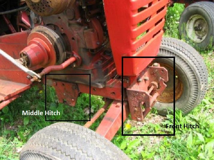

daveoman1966 3,884 #2 Posted August 19, 2019 The Tach-o-Matic or 'quick attach 'system was adopted in 1973. The front mule drive for decks was an integral part of that. Wheelhorse also made an 'adapter' for pre-73 tractors to enable use of the front mule drive, eliminating the cumbersome side-mount belt drive system. Share this post Link to post Share on other sites

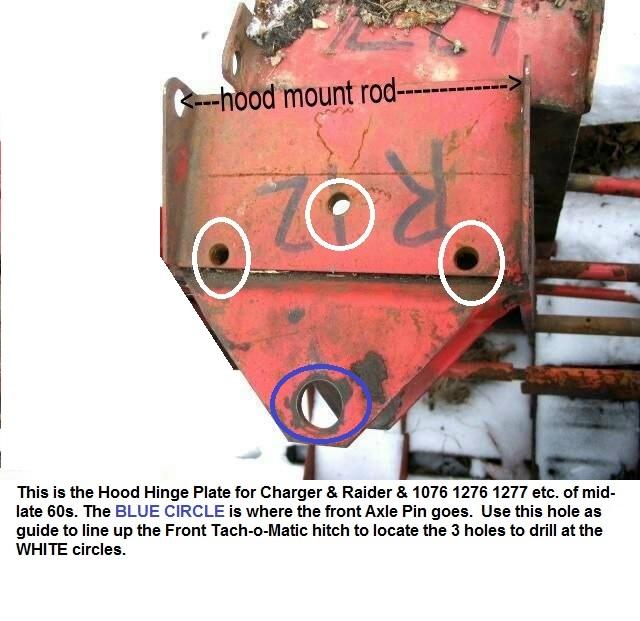

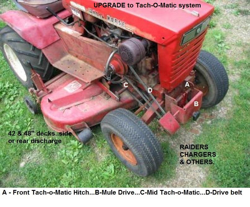

daveoman1966 3,884 #6 Posted August 20, 2019 (edited) As an alternative to the ADAPTER, alll you need do is drill 3 holes in the front of the FRAME, just under the hood hinge.... to accept a Front Tach-o-Matic hitch. But the front hitch for around $20 on Ebay and a Front Mule Drive for $50 or so. The drive belt should for a 42 or 48 side deck would be # 102742 (94-2501). 42" rear dich takes a different belt...not sure of number. This takes about an hour or so to upgrade... NOTE... Use 3 large square nuts (1/2" thick) as spacers between the front hitch and frame plate so that the front hitch is VERTICAL when all mounted. At your discretion, the MIDDLE tach-o-Matich hitch can be swapped out, but not required.. MULE DRIVE UPGRADE DETAIL.docx Edited August 20, 2019 by daveoman1966 Share this post Link to post Share on other sites

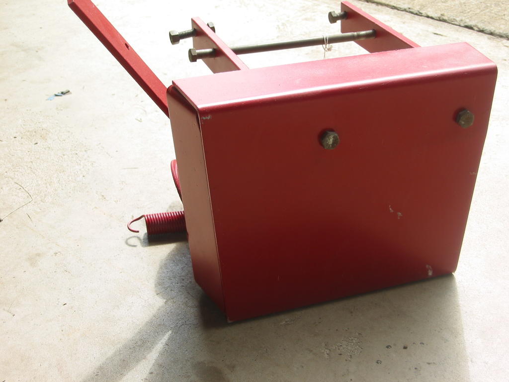

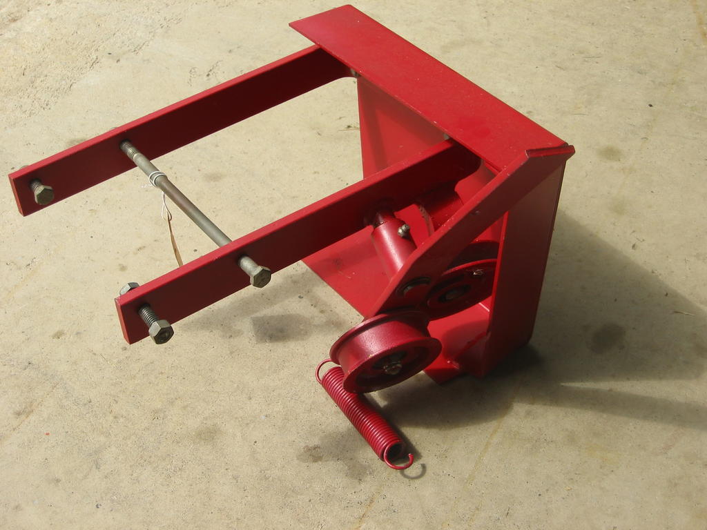

pfrederi 21,225 #9 Posted August 21, 2019 WH had several ideaqs for deck drives. If you do not want to drill holes to put on a front tachmatic and mule drive you could use one like this that was around for a short period with Chargers and Raiders Share this post Link to post Share on other sites
