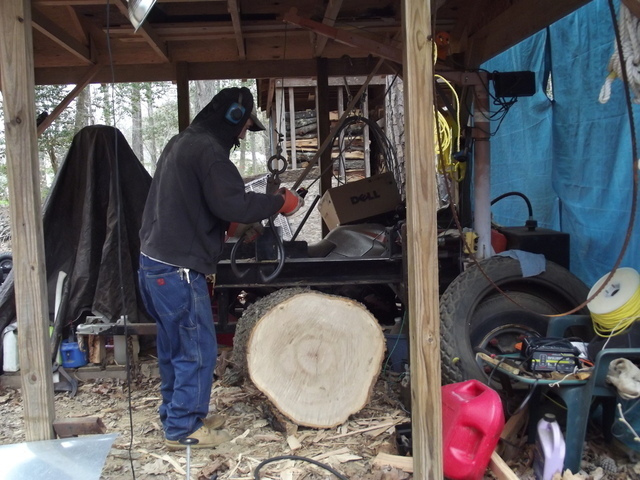

JAinVA 4,638 #5 Posted August 16, 2019 (edited) Though not mounted to a WH one of the guys here put one on the rear of one.The truck crane like wallfish pointed out is mounted to my wood splitter.That Red Oak round is 18" long.Not sure a WH could handle the weight it will lift but it works great.The black box at the right of the mast is the winch controls Edited August 16, 2019 by JAinVA 3 Share this post Link to post Share on other sites
