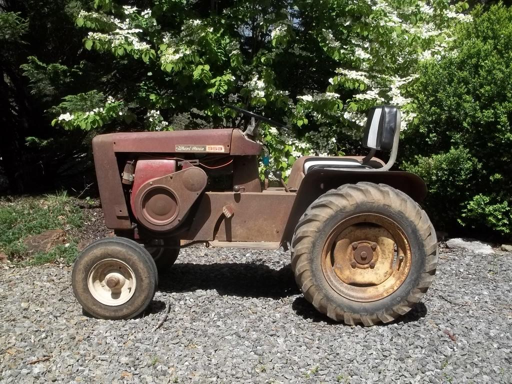

953 nut 69,595 #10 Posted August 16, 2019 You can not use your voltage regulator because the CC K241 has no charging system. The early Wheel Horses had a light on the dash that would glow if the generator was not putting out more voltage than the battery. The Starter/Generator from most other brands that had a Kohler 10 or 12 HP engine will work for you. You can find them on or from used garden tractor suppliers. I would suggest you call Lincoln at A-Z Tractor, he is great. https://a-ztractor.com/. You will also want a belt guard for the S/G belt. Here is a picture of a K 241 with S/G. Share this post Link to post Share on other sites
