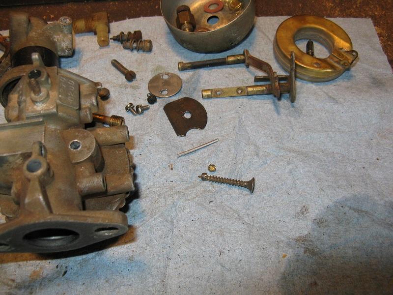

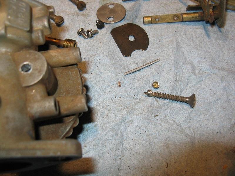

870express 116 #13 Posted August 16, 2019 3 hours ago, VinsRJ said: I think you will find that a Carter N from a Kohler K90-91 will make your Clinton run MUCH better over the original Walbro Thanks. Looks like I am headed in that direction. I disassembled the LMG carb today and have the pieces/parts soaking in carb cleaner. Had some trouble removing the brass plug on top of the idle channel, and ended up putting a hole in it. Will probably use a small piece of brass rod to replace it. If that doesn't work, I'll be in the market for a replacement carb. Share this post Link to post Share on other sites
870express 116 #14 Posted August 16, 2019 (edited) When I start to fix one thing, I usually break two or three more in the process. This is why I am reluctant to work on small engines. One brass plug came out of the Walbro carb easily, but the other one on top of the idle channel was stuck hard. Had to drill a hole in it and use a drywall screw to grab it and pull it out. Not a huge problem, though, I can probably replace it with a small piece of solid brass rod. Everything is soaking in carb cleaner now. Waiting on the rebuild kit. We'll see . . . stay tuned. Edited August 16, 2019 by 870express Share this post Link to post Share on other sites

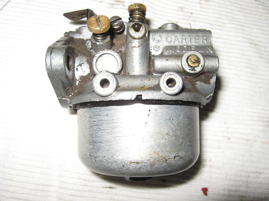

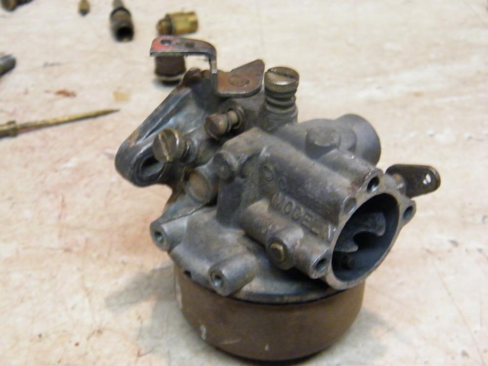

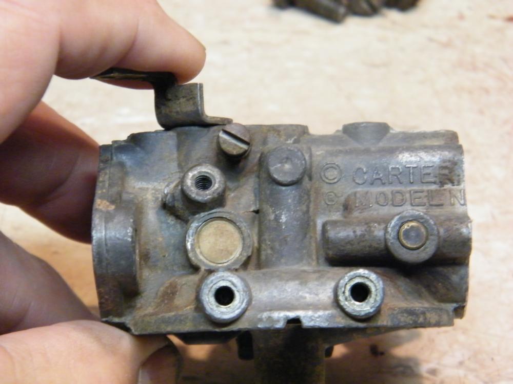

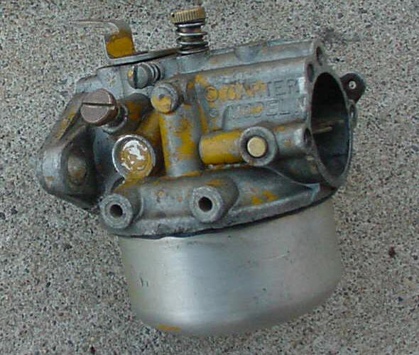

870express 116 #15 Posted August 21, 2019 On 8/16/2019 at 9:05 AM, VinsRJ said: I think you will find that a Carter N from a Kohler K90-91 will make your Clinton run MUCH better over the original Walbro Status: The Walbro rebuild was a bust. My ham-handed attempt resulted in stripped threads in the bottom post where the bowl/main jet screw attaches. Not repairable. (Note to self: I have got to stop over-tightening stuff.) So I am now in the market for another carb. Does anyone have a Carter model N to replace my Walbro LMG117? It goes on a Clinton B1290-1107, RJ-58/59. I posted an ad in classified/wanted. One response so far, turned out to be the wrong carb for my Clinton engine. I assume the following photos show the correct Carter model N configuration. Correct? Share this post Link to post Share on other sites
AMC RULES 37,259 #16 Posted August 22, 2019 Have you tried an Ebay search? Share this post Link to post Share on other sites
870express 116 #17 Posted August 22, 2019 4 minutes ago, AMC RULES said: Have you tried an Ebay search? Yes. Identified several good possibilities. But I need to confirm that the photos above show the correct configuration. Photos are all I have to compare. The Ebay listings don't state that those carbs are suitable for a Clinton B1290. 1 Share this post Link to post Share on other sites
AMC RULES 37,259 #18 Posted August 22, 2019 Looks good to me...pretty sure that's the one you need. Will get you some picts up here later on today, this afternoon. Share this post Link to post Share on other sites
