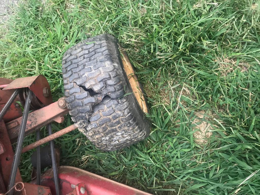

base459 4 #1 Posted August 13, 2019 Hello all, I am still pretty new here, but hope I can find some help. I went to mow my lawn this weekend and came to find the my front left tire had blow out somehow. I tried to figure out how to get the wheel off so I can replace it myself but it was beyond me to figure it out by just staring at it. Does anyone have instructions, videos, or diagrams on how to remove and re-attach the front wheels? Share this post Link to post Share on other sites

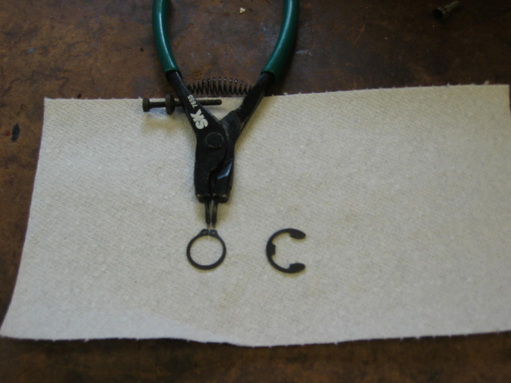

pfrederi 21,308 #5 Posted August 13, 2019 E clips you use a screw driver to pry it off. External snap ring you use snap ring pliers. Share this post Link to post Share on other sites

pfrederi 21,308 #8 Posted August 13, 2019 Snap ring and pliers and Eclip 1 1 1 Share this post Link to post Share on other sites

Pullstart 71,520 #15 Posted August 14, 2019 @base459! We never joke around here... nope. If you have a floor jack and block up the tractor, it might be advantageous to change a tire while the wheel is still attached to the spindle. A couple big flat head screw drivers will help, if you have a big enough c-clamp to pop the tire off the bead of the wheel. 1 Share this post Link to post Share on other sites

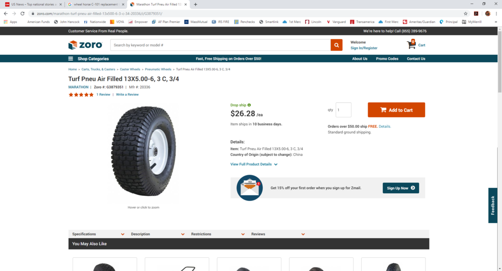

base459 4 #18 Posted August 14, 2019 The more im thinking about it i would leave it on and remove the tire and replace, however, i did just find this online. Not sure if this is the right size or not. Very curious what others say as well! Share this post Link to post Share on other sites

pfrederi 21,308 #20 Posted August 14, 2019 (edited) 13 minutes ago, base459 said: The more im thinking about it i would leave it on and remove the tire and replace, however, i did just find this online. Not sure if this is the right size or not. Very curious what others say as well! I doubt that is the correct size. What model tractor do you have and what size is on there now??? Edit: Just reread your OP you have 8" wheels on a c101 Second edit. if you r tires are original you need 16 6.50 x 8 Edited August 14, 2019 by pfrederi Share this post Link to post Share on other sites
870express 116 #21 Posted August 14, 2019 (edited) You can search this web site to find the correct tire size for your tractor. And make sure you select the tire only, not tire and wheel. https://www.globalindustrial.com/p/material-handling/casters/wheels/16-x-650-8-turf-rider-tire?infoParam.campaignId=T9F&gclid=EAIaIQobChMI-pSwk8KC5AIVQV8NCh0BcgCzEAQYBCABEgK5mvD_BwE Edited August 14, 2019 by 870express 1 Share this post Link to post Share on other sites
