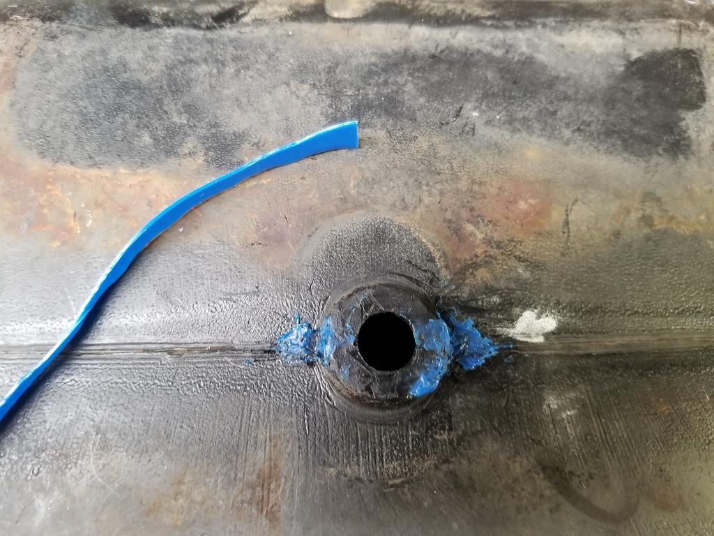

TDF5G 2,074 #30 Posted March 18, 2020 (edited) Here is a useless update: (Some of y'all probably think I'm some kinda loser because it takes me forever to fix my horses.) But f you are like me, you like to know how a project or repair turns out for folks. I obtained one of these plastic welding tips that fits my soldering iron. I'm intending to cut up an empty motor oil bottle made of HDPE to use as welding rod. I hope to give this a go this weekend. I appreciate all the help and advice. I will follow up with my results, eventually. Todd Edited March 18, 2020 by TDF5G 1 Share this post Link to post Share on other sites

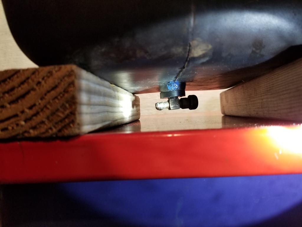

TDF5G 2,074 #32 Posted March 25, 2020 (edited) Well it was a success. I got time to work on it this past Sunday afternoon. I leak tested it before installation. There is gas in it in that pic with the shut off valve installed. The oil bottle I had was blue. It's not pretty but it worked. I used a small pointed tip to make a groove in the seam first then filled it with the plastic using the triangular tip which worked well but I think I a little hotter iron would work better. The plastic rod seemed to want to stick to it. Thanks again for all the help and advice. Case closed. On to the next project. Todd Edited March 25, 2020 by TDF5G 2 2 Share this post Link to post Share on other sites
